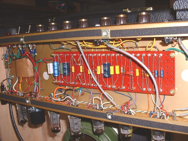

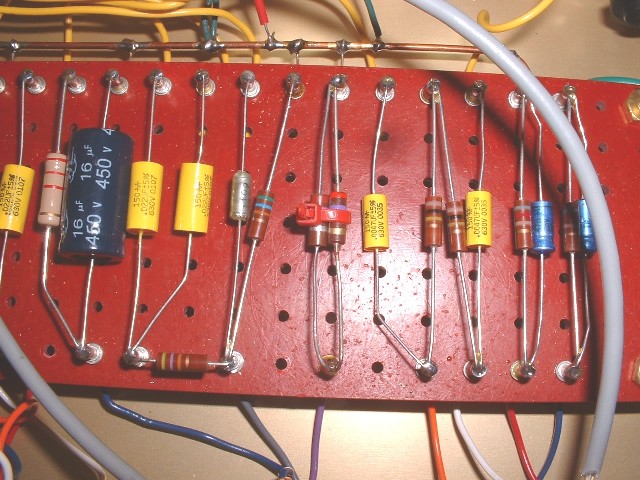

PostPosted: Thu Aug 11, 2005 9:54 pm
MooreCowbelle wrote:
Was the amp that Ibet played through built with a buss or a star? MAN that sounds good. Any chassis pics? Amp porn?
sIII NO. 2 COMBO CHASSIS
sIII No. 2 BOARD VIEW
sIII No. 2 OPTIONAL GAIN RESISTORS TIED TOGETHER
REMOVE ONE FOR MORE GAIN
sIII No.2 COMBO OPEN BACK
sIII No.2 COMBO BUILD
PostPosted: Fri Aug 12, 2005 4:00 pm
Joined: Wed Aug 10, 2005 4:20 pm
coco (and everyone else involved) -- nice work!
A couple of questions:
- Any particular reason why the gain resistors are zip-tied together?
- The layout indicates linear pots for Mid and Treb, but the schematic specifies Log/Audio. Which is it?
- is that buss grounded on the right?
PostPosted: Fri Aug 12, 2005 7:40 pm
A. Only to elimainate any rattle. In this case, only if the customer chooses to leave them in. If one is removed (cut out), the gain drops
A. Good catch! I missed that one. Linear for Mid and Treb.
A. Yes.
I'll update the schematic. Thanks!
