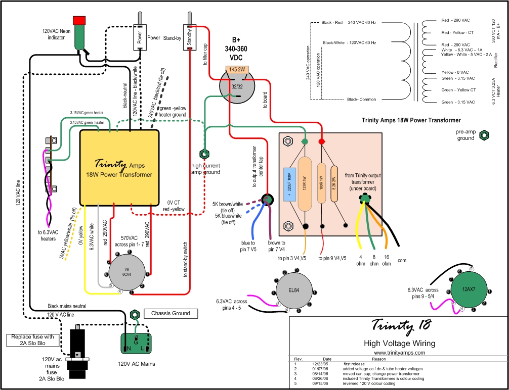

Hi Coco,
Quick question on the mains wiring, and the VRM Installion Layout. Is black main neutral attached to the fuse? Or just direct from main to neon indicator?
Thanks,
Mark
Mark
PostPosted: Mon Jun 16, 2008 9:34 pm
Black is attached to Neutral direct to indicator.

Thanks Coco, that what I thought, but better safe then sorry :)
