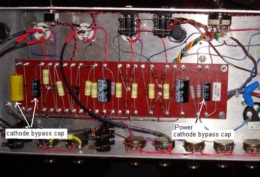

soooo, havent installed my vrm yet, still trying to figure out what caps to replace with the ones i ordered to tame the boominess of the bass....totaly lost in all those drawing of tubes and circuitry...i may write like i know english pretty good but when it comes to parts involving lethal doses of volts i tend to be very cautious... so ive been looking at the documentation that came with the amp and the web and after like 3 hours and a great headhache(again) cant still figure out wich caps to replace with the 25uf.... i know, it sound dumb, but again, im new to it and its like learning another langage.
....actually, the more i think about it the more dumb i think it sound(and my head hurts more and more...)
so can someone point me to where on the layout the cathode bypass cap(s) are :oops:
i wonder how it worked on first fire anyways, think next time ill concentrate only on the woodwork as i cant seem to get the idea behind grids, plates and all that crazy stuff that i dont know and dont want to mess up :cry:
actually, i think im more afraid to mess it up since it is working and sounding good(less the bass boom or flabbyness) :lol:
PostPosted: Sun Aug 24, 2008 3:40 pm
In your plexi there are two preamp bypass caps and one power amp bypass cap. Replace the 220 uF power one with the 25 uF

thank you much coco, i was totaly lost there, but i think i could have swap any of the 2 220uf/50v caps and came with similar results....maybe not :?

The plexi has a 220 on the preamp as well. If you want to tighten up just the normal channel, just do that one. If you want to affect bothj channels, do the power bypass cap.

what can i do to tighten only the tmb channel ?

You can try the crunch munch for the 18 and see. Same as in the 15. For the pot, as long as you still get almost full B+ with it, it should be OK. At the lower B+ it's not as noticeable.

just completed instalation of the vrm and changed cathode cap(power) and it seems to do as said, cant test max volume for boominess as i only got a mesa oversized recto with v-30 in in for right now, ill let you know how it goes when i get to jamspace and try it on my cabs.
