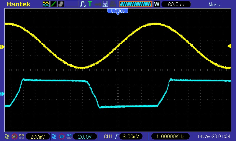

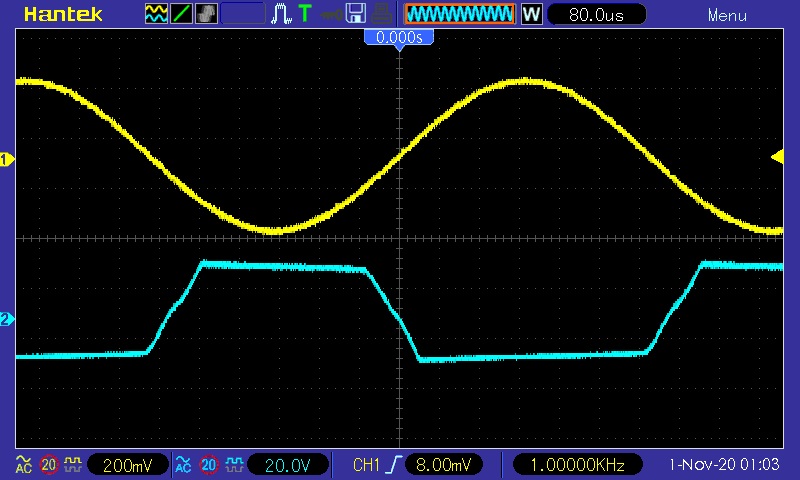

PostPosted: Sun Nov 01, 2020 12:26 pm
Posts: 31
I implemented the Ruby mod, which nearly removed all of the crossover distortion. Because the highest cathode voltage I had recorded was about 25.5 VDC, I went with a 3 diode array: 20V and 6.5V zener in series (both 5 Watt) and back to back with a 1n4007. That was connected in parallel with each 220K grid leak resistor with the 1n4007 side going to ground. Some pics of both channels on my scope. This was the most prevalent I could make the crossover distortion with a SS rectifier. It is even less apparent with the 5AR4. Sounds much better now.
