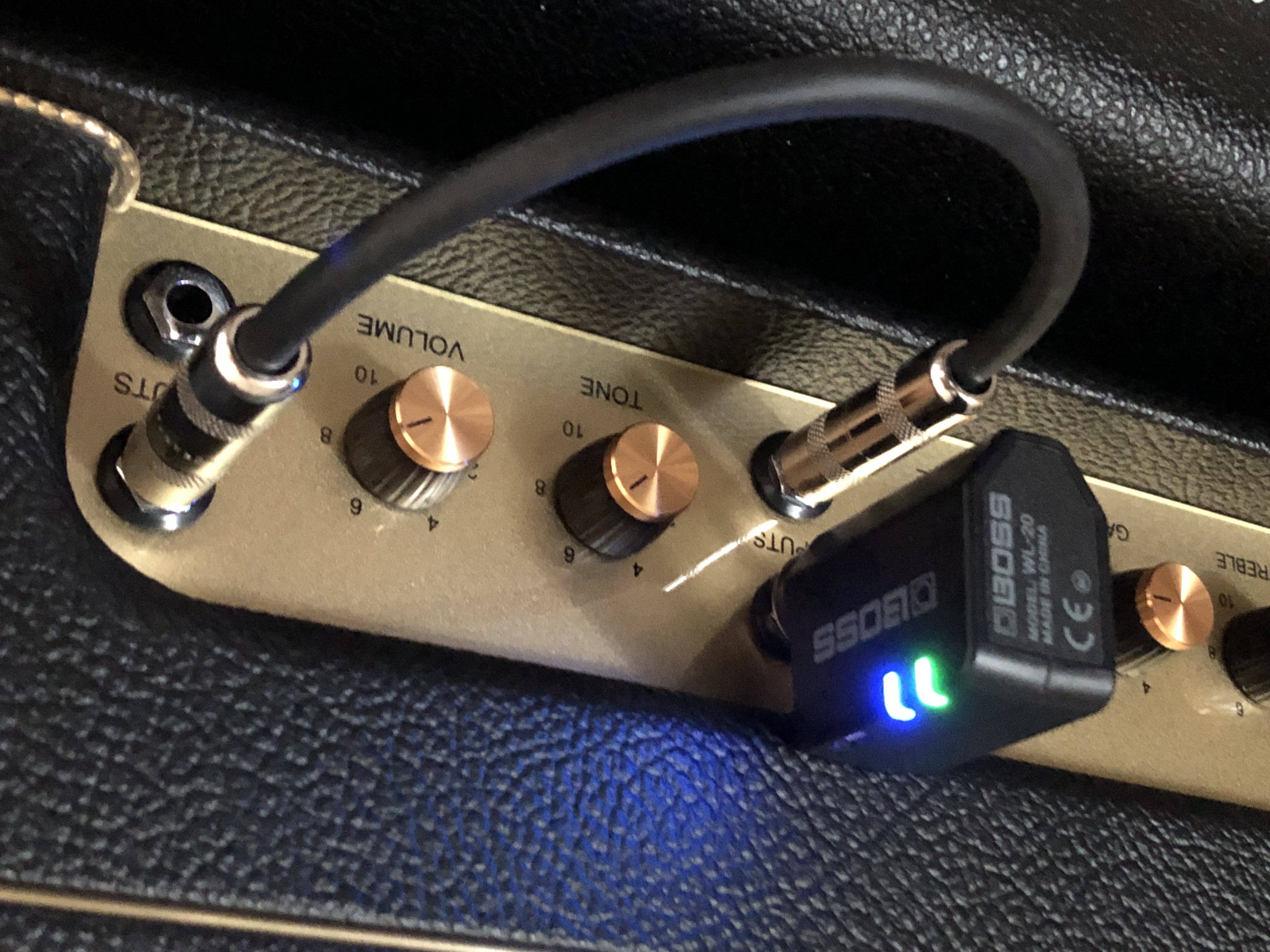

I solved my feedback issue. I bought a Boss WL-20 wireless system. I can crank the amp and by keeping some distance the feedback is gone. I literally have to stand 3 feet from the amp to bring on the feedback now. As a side note, I highly recommend the Boss wireless. No latency, crystal clear sound and no loss of tone. The range is more than enough and the freedom to wander around while playing is great. Yes, a longer lead would have accomplished the same thing but this is more fun.

That's cool. Expensive?

Expensive? Yes and no. Cheap for a wireless system and considering what people pay for stomp boxes, etc it’s reasonably priced. But compared to a $50 cable? Yes, expensive.
