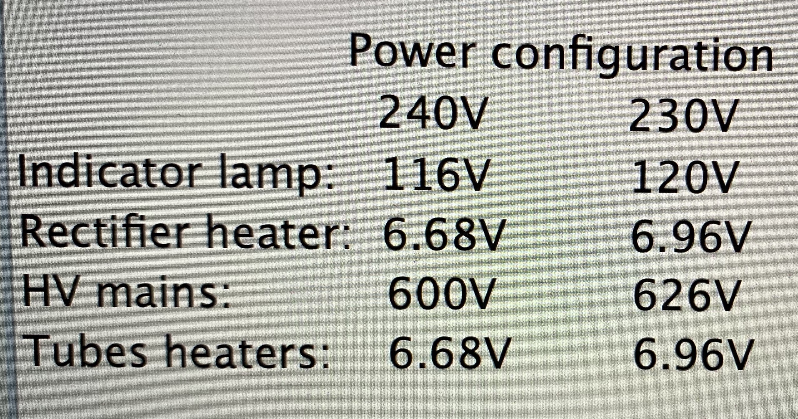

Wired PT for both 240 & 230 V to test which way better voltages will be achieved. Here are the results with 233V Mains Voltage with NO LOAD
What do you think which result is better for operation under load?

The 230-volt readings look reasonable. You should check again once the tubes are installed to see which tap gets the heater voltages closest to 5 for the rectifier and 6.3 for the rest.
Thank you Mitch!
But are you sure about 5V for the rectifier heater? Manual says 6.3V also
PostPosted: Tue Oct 15, 2019 8:59 pm
You are right. EZ81 needs 6.3 volts on the heater. I was thinking of GZ34 or 5AR4. I should have looked at the schematic!
