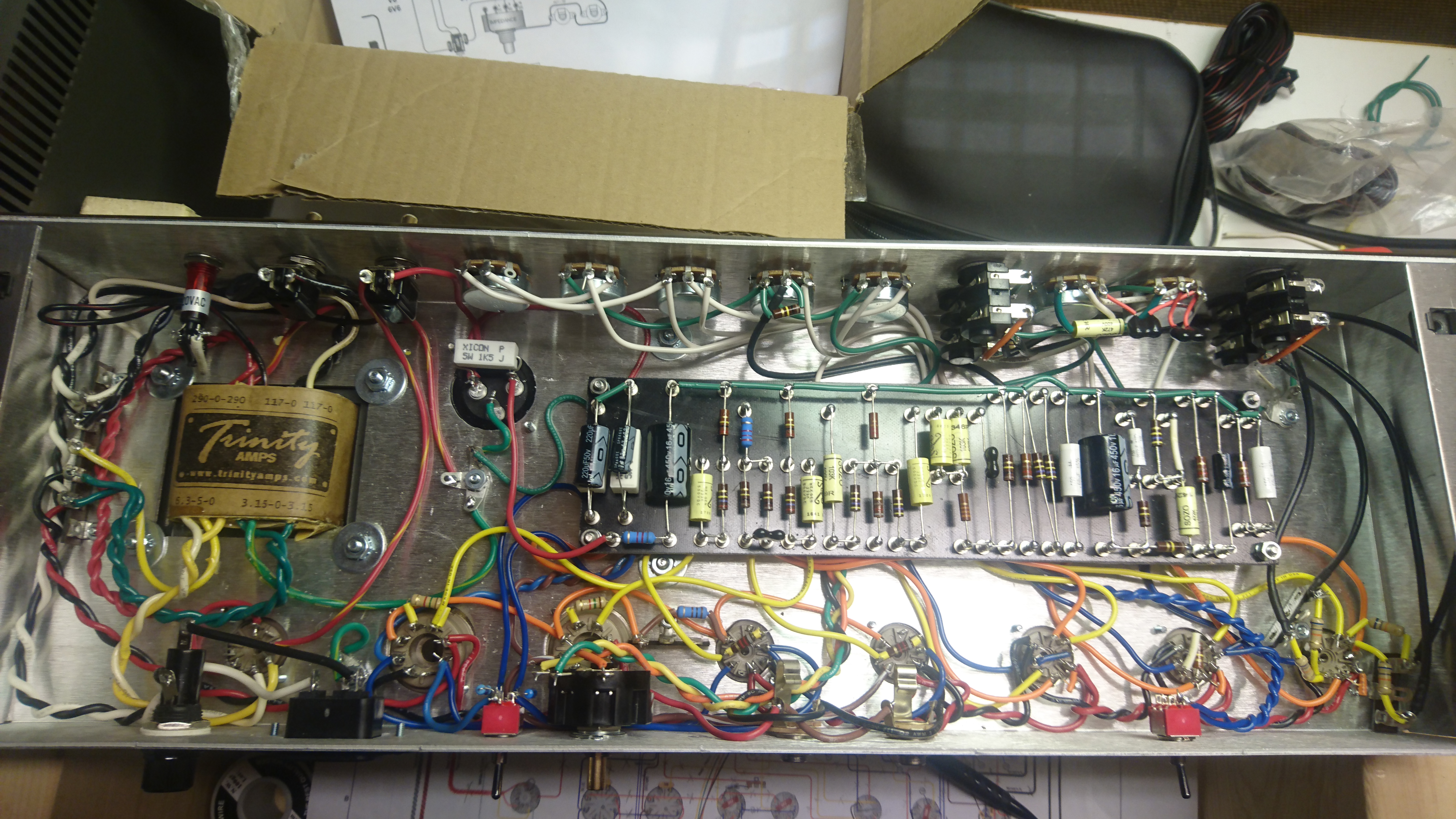

I have finished my build, my first attempt to build anything electrical.
Everything seems ok, no red plating, no noice/crackles(both channels are quiet).

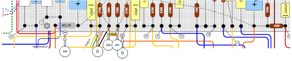

Why am I getting Zero voltage on (see the picture on layout and picture on my build)?
Since I'm novice , I have a lot to learn, where do I start to trouble shoot?
From what I can tell I have made the correct connections to the turret board, checked connectivity.
But the reading is off.
File comment: Voltage related to layout

File comment: My build
PostPosted: Mon Aug 28, 2017 12:28 pm
Hi, welcome to the forum.
Your build looks good. Don't worry too much if some voltages are off. Typically voltages vary by 10 to 15% in tube circuits.

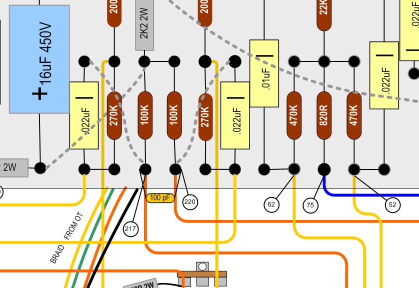

The voltages at the cathodes of V3 are low, though. Check R12. It should be 22k (red red orange). Can't tell if the third band is orange or brown in your photo.
I would expect to see 0 volts at the turrets you indicated on the layout drawing. Those points are after the coupling capacitors C8 and C9. The job of those capacitors is to block DC coming out of V3 and only pass the AC audio signals on to the grids of the output tubes.
I don't know why the drawing shows those points to be 217 and 220 volts. Those labels should point to the two 100K resistors that feed power to V3. You show around 204 volts there which is fine.

Good catch on the voltages. mitch is correct and though our drawings had been updated but not distributed on paper.
there can be minor differences in the voltages posted and that doesn't make a lot of difference as long as you like the sound!!
you've done a good job building the amp, congratulations.
