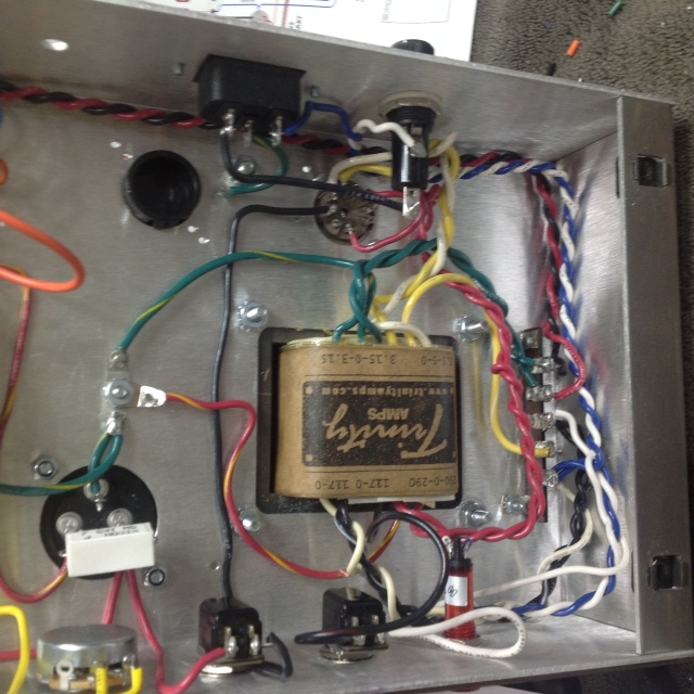

PostPosted: Sat Mar 12, 2016 10:50 am
Probably something else
Post some pictures
PostPosted: Sun Mar 13, 2016 2:38 am
Joined: Wed Feb 03, 2016 3:22 pm
Posts: 21
Wiring is per instructions for 240v. Wire for on/off switch left a bit long as VRM is yet to be installed.
