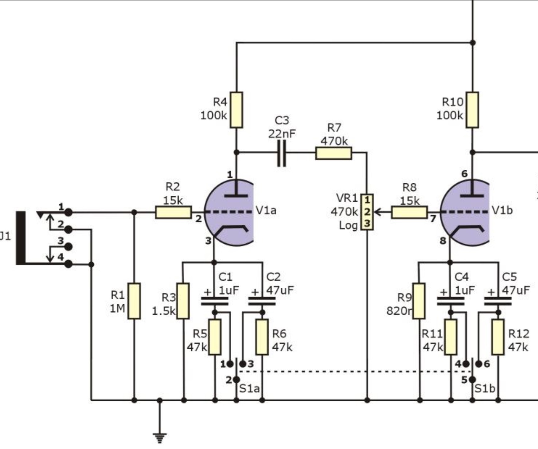

Hello,
I'm new to this forum.
I'm modifying my 18w combo that I built years ago. I'm turning it into a plexi style 18w (based on Richard Johnson schematic). Regarding all the mods in these pages, I have a question about the "clean boost switch". Can this switch be installed on the front panel? I mean, is there any advice about how to wire it (twisted wire, shielded wire?) in order to avoid any hum?
thanks,
rgds,
Ed

Take look at mapmaker's n5x schematic and layout for front switching. You can do it with or without the charge resistors. no pop or with pop when flicked.

Rhos os the referred to schematic. Let us know how it works for you.

just a question about the RX5,
the charge resistors are R5 and R6 here?
thanks,
 Post subject: Re: Plexi Brown Mods
PostPosted: Sun Aug 02, 2015 10:56 pm
thanks,
Yes

Hello,
sorry for this noob question but there is something i don't understand in NX5 schematic. :oops:
The boost is actually a cap (.68uF) in parallel with the 2k7 resistor, isn't it?
So, according to the schematic, applied to an on/off switch or two position, if we consider C2 (.68uF), in series with R6 resistor (47K) :
1)right position : R6 is shunt and ground is directly linked to C2. That's the boost position.
2)off position (we don't want the effect of the cap) : R6 will be at the ground, but the cap is still in series. So does it mean that this R6 resistor cancels the effect of the cap by discharging it? it would end with 2 resistors (2k7 and 47k in //, so more or less 2k5)
thanks,
rgds
PostPosted: Mon Aug 03, 2015 4:34 pm
cap's pass ac but block dc
So with the 47k in series with the cap you just have the 2k7 resistor and because the potentional voltage at the cathode of the tube is positive compared to ground the cap gets a positive charge
With the 47k bypassed the cap has a path to ground and can boost the higher frequency . with the nx5 the other cap 47uf will also boost lower frequencys i.e. fat

Hello,
thanks for these technical informations.
I've found this site that explains this :
http://sound.westhost.com/valves/bias-gain.html
But i don't know if by using Rcathode = 2.7k in // with (0.68uF in series with 47k), i will have the same gain (specially when switch is off) as found on Stephen's schematic/layout...
rgds,
