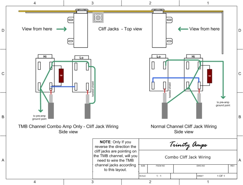

I would like to get some opinions on how I correct some of my mistakes. First, the Normal Channel low input sounds absolutely fantastic! Second, that's the only input I am getting any signal from. I have gone over the layout over and over again and cannot figure it out. Everything seems to be wired right except for the Plexi TMB inputs being upside down. Any help would be much appreciated! Here are a few pics.... I know its messy even for a first timer but the second will be better! Thanks again!
PostPosted: Mon Mar 02, 2009 8:10 am
I'll try to take a look at these. Did you wire the jacks this way?

Oh crap I feel stupid :lol: I guess I didn't read the instructions well enough. Looks like I will have to go find some more shielded wire! Thanks coco!
