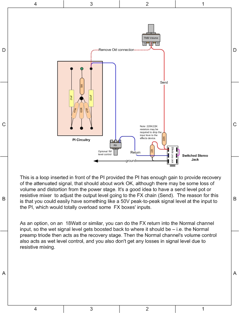

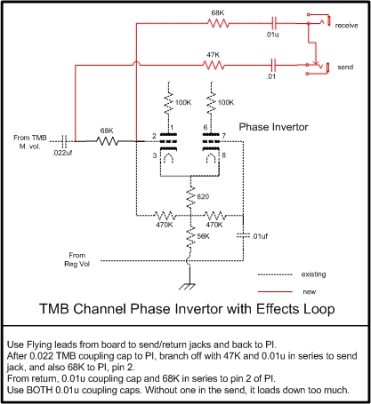

PostPosted: Sun Oct 05, 2008 7:58 pm
Simple Matchless Style Effect Loop
Another Simple Variant
