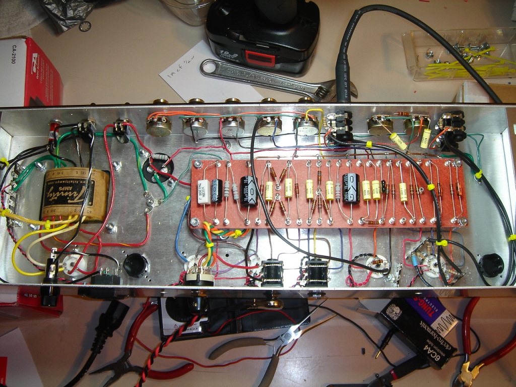

Hi my first build (newbie) :roll:
lots of humming with cable (1/4" instrument no guitar) in
none removed
not much gain more of a good crunch and muddy and or sloppy at high volumes
would appreciate any thoughts and or tips
thanks in advance

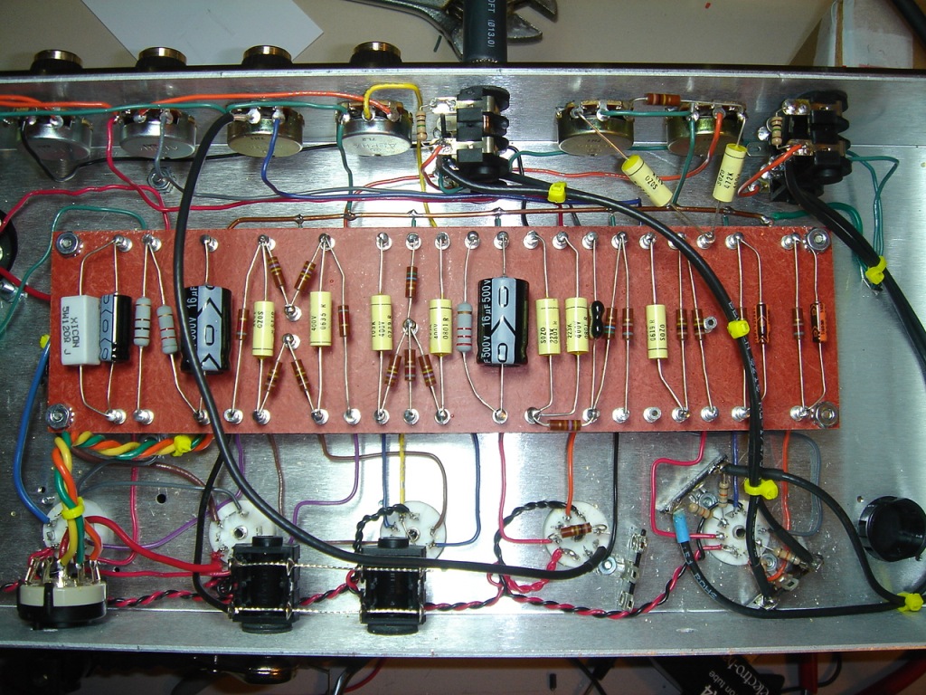

Is C2 tied to the tag board mounting bolt? It looks like the other side of C2 could potentially hit the mounting bolt on that side as well. Which layout did you build to?

must be optical illusion C2 not tied to bolts on either side
Using the layout sent with kit Rev 4 dated 1-8-08
