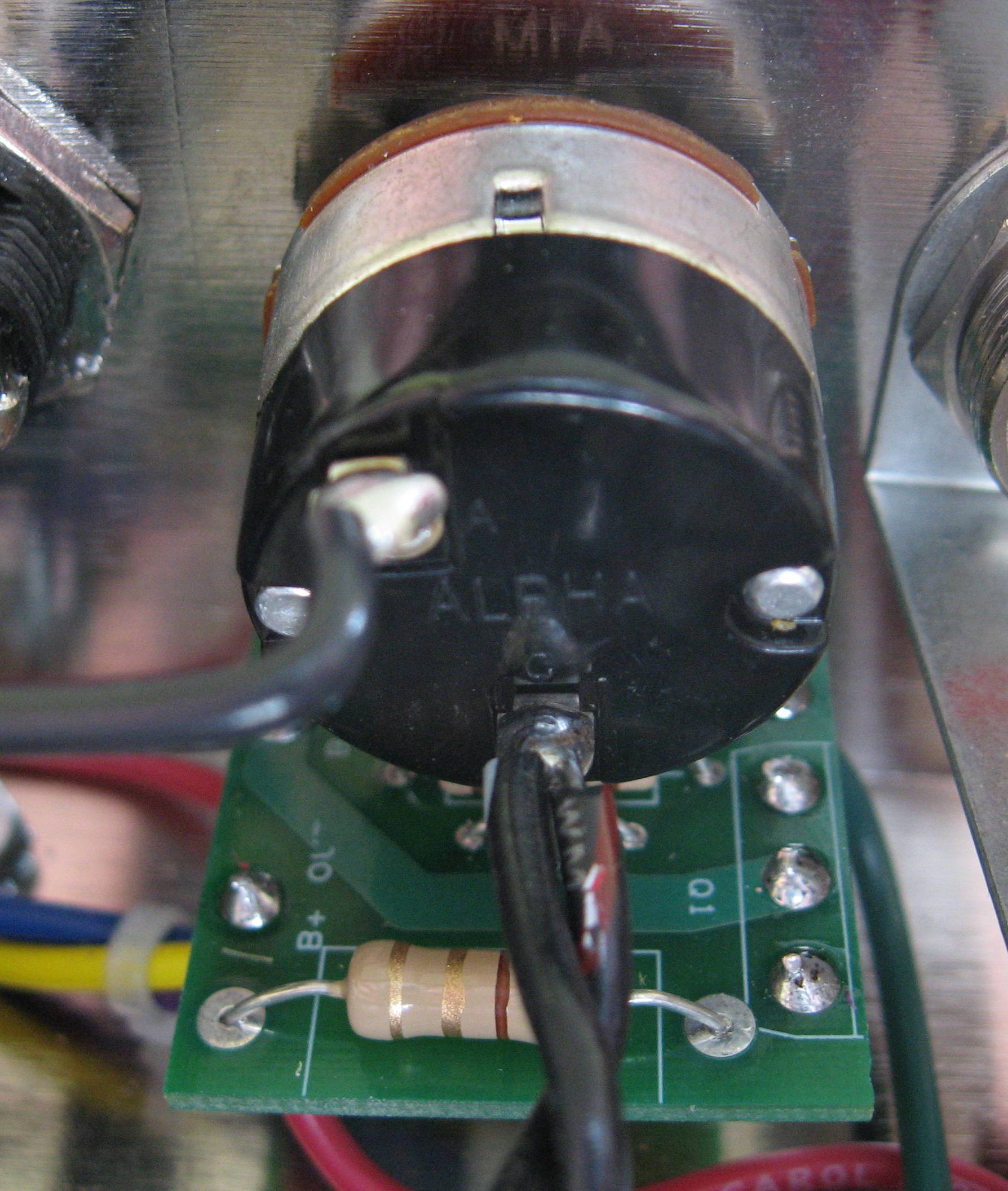

VRM is our "Voltage Regulation Module" kit based on the VVR design but modified to minimize voltage drop. Technically it is simply a variable B+ voltage control.
It is designed to reduce the power level of your amp while retaining the sound. Essentially, you get very close to the same sound at a lower volume. The tiny board size means silent operation and should fit anywhere in your Trinity Amp.
Specs:
Board size approx 1.25" sq.
B+ Voltage drop 2.7V @ 100 ma
Current limited at 230ma
7A MOSFET device mounted on PCB or remote
Simple connections required - B+ line in, B+ line out, ground.
Replace the power switch in your amp with the "switched" control pot VRM kit for $40 plus $8 shipping in North America and $15 shipped elsewhere. . Kit include all parts: PCB, 1M switched control pot/knob and 2 DC blocking caps to be used on the first tube grids. Make a few connections and you're ready to go.
More application info here: http://www.trinityamps.com/phpbb/viewtopic.php?t=1176

However, I went on a similar journey a couple of years ago, after building a 5E3 from a Marsh kit. Out of the box, it was louder than expected, and without the early breakup it was supposed to have.
I eventually had to face facts- the kit's Mojo PT had way too much output. B+ readings with the stock circuitry and a Sovtek rectifier were around 425-430V. As I discovered, there's only so much you can do with rectifier swaps and rebiasing. After I got down to about 370V, anything I did to drive the B+ lower, just made the amp sound worse.
In order to get the B+ below 350V with normal component values, I eventually bought a Mission PT. The amp now works the way it's supposed to, and has become my desert island amp.
I'd still like a low-power switch, though, and the VRM looks interesting. But based on past experiments, I wouldn't have expected a 1V change to make much difference in output.
Is that all the voltage reduction the VRM produces, or does the B+ continue to drop as you rotate the knob?
The VRM drops a few volts from B+ when it's set to Max. Some designes were dropping 10 -20 Volts which wasnt acceptable.
As you rotate the control knob, the B+ continues to drop to below 100V [this is adjustable BTW] so you have complete control of the B+ from max B+ in you amp to a minimum that you can actually set.
It works very well.

I fired it up for the first time last night, and it's working a treat in my 5E3.
Even at high levels of voltage reduction, I couldn't detect a noticeable difference in the operating temperature of the amp.
At small to medium levels of reduction, the tone change was much less than I've experienced with power soaks or master volume controls. Being able to dial in a specific amount of reduction makes more sense to me than using a "half-power" switch.
Although the tonal side-effects were more noticeable at higher reduction levels, slight adjustments of the single tone control on the 5E3 were all it took to make the results quite useable. More than useable, in fact- some of the low-level tones are downright addictive.
My expectations were fairly high going in, yet I still got more out of this mod than I was hoping for...

I installed one of these in my Trinity Deluxe yesterday and I can vouch that it does a fantastic job of lowering the volume while retaining the tone. Best $35 you can spend on an amp mod. There is very little heat produced; even at maximum B+ reduction. My favorite setting right now is with the knob at about 12 o'clock; the tone is still there while the volume is knocked down to home use levels.

Hi, I have one if these left over from a build i did a while ago. I'd like to add it to a JTM45 that I've since built. Will it be able to handle the extra power of the JTM45?
PostPosted: Fri Oct 16, 2015 8:58 am
The VRM will not work ona fixed bias amp. It is for Cathodebias only, up to 40W
