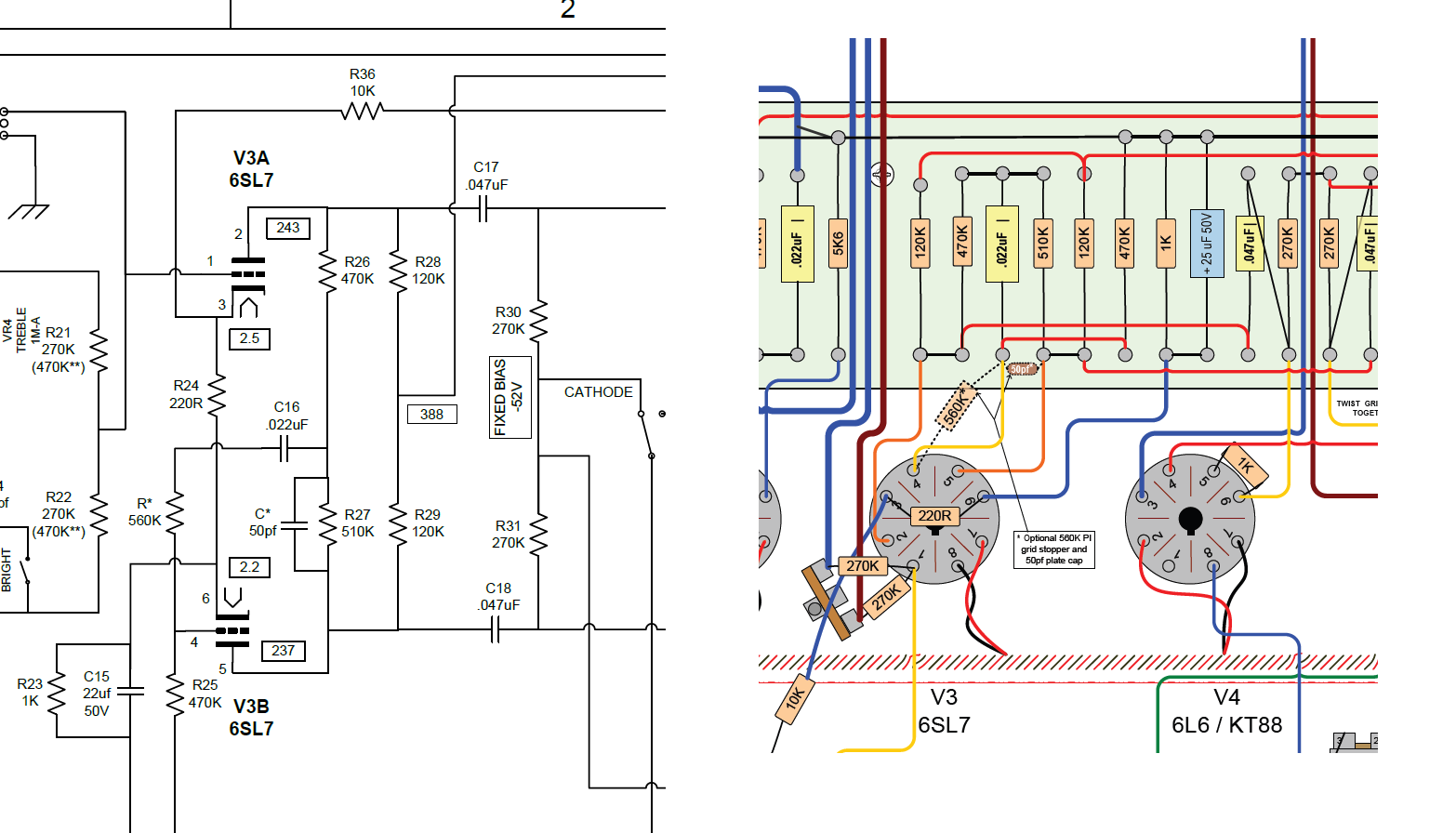

Since I havn't got any reply, neither from this forum and from Trinity Amps, I just want to share what I self discovered from my problem with V3/PIN 5.
Easy answer, the 6SL7 V3 was faulty. I tried to swap it with V2 and suddenly every measurement where fine on V3 but not on the V2. So I just ordered a new 6SL7 and everything is fine!
But something is wrong either in the schematic or in the layout regarding the optimal grid stopper and cap. (I did remove both of them, since I dont have any oscillation).
But the schematic and layout doesn't match.
I used the latest schematic (REV 21) and layout (REV26)
Look at V3, PIN4 and the resistor* and the 50pF Cap*
Something needs to be corrected...
For now I can't recommend anyone to install the grid stopper/cap
Hopefully this will help anyone that are having the same problem!
