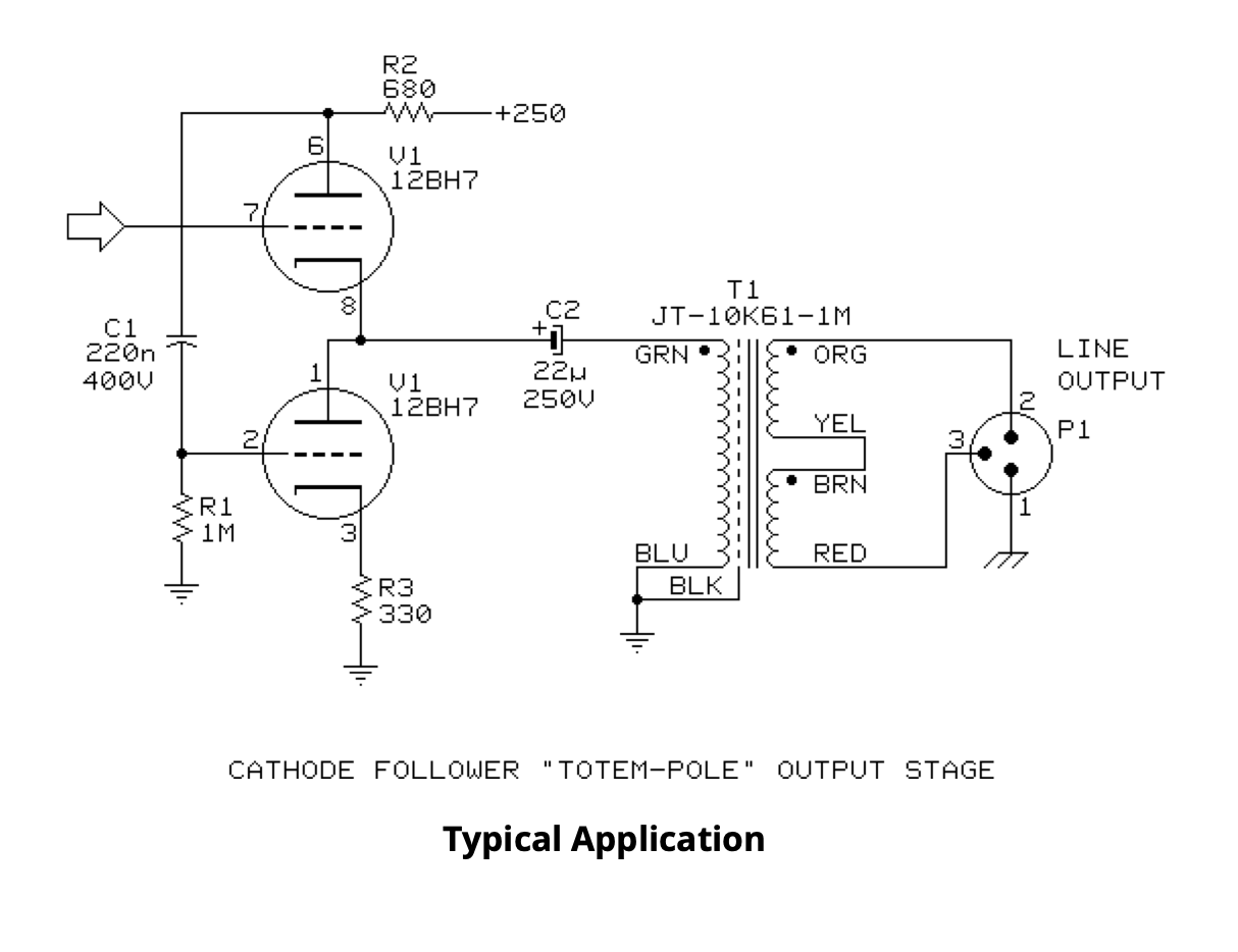

this is what I was thinking:
https://www.jensen-transformers.com/wp- ... k61-1m.pdf
or otherwise building in something so that there is a balanced line out on the back of the chassis.

Complicated to add two tubes to accomplish this. Should be able to do it passively like this .
You would need to add a voltage divider in front to reduce the signal.

I was under the impression that the feed for the jensen could have been obtained from splitting the feed from the existing power tubes. is that not possible?
 Post subject: Re: balanced output
PostPosted: Sun Dec 06, 2020 7:19 pm
I dont think so. The power tubes need to work into the proper OT impedance. The Jensen would change that.
