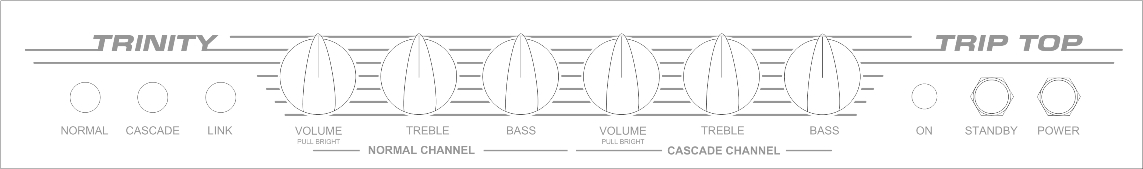

This is the artwork for the Trip Top front panel
Front Panel
 Post subject: Re: Trip Top Front Panel
PostPosted: Thu Feb 05, 2015 5:53 pm
Looks great! :thumbsup:
PostPosted: Fri Feb 06, 2015 10:21 am
Still wondering about the labelling. of the power switch.
Old B15 had standby switch on rear of chassis.
PostPosted: Fri Feb 06, 2015 11:31 pm
My B18 project has three switches side by side that balances the inputs, standby, ground and power, no switches on the back panel so looks like there were variations.
PostPosted: Fri Feb 06, 2015 11:59 pm
I guess something like that would work in this case too.
PostPosted: Sat Feb 07, 2015 12:12 am
Yep, the three input, six knob, three switch layout does give a symmetrical look. :thumbsup:
I can take a picture if you want.
Back panel has the fuse holder, extension amp, extension speaker and a hum control

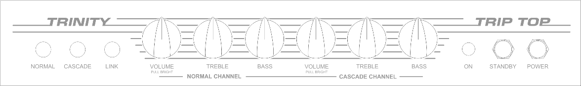

This is the artwork for a two power switch scheme.
Any comments??
NEW Trip Top front panel
OLD Trip Top front panel
PostPosted: Sun Feb 08, 2015 3:08 pm
Like it :thumbsup:
Looks more balanced to me :D
PostPosted: Sun Feb 08, 2015 3:38 pm
Yes, certainly more balanced. Looking for some more input.
PostPosted: Sun Feb 08, 2015 10:07 pm
More symmetric, I like it.
Probably easier to wire, the progressive switch can be confusing to wire.
PostPosted: Sun Feb 08, 2015 10:37 pm
Another good point.
PostPosted: Wed Feb 11, 2015 8:18 pm
This is the artwork for the NEW two power switch front panel.
PostPosted: Thu Feb 19, 2015 9:15 pm
Small edit on the new design to angle off left & right side lines.
