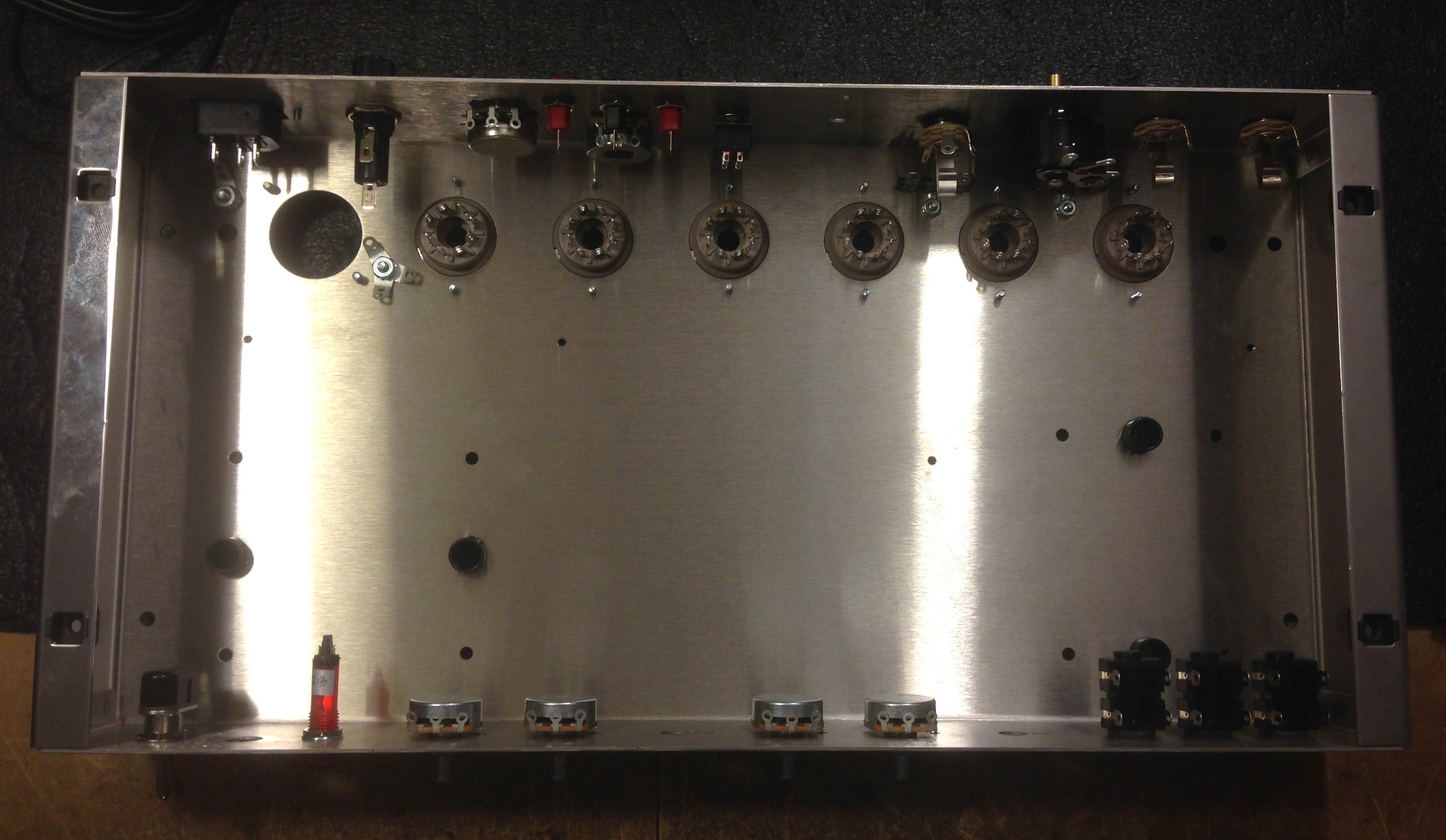

PostPosted: Sat Apr 25, 2015 8:51 am

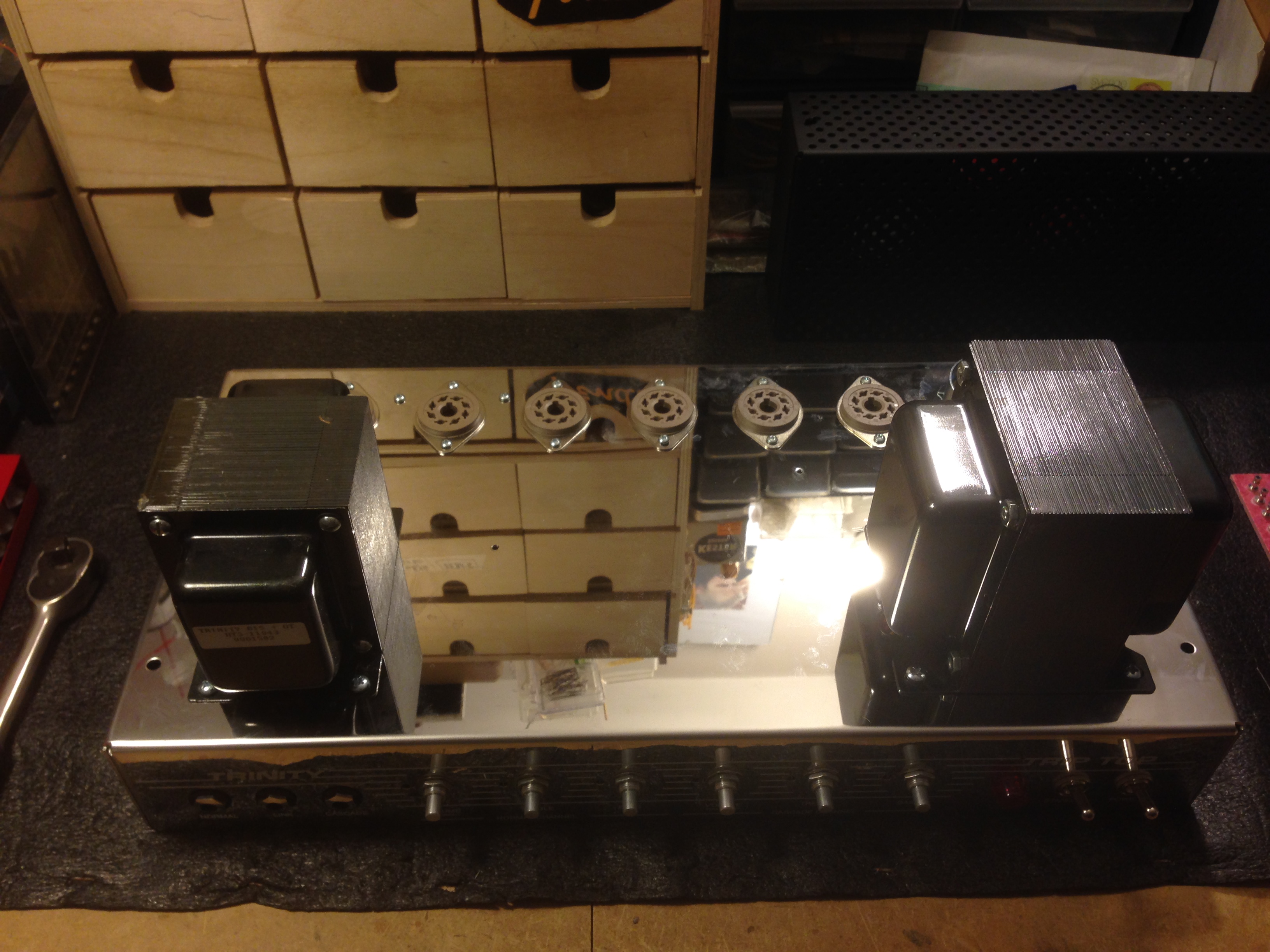

Day 1 - Kit Arrives. Inventory done. Hardware and Transformers installed.

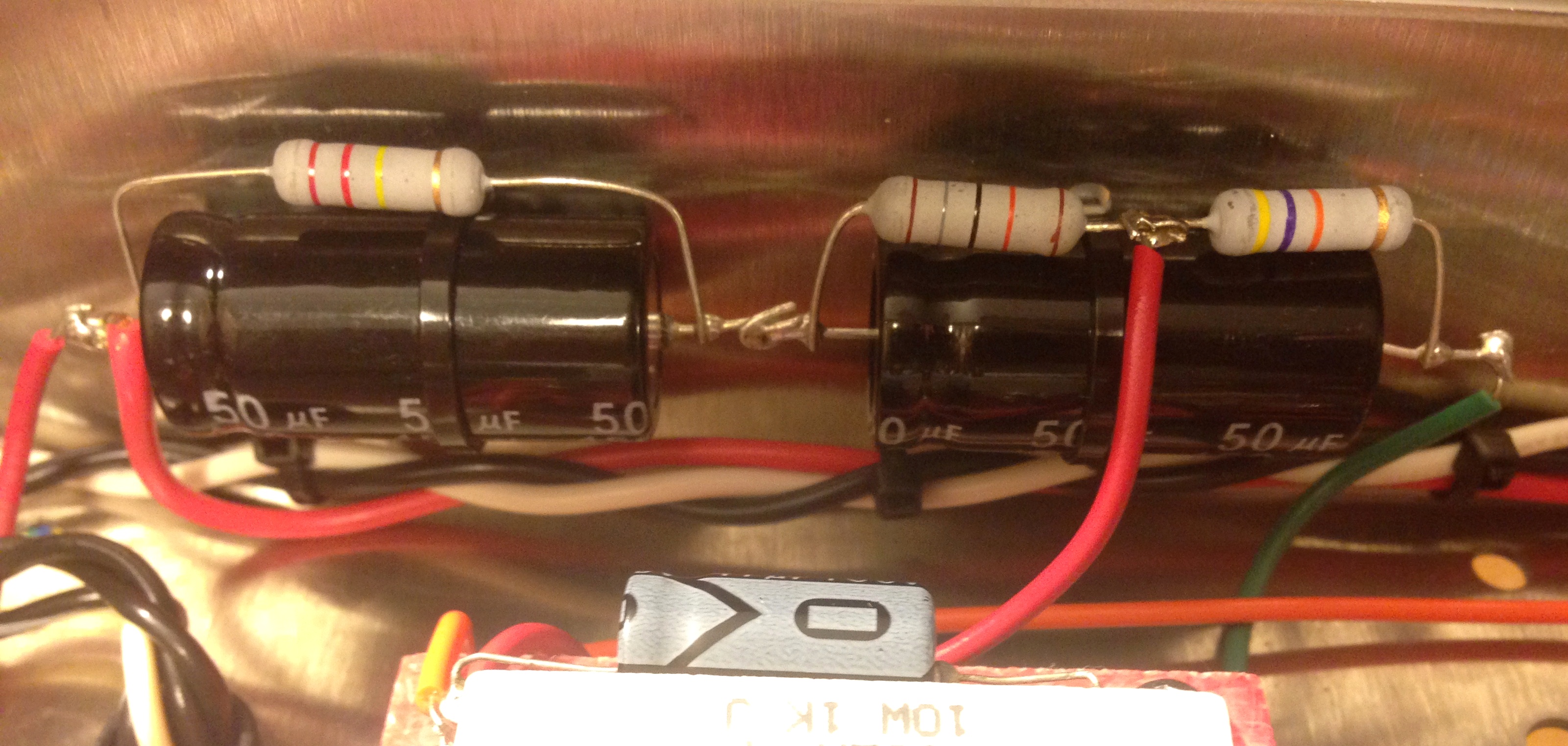

PostPosted: Sat Apr 25, 2015 9:12 am

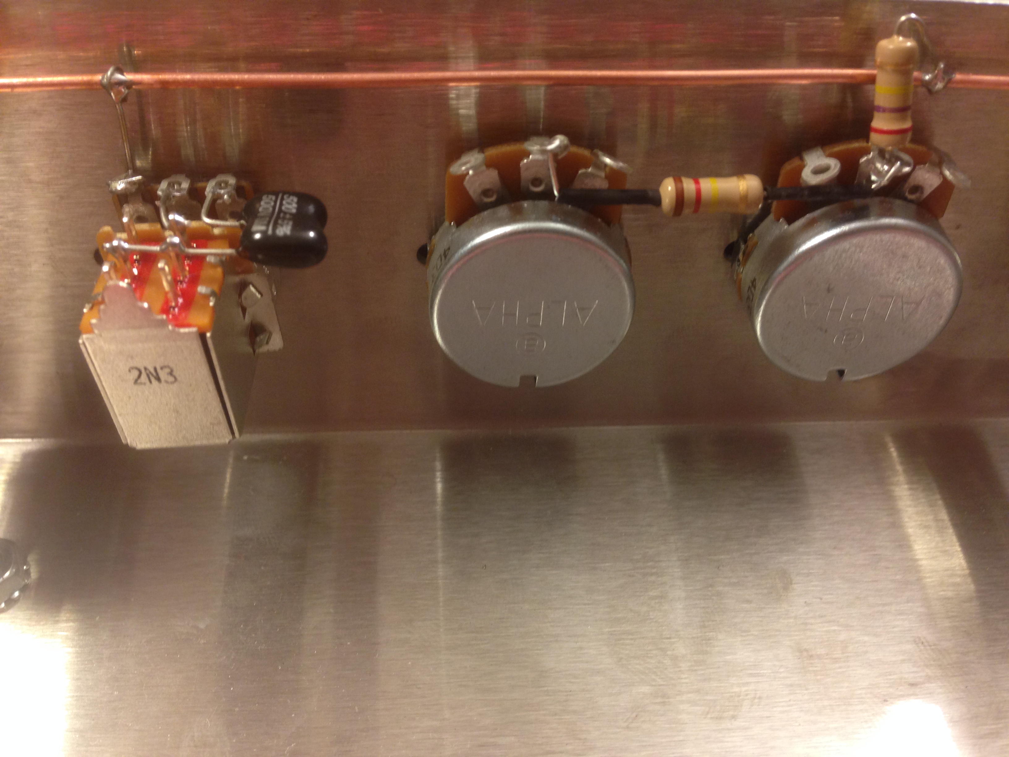

Day 2 - Capacitor Assembly. Power Transformer Switching and Wiring

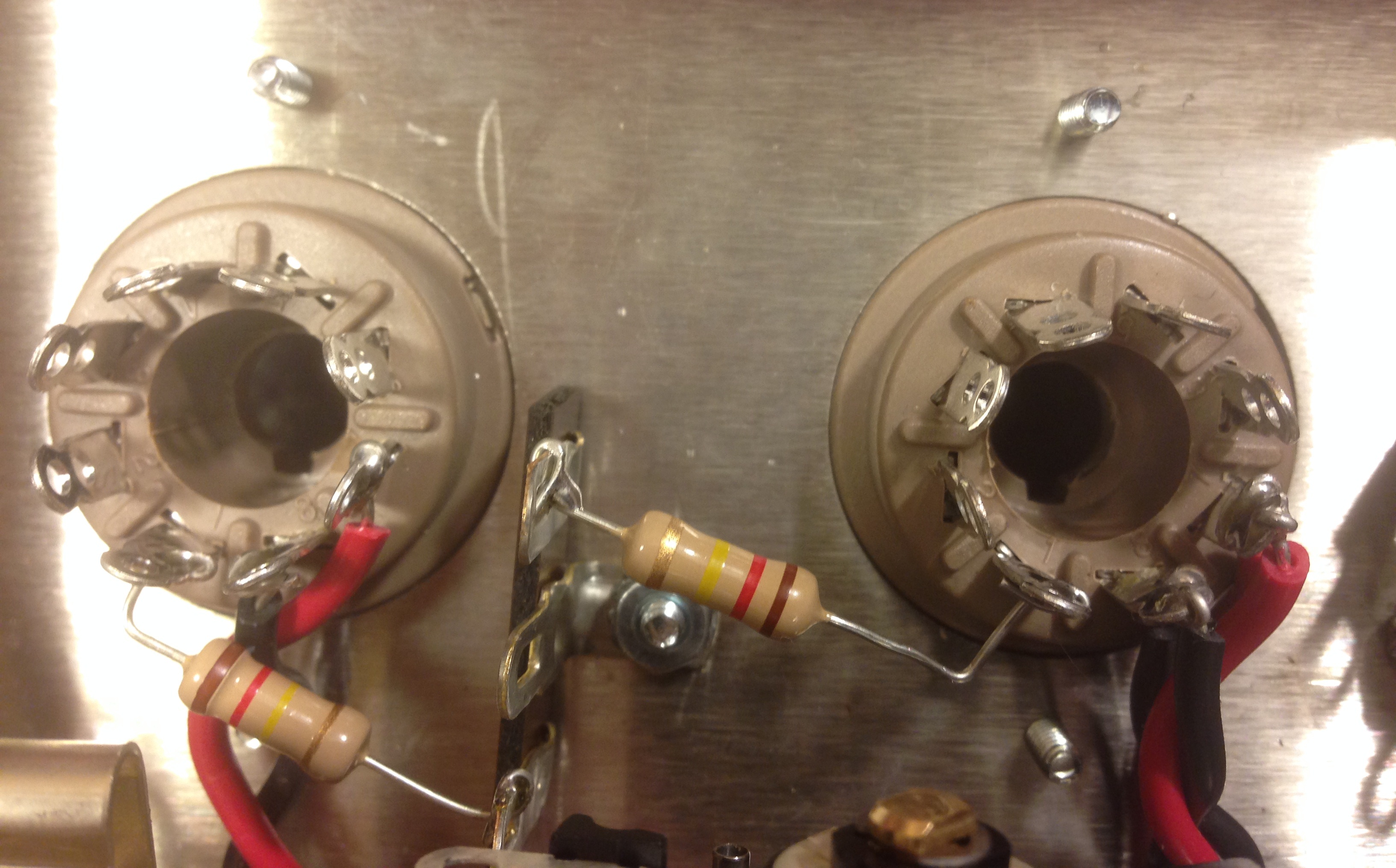

PostPosted: Sat Apr 25, 2015 9:15 am

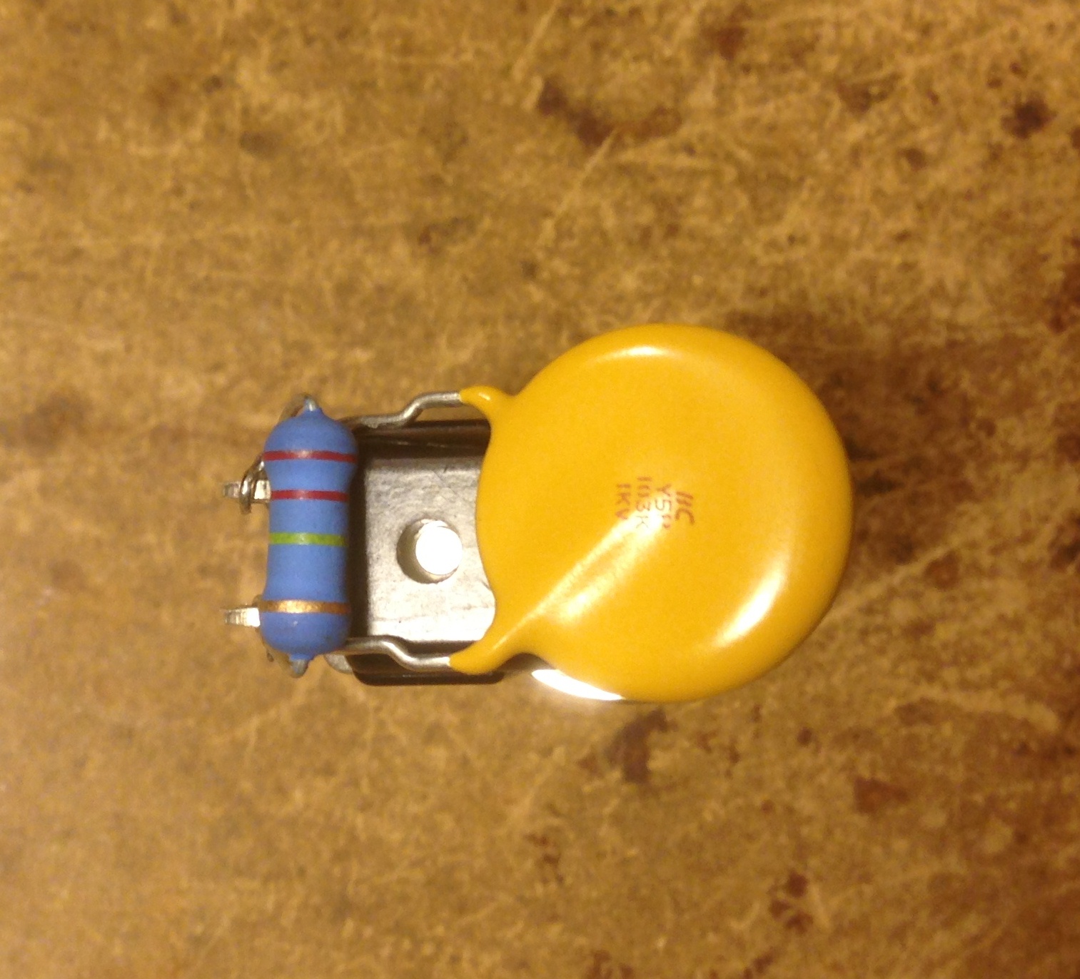

Day 3 Bias Pot Wired Up

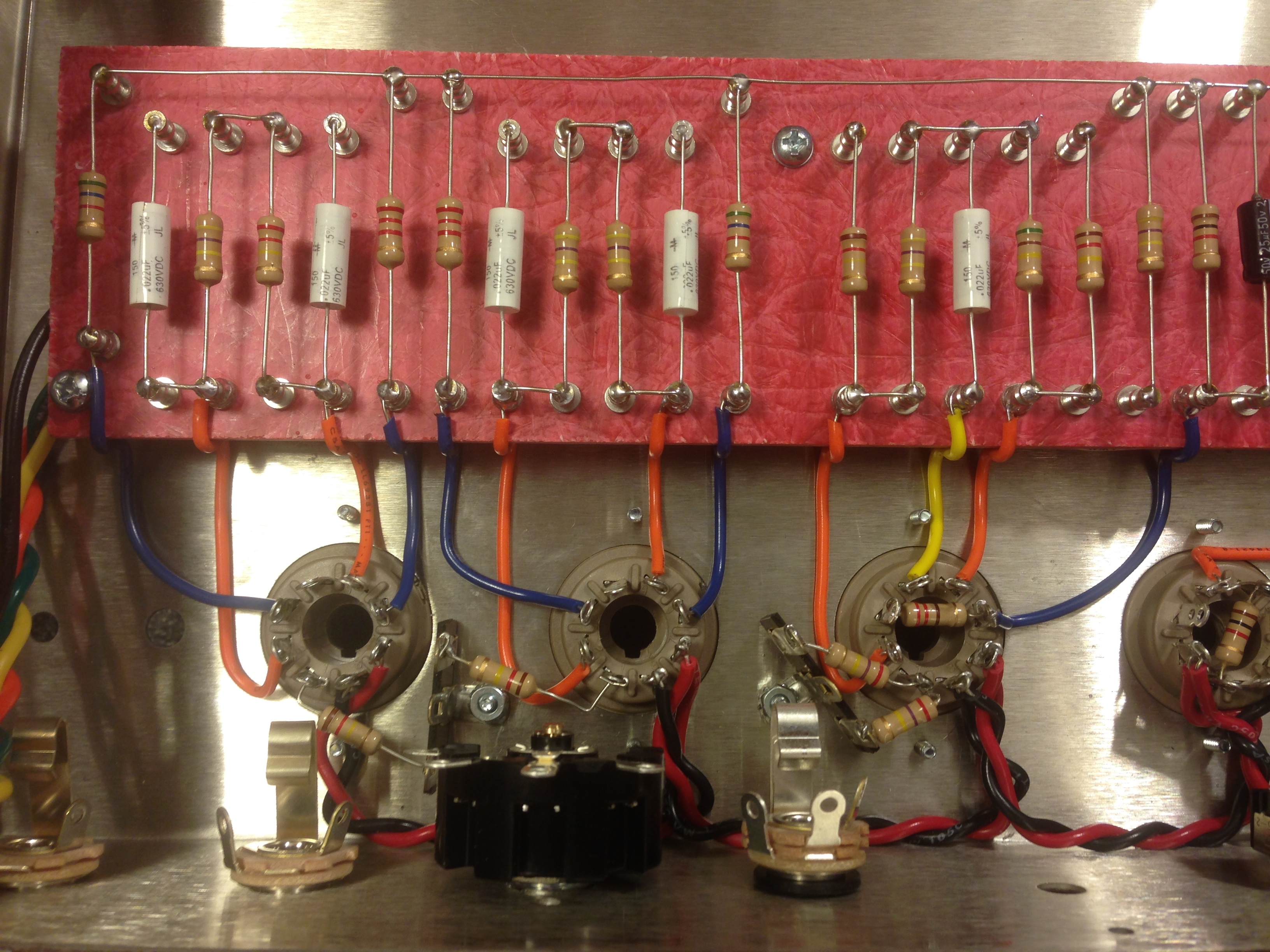

Day 4 - Turret Board Built and Installed

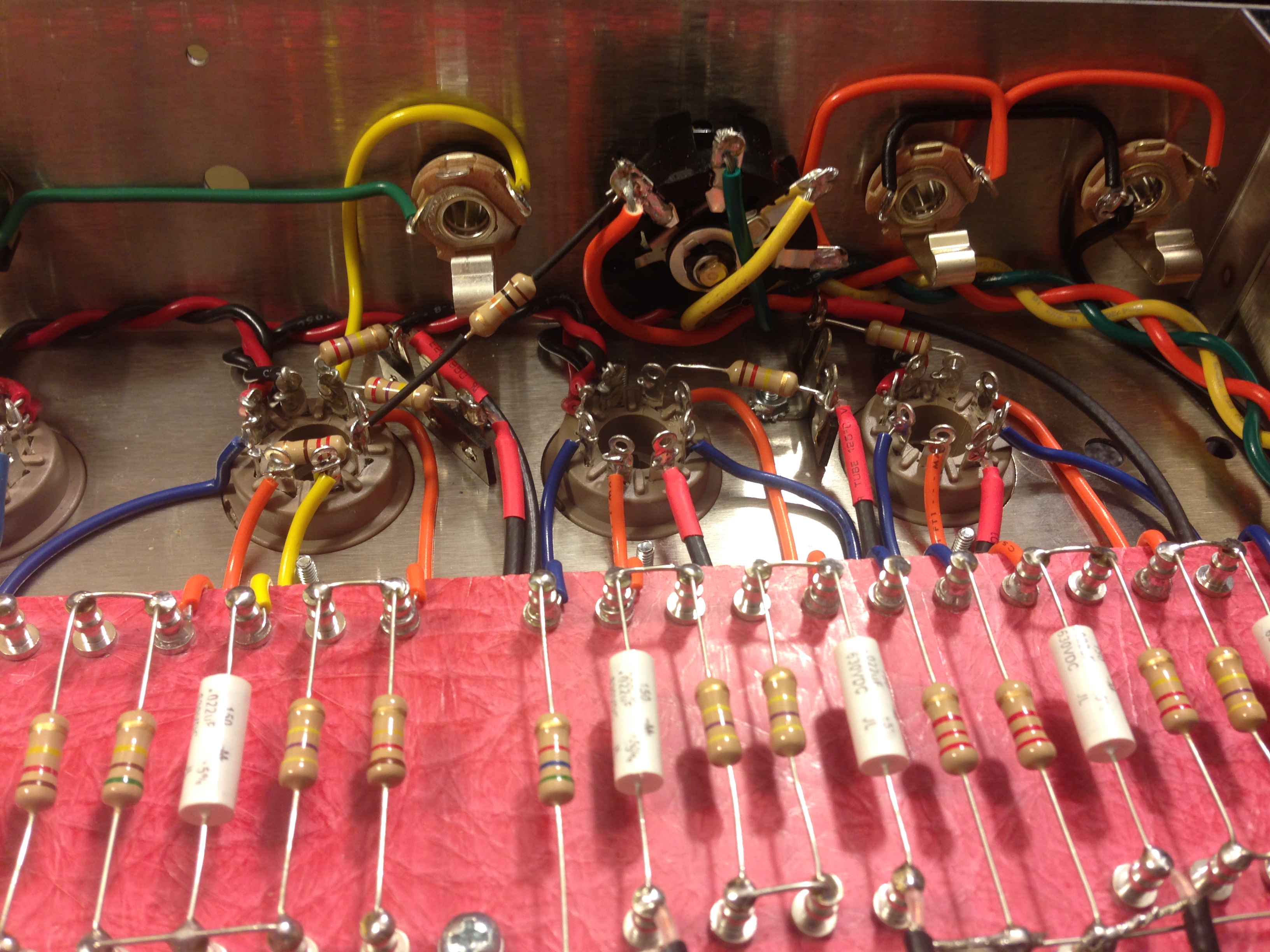

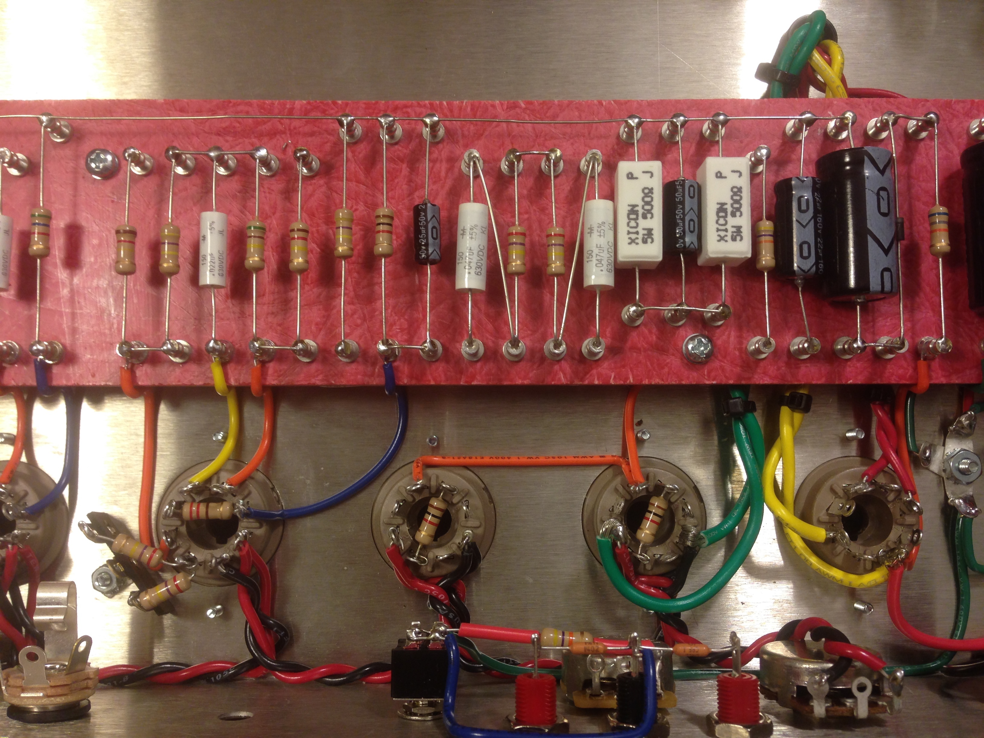

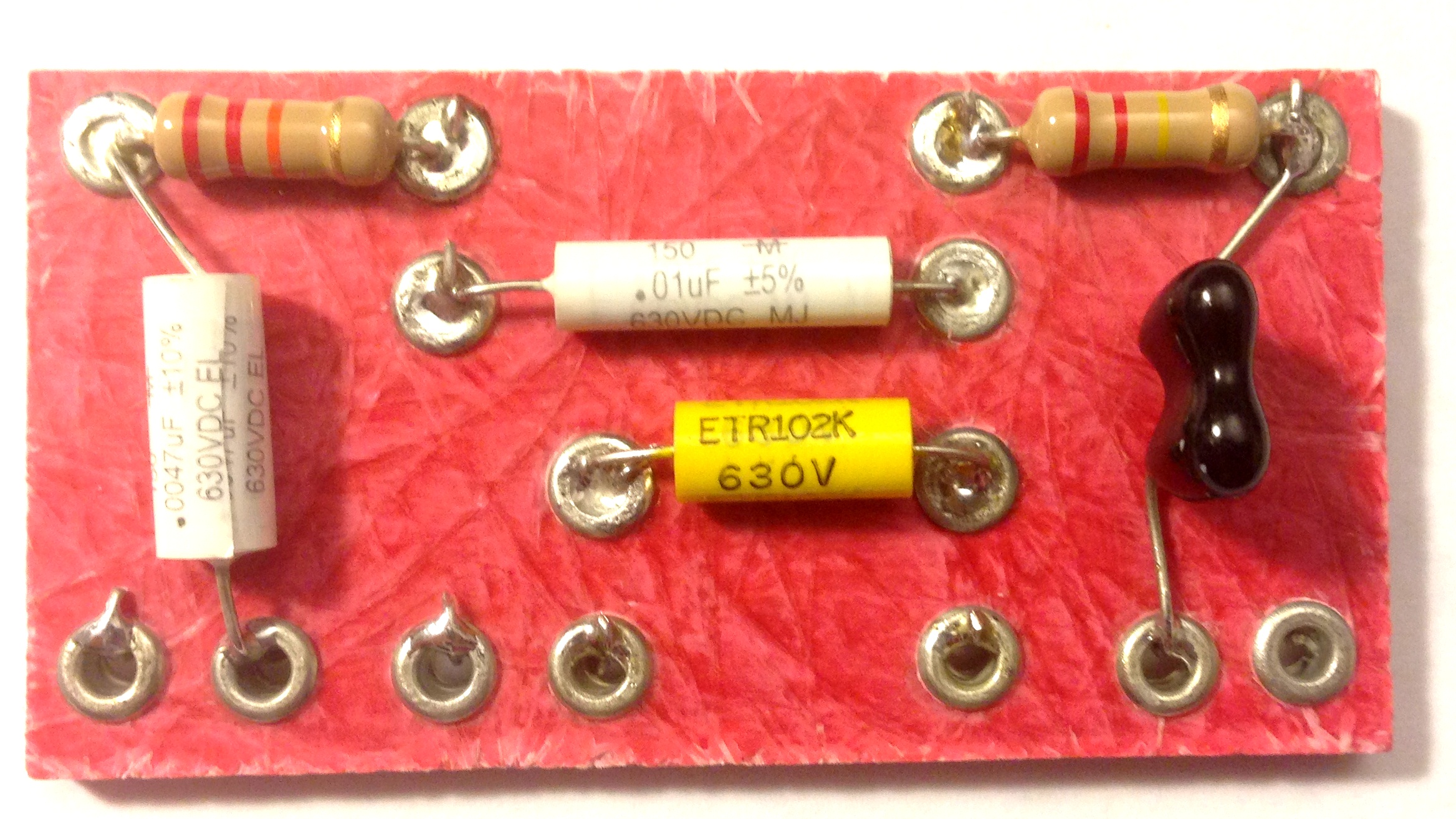

PostPosted: Sat Apr 25, 2015 9:35 am
Day 5 - Tone Boards Built. Grid Resistors Installed on Socket. Note Orientation of Terminal Strips. Bleeder Resistor on Can Cap. Control Bus Bar installed.
Turret Board connected to Sockets.
Correct Rectifier Wiring. Orange Wire to Bias Supply Resistor (68K 1W) Goes on Pin 6

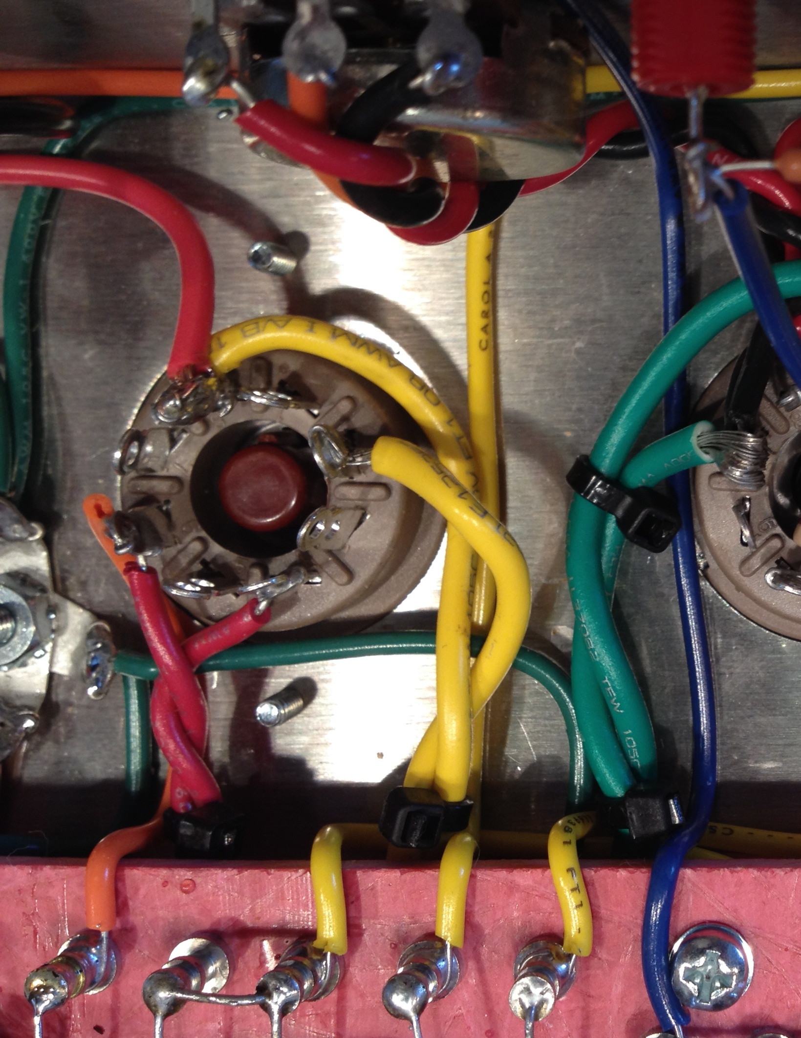

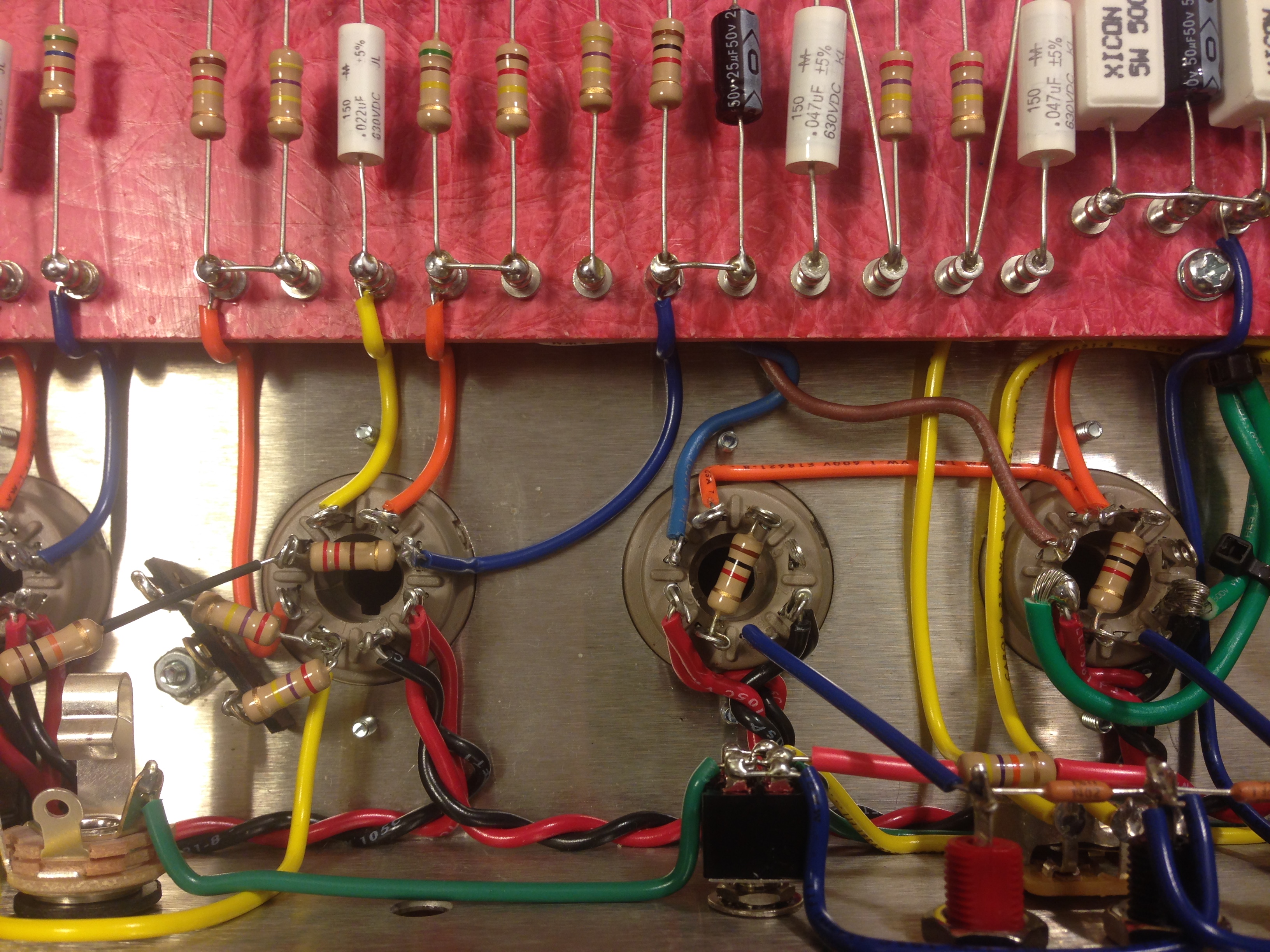

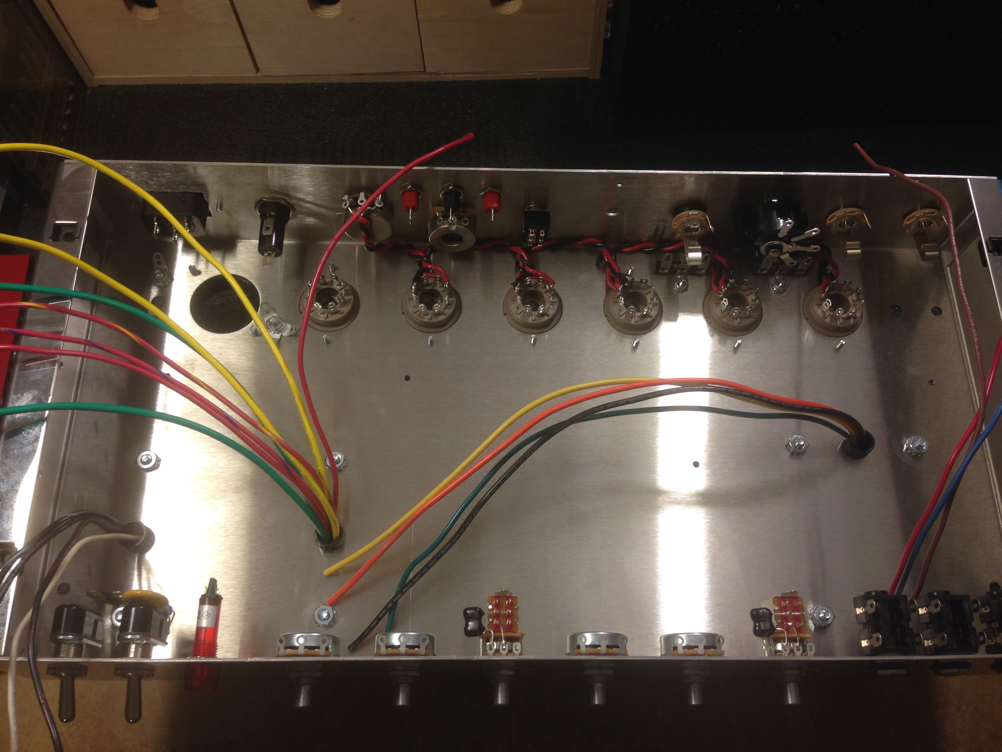

PostPosted: Sat Apr 25, 2015 9:44 am
Day 6 More Tube Socket Wiring. OT Leads Twisted and Connected to Sockets. Impedance Switch Wired.

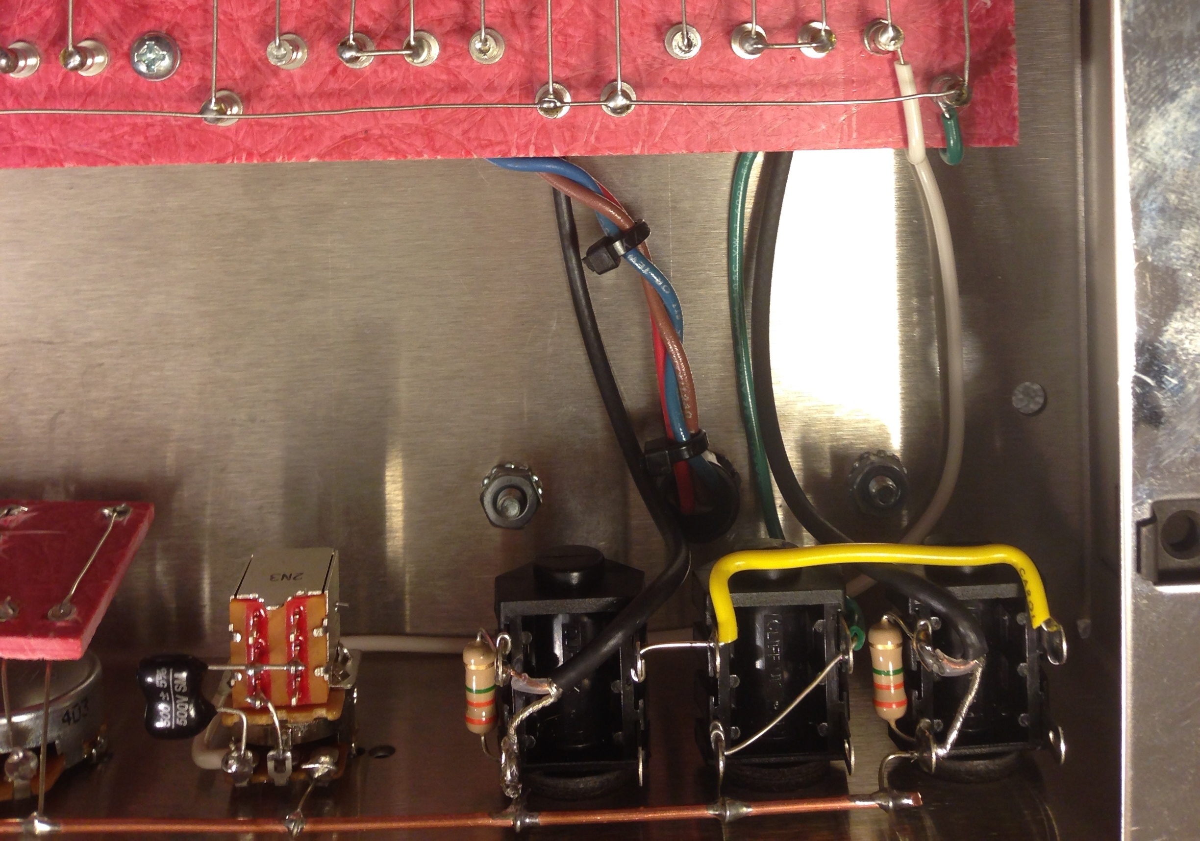

PostPosted: Sat Apr 25, 2015 9:53 am
Day 7 Tone Boards Installed. Input Jacks Built & Installed. Controls Connected with Coaxial / Shielded Cable.
