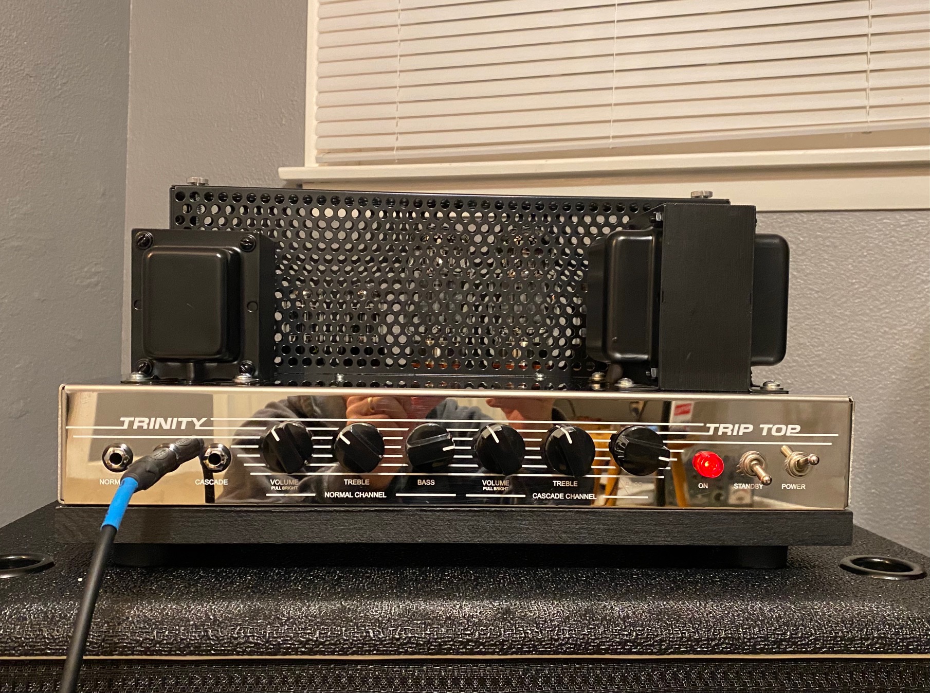

Finished my build in October and have been using this amp daily. My poor V4B feels neglected. Been trying different power tubes. Tempted to go the 6550 / KT88 route, but the point of this build was to have a lower wattage amp to my V4B. Certainly I'll do it at some point, just because!
I've been trying different 6L6GC variants. Started with NOS Sylvanias but became put-off with those given the difficulty finding a good matched set and the sometimes crazy price. Had more than my share of crap tubes that were sold as "tested NOS"... In the end, I have two truly decent sets of NOS Sylvanias on hand. Spent an uncomfortable amount of money getting there though. Honestly not sure it's worth it. My experience with new reissue tubes has been excellent, they also sound great and you can get a well matched set from a reputable tube vendor. No need to play tube roulette. I've tried JJ 6L6GC, Tung-Sol 6L6GC STR, Tung-Sol 7581A (boosted 6L6GC) and just recently a set of Tung-Sol KT66. The Tung-Sol KT66 is said to be a rebottled 6L6GC STR, and it may be, but there is bit of difference in tone. The TS 6L6GC STR is just a bit dark, maybe good for a bass amp, but the TS KT66 seems to have a bright high end, not harsh just brighter. It is a great tube and I think it's going to be the one I use going forward. Bonus, it's a KT66 but it only draws 900mA at the filaments like the 6L6GC and looks bad-ass with its fat coke bottle envelope hiding under the tube cage (sad metric, I know).
The JJs are great. Nothing to complain about. Good value and are widely used by OEM. Could be completely happy with them if there were no better choices readily available.
All the Tung-Sols variants I've tried I like better than the JJs. Something about them. I've gone back and forth between any of the Tung-Sols on hand and the JJs, each time I put a TS tube back in it's an "ahhh" moment. Current favorite being the KT66.
Preamp tubes: Got a solid set (with a few spares) of NOS Sylvanias and they will stay put. Tried NOS GE and RCA too. They all sound great. Haven't tried reissue 6SL7GTs.
All in all, this was a fun build and I am sad to see it looks to be discontinued. All the messing around with tubes is really just tweaking that last 10%. The amp sound tremendous no matter the tube compliment. Hoping there is another bass amp kit offered at some point. I'd love to see a low watt SVT style kit. SVT preamp circuit / tone stack driving two 6550s would be most cool...
