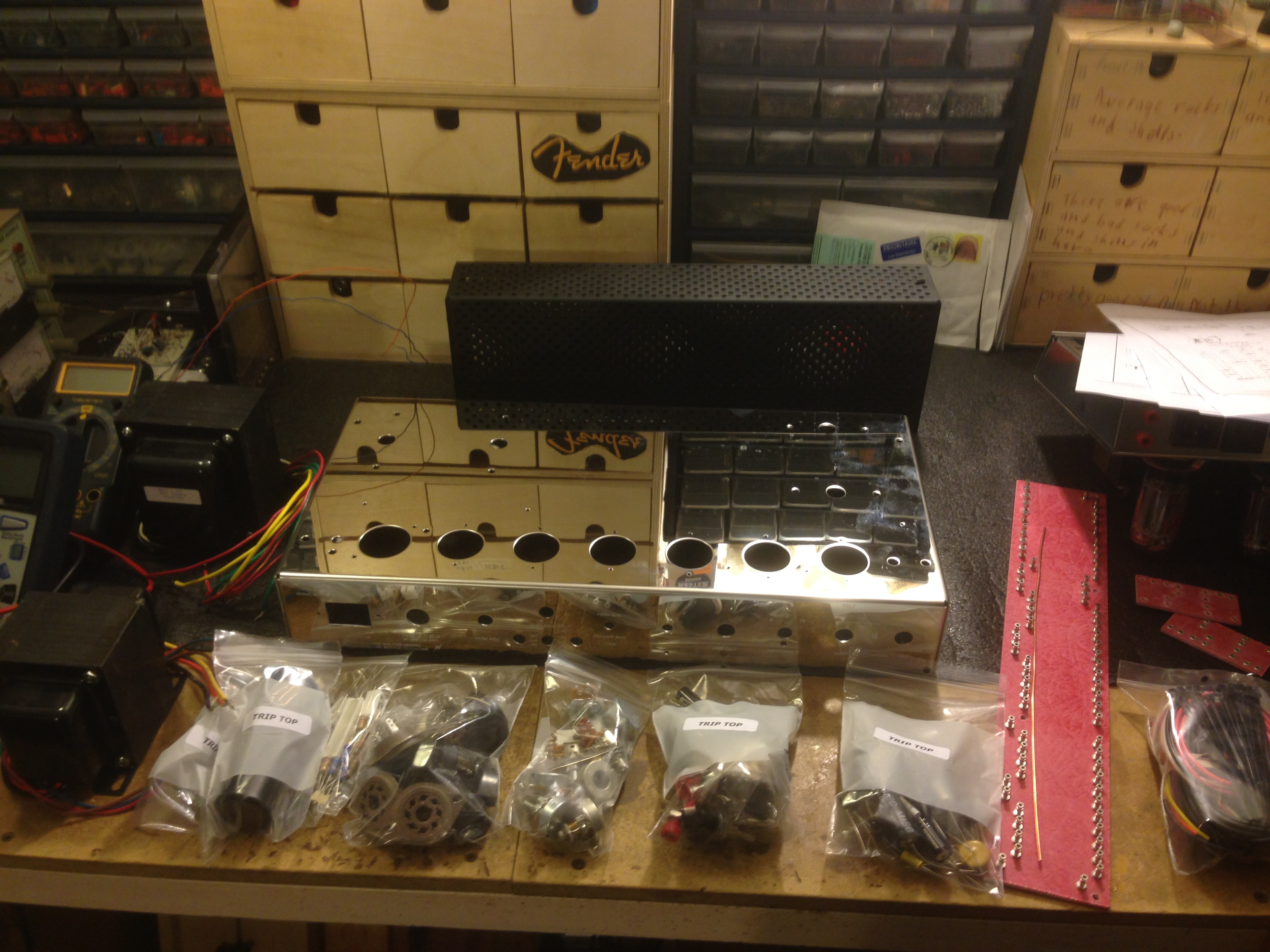

kurtlives is building the first Trip Top and we will be documenting it here. Stay tuned!
PostPosted: Sat Apr 25, 2015 8:51 am

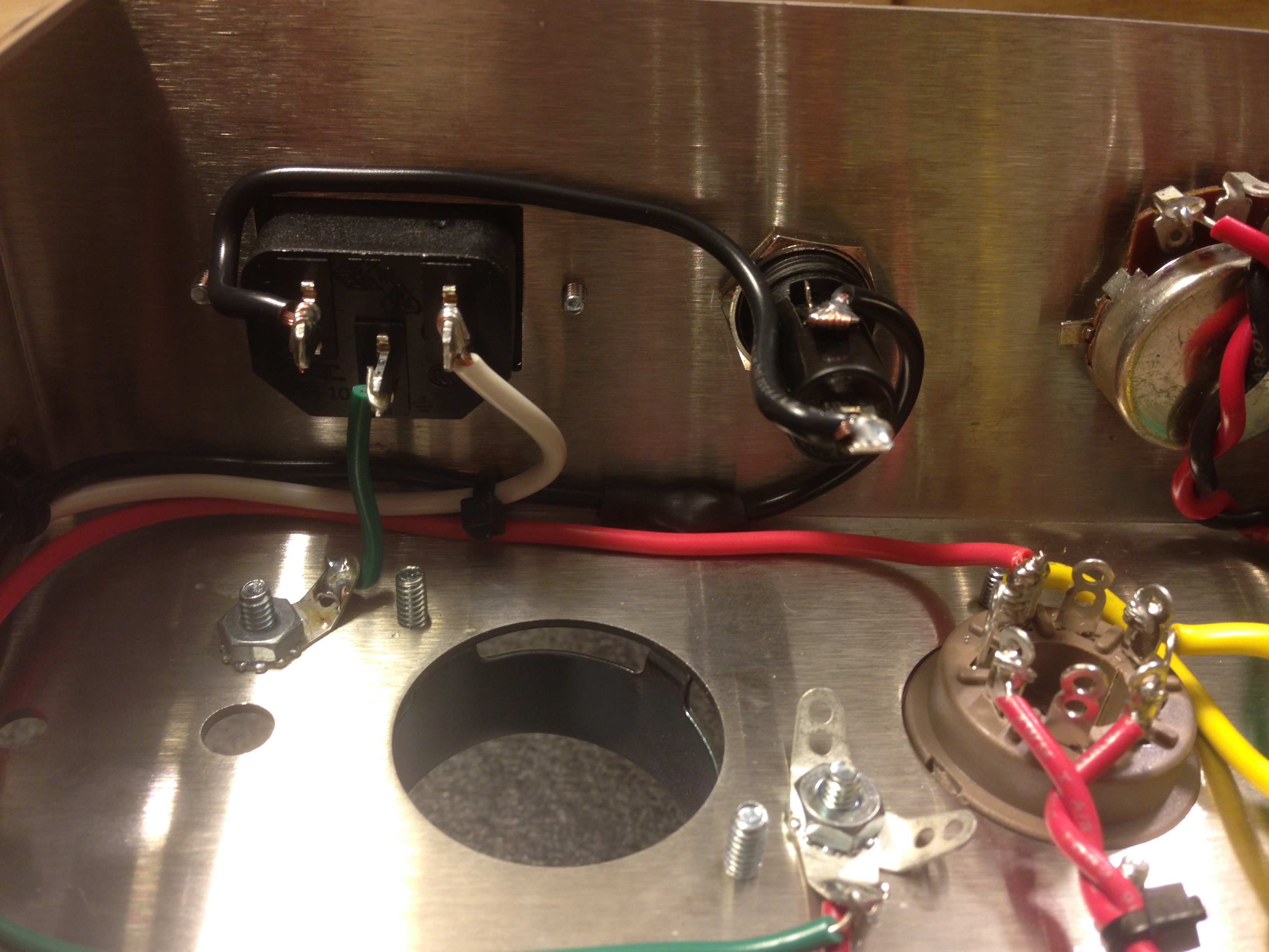

Day 1 - Kit Arrives. Inventory done. Hardware and Transformers installed.

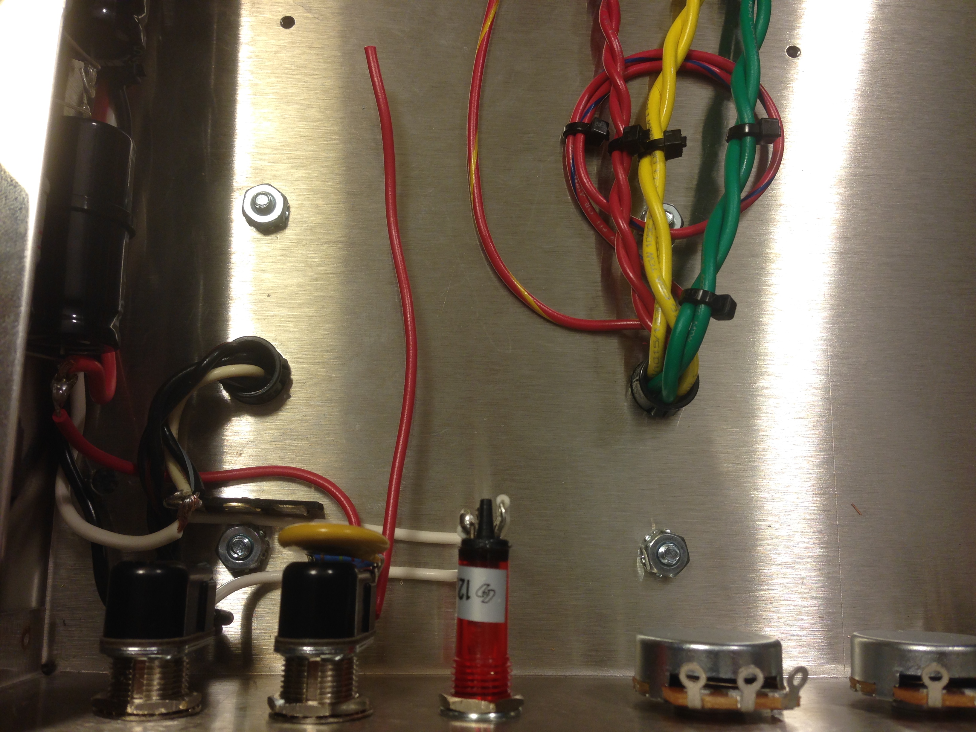

PostPosted: Sat Apr 25, 2015 9:12 am
Day 2 - Capacitor Assembly. Power Transformer Switching and Wiring

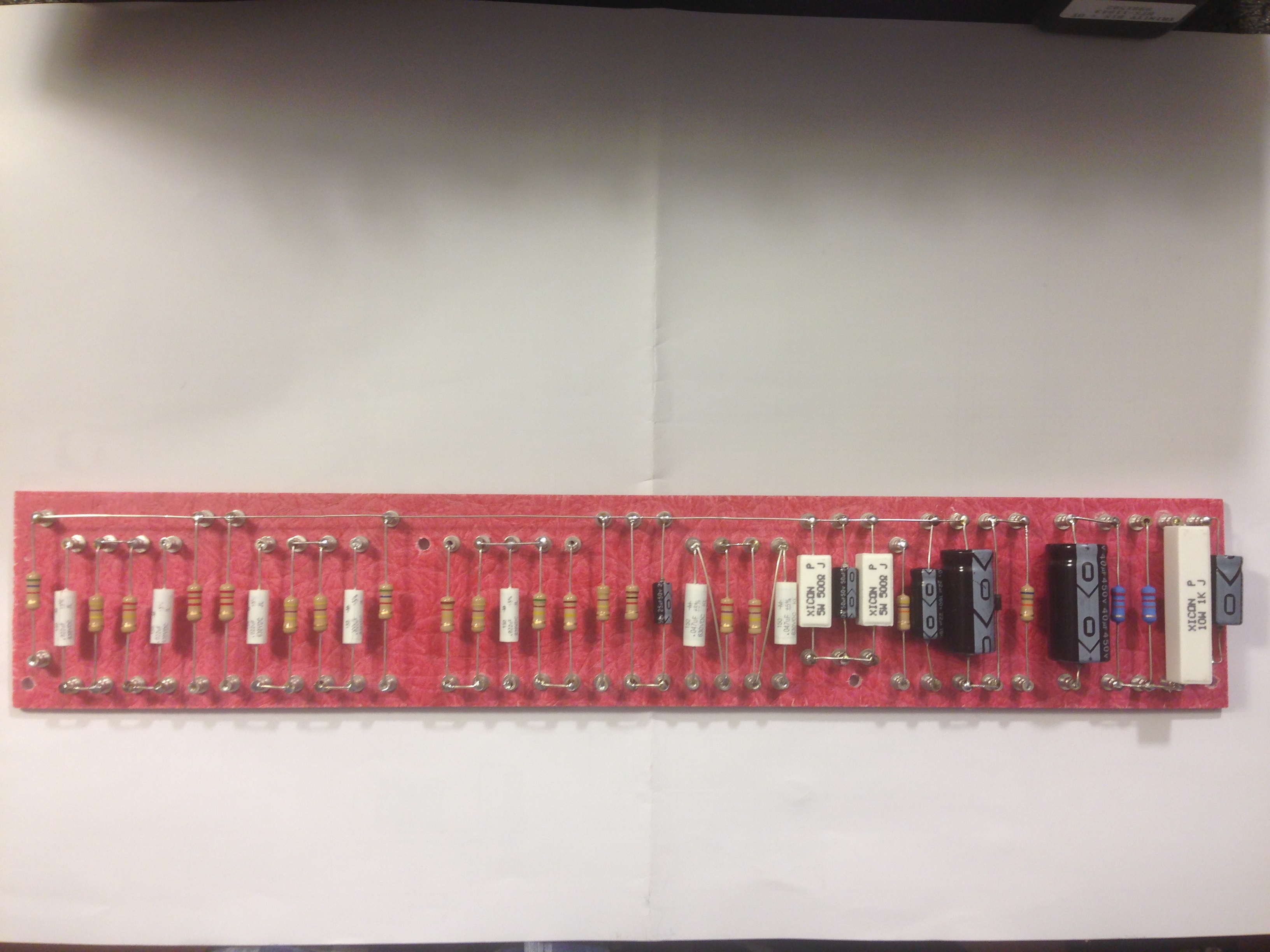

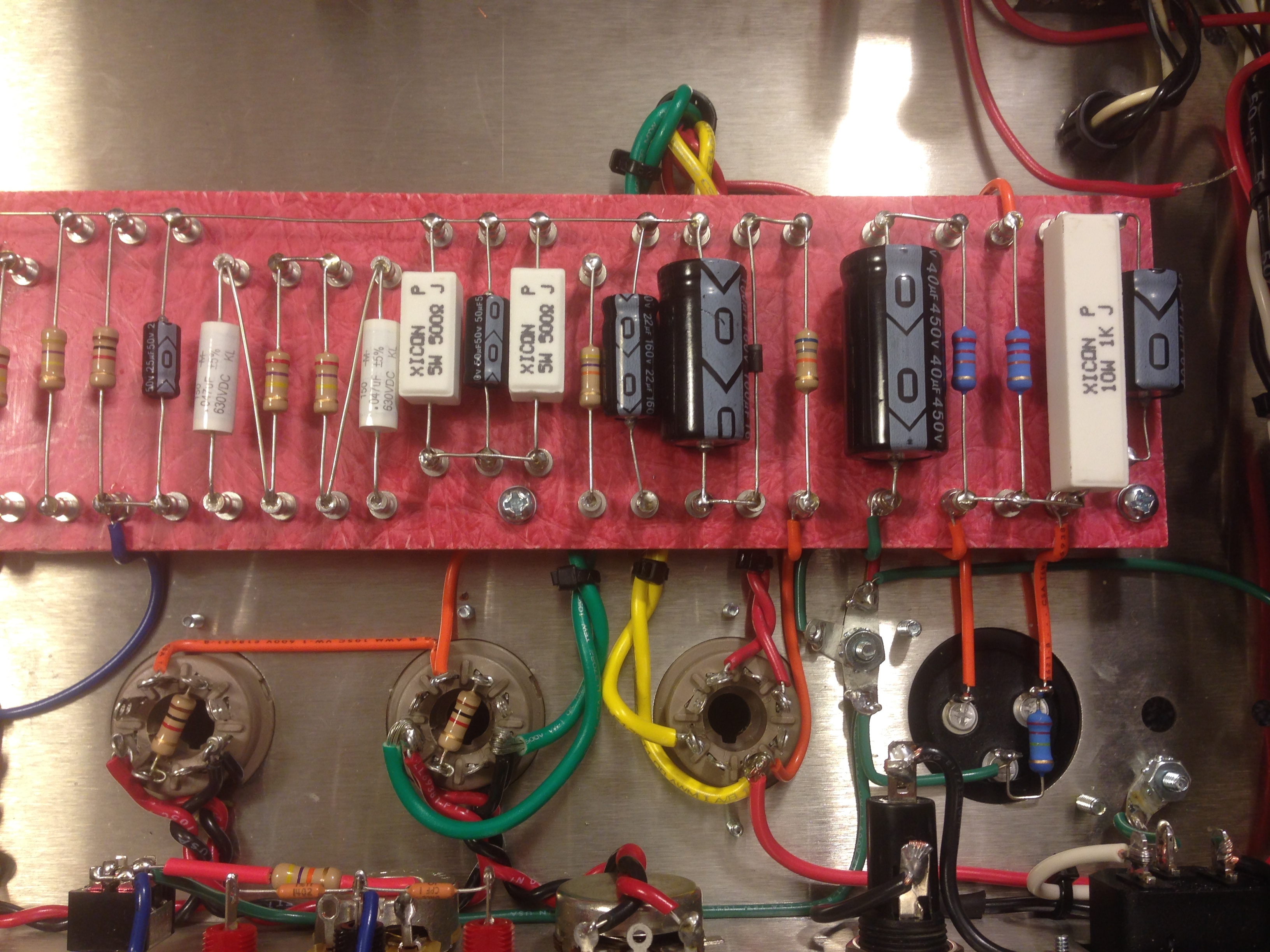

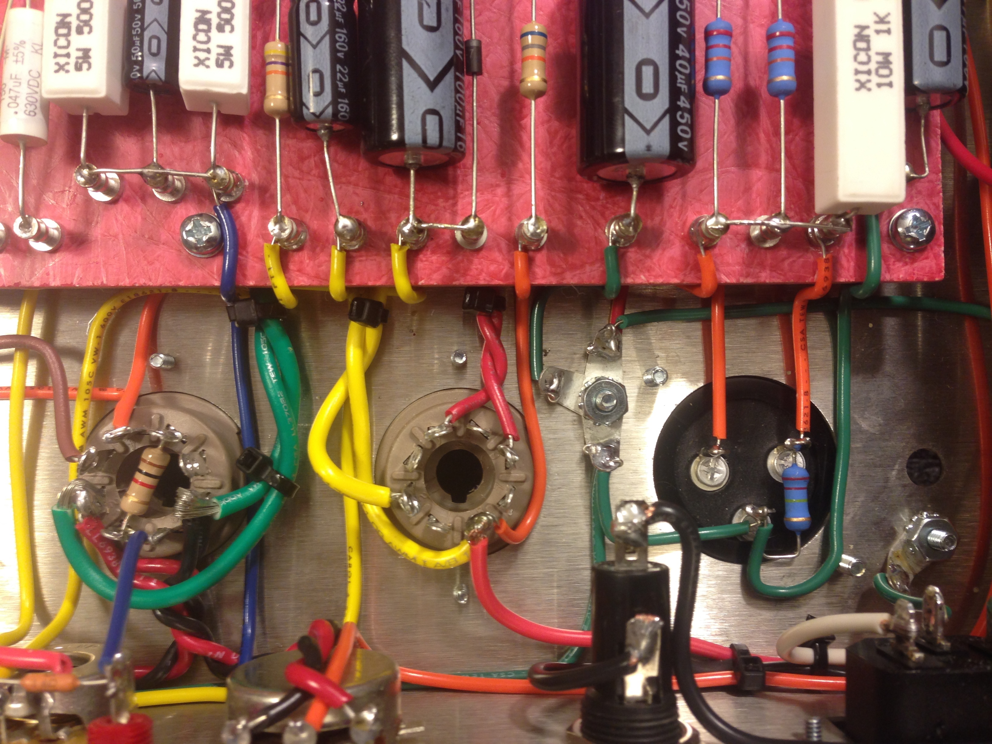

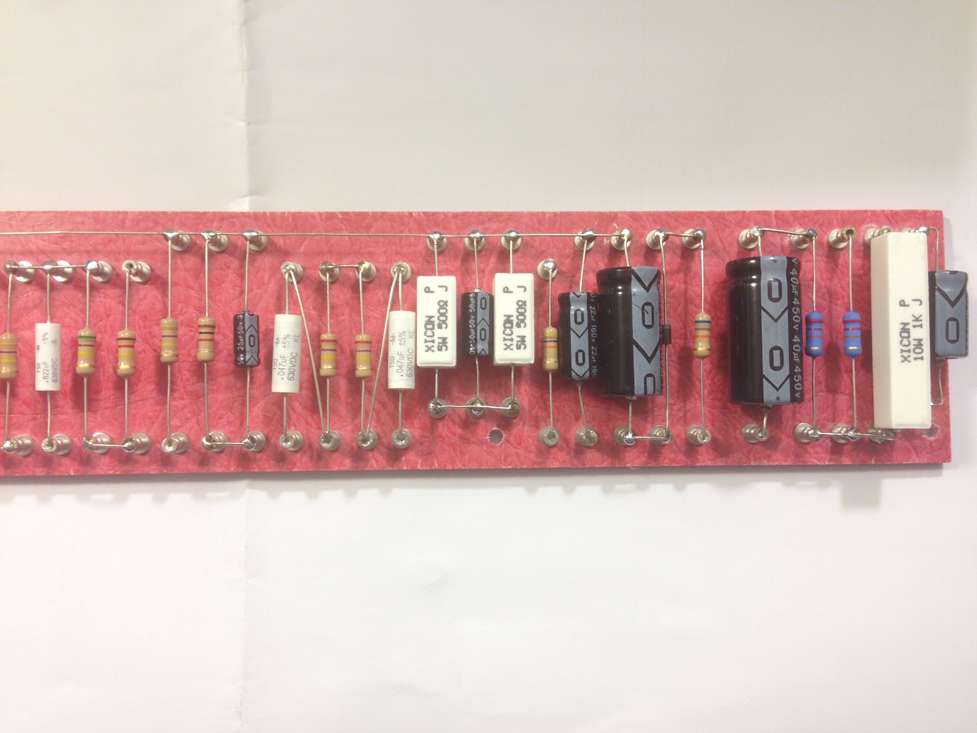

Day 4 - Turret Board Built and Installed

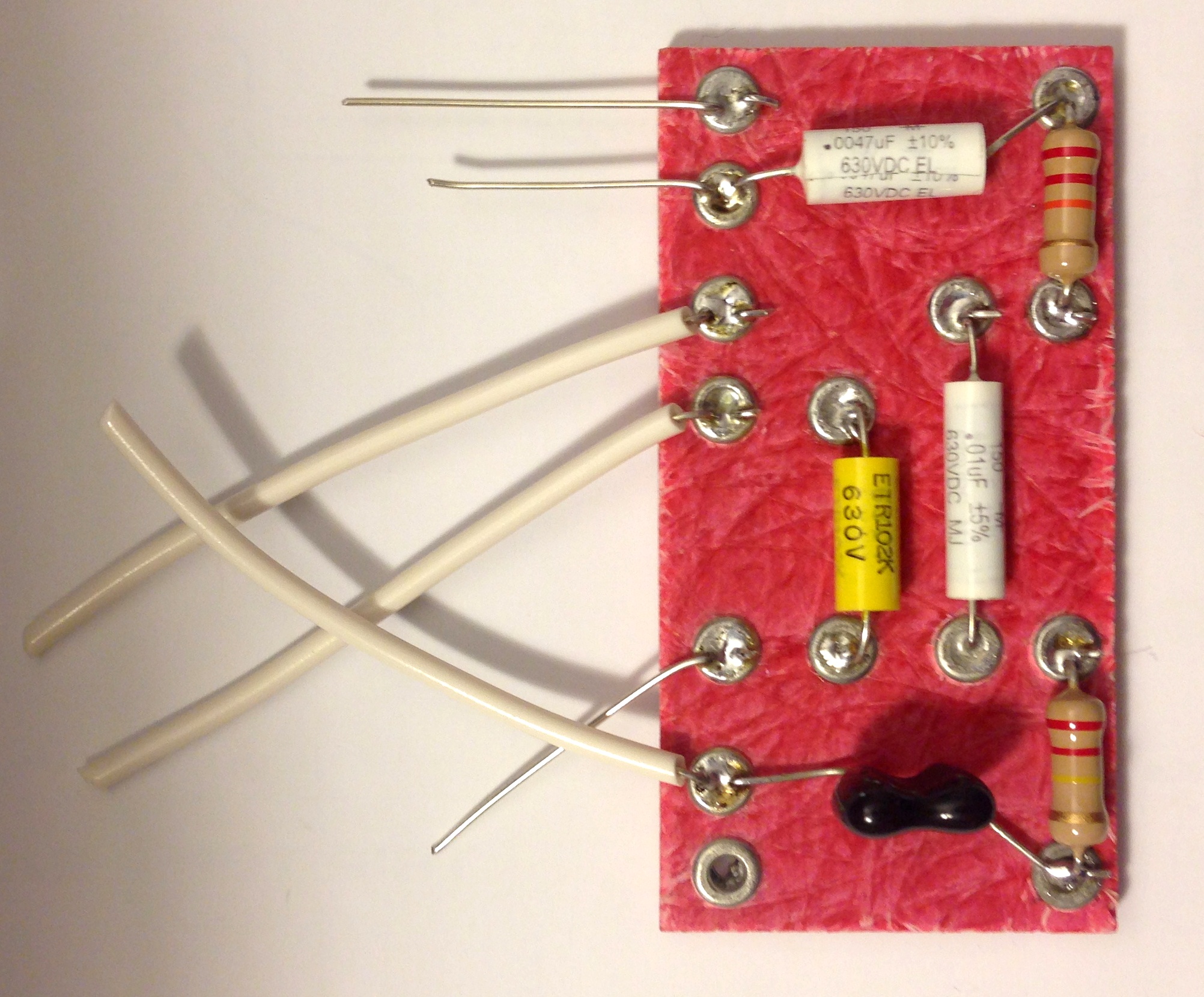

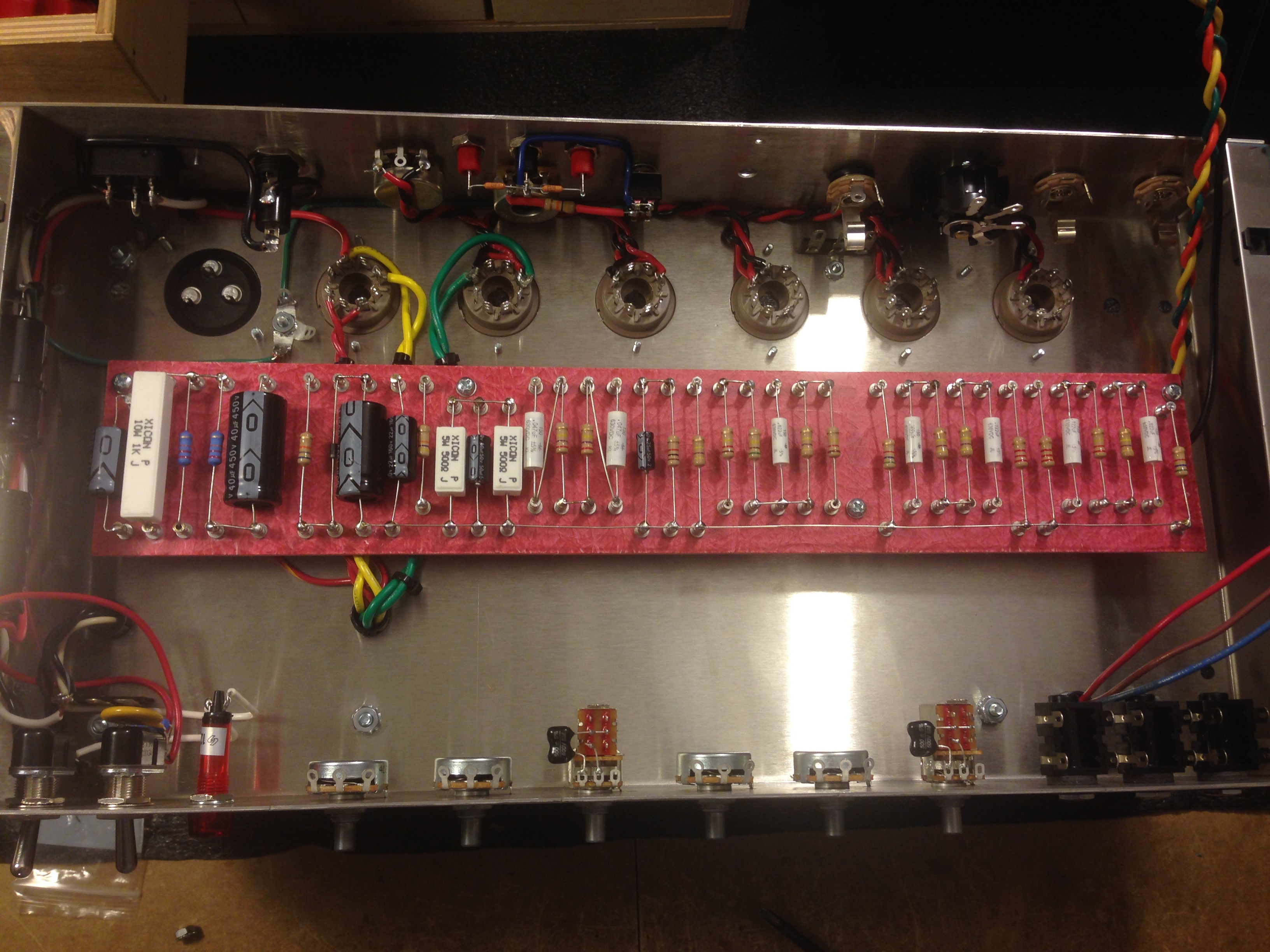

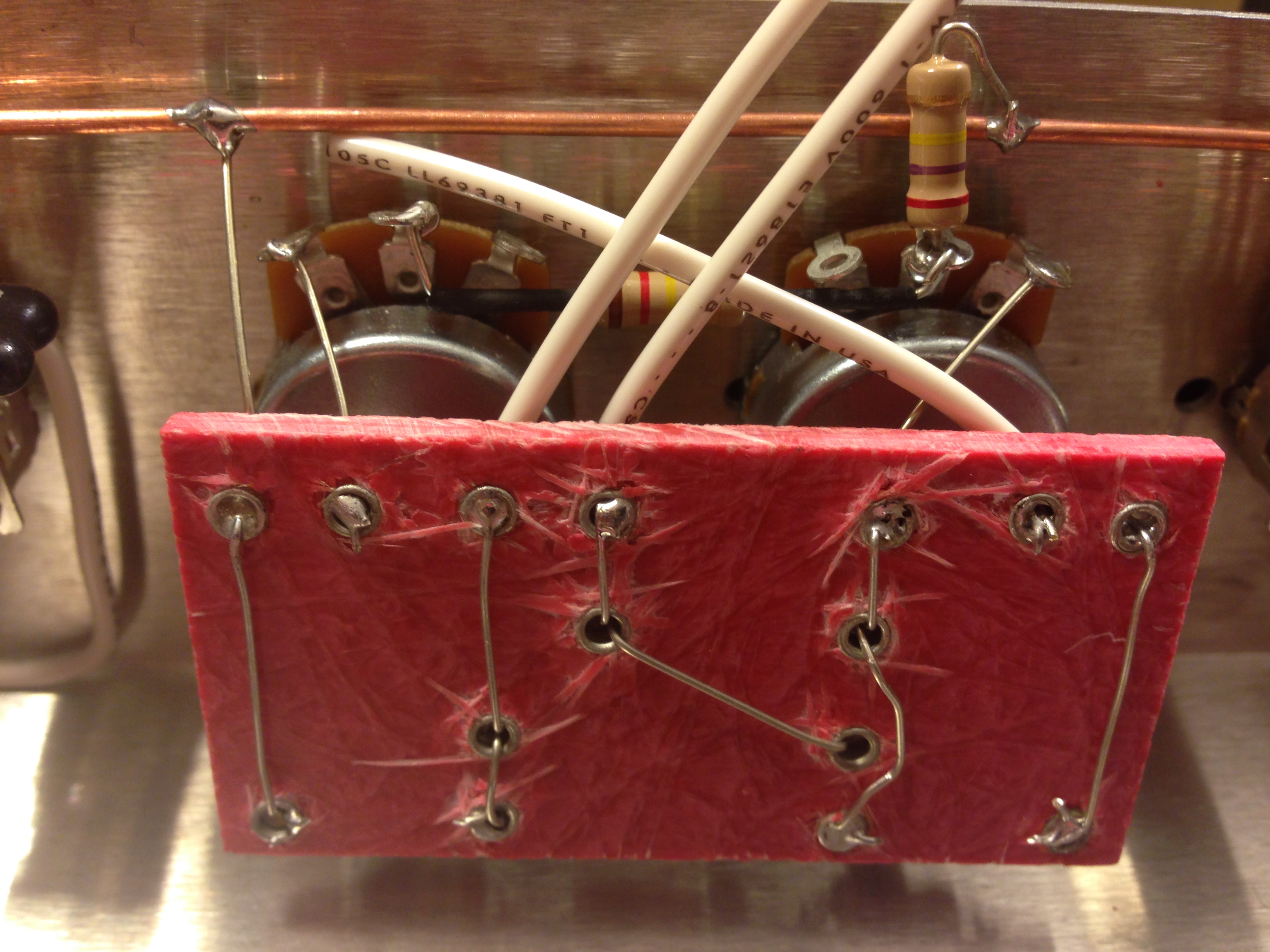

PostPosted: Sat Apr 25, 2015 9:35 am
Day 5 - Tone Boards Built. Grid Resistors Installed on Socket. Note Orientation of Terminal Strips. Bleeder Resistor on Can Cap. Control Bus Bar installed.
Turret Board connected to Sockets.

Correct Rectifier Wiring. Orange Wire to Bias Supply Resistor (68K 1W) Goes on Pin 6

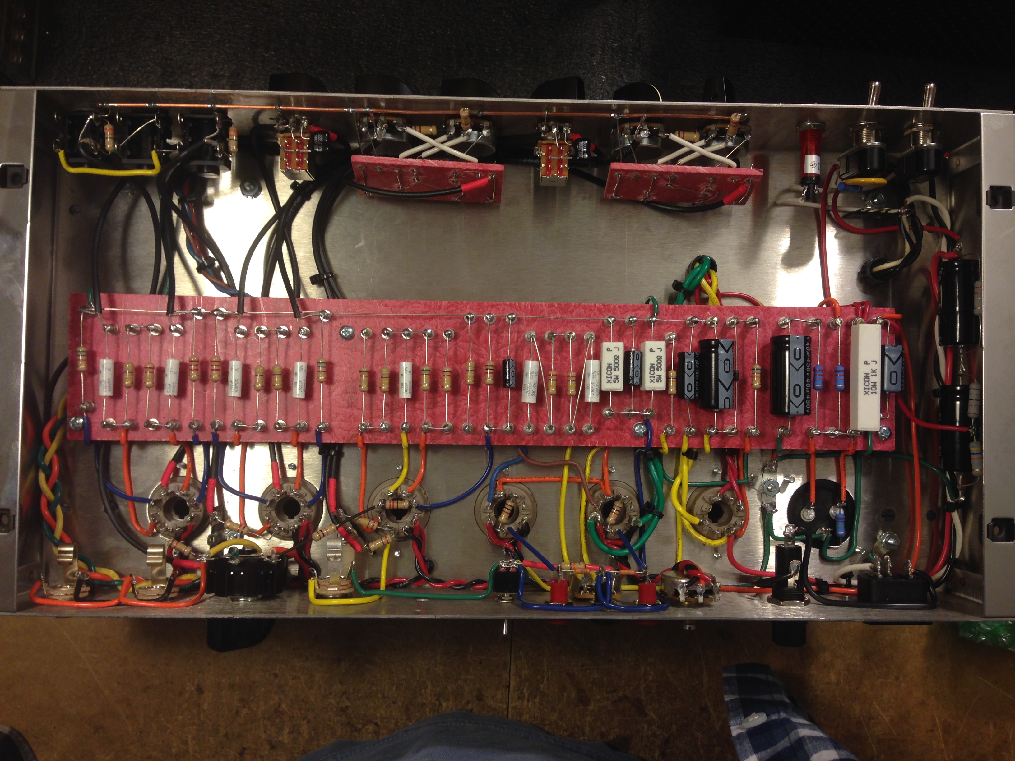

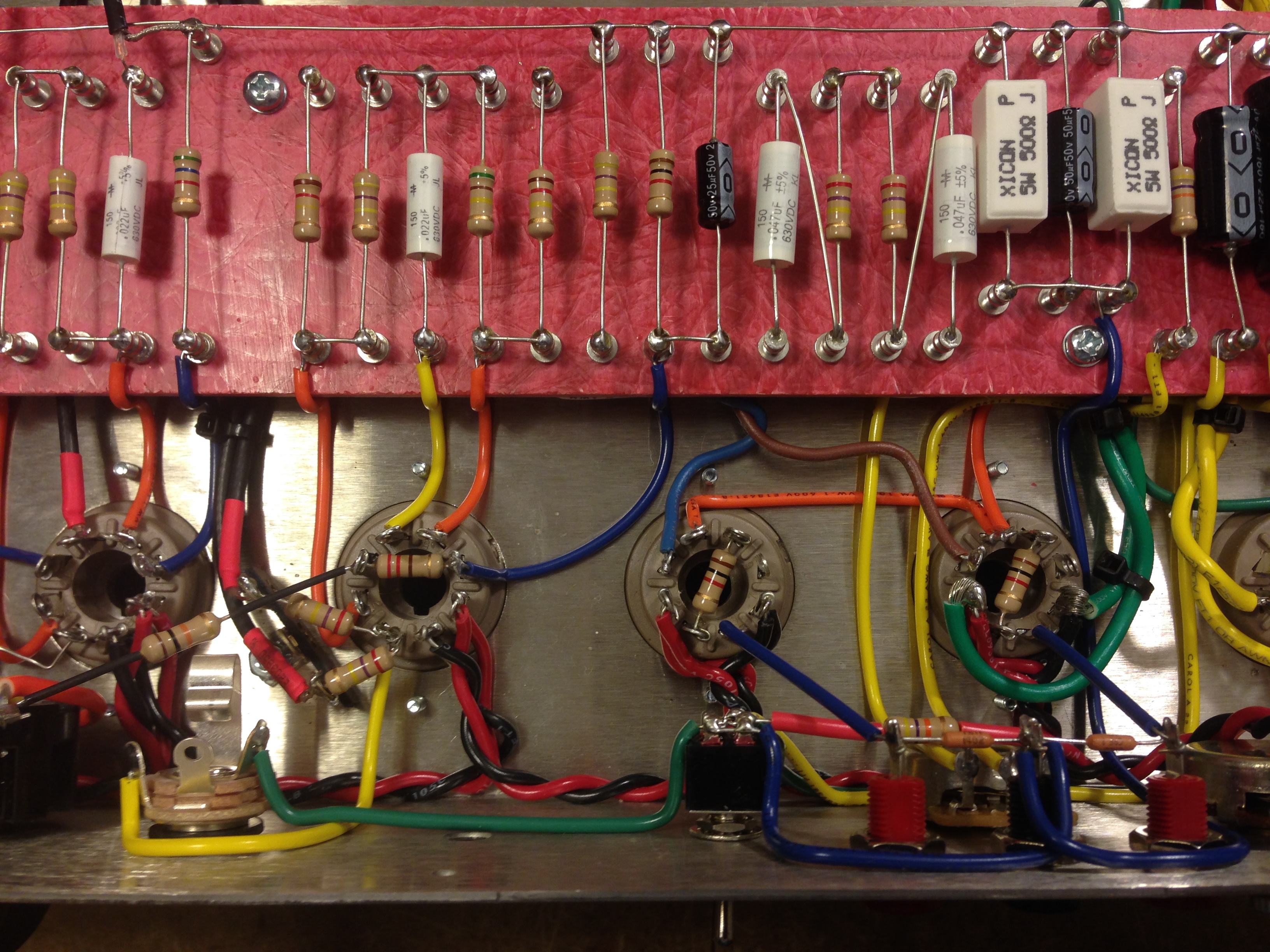

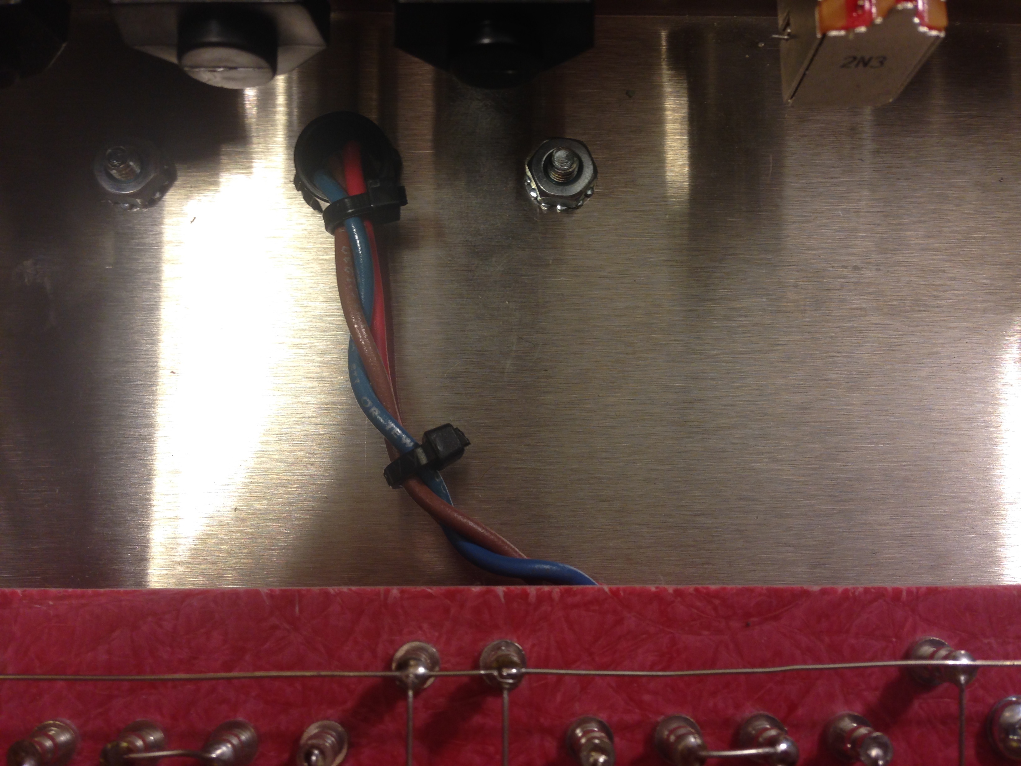

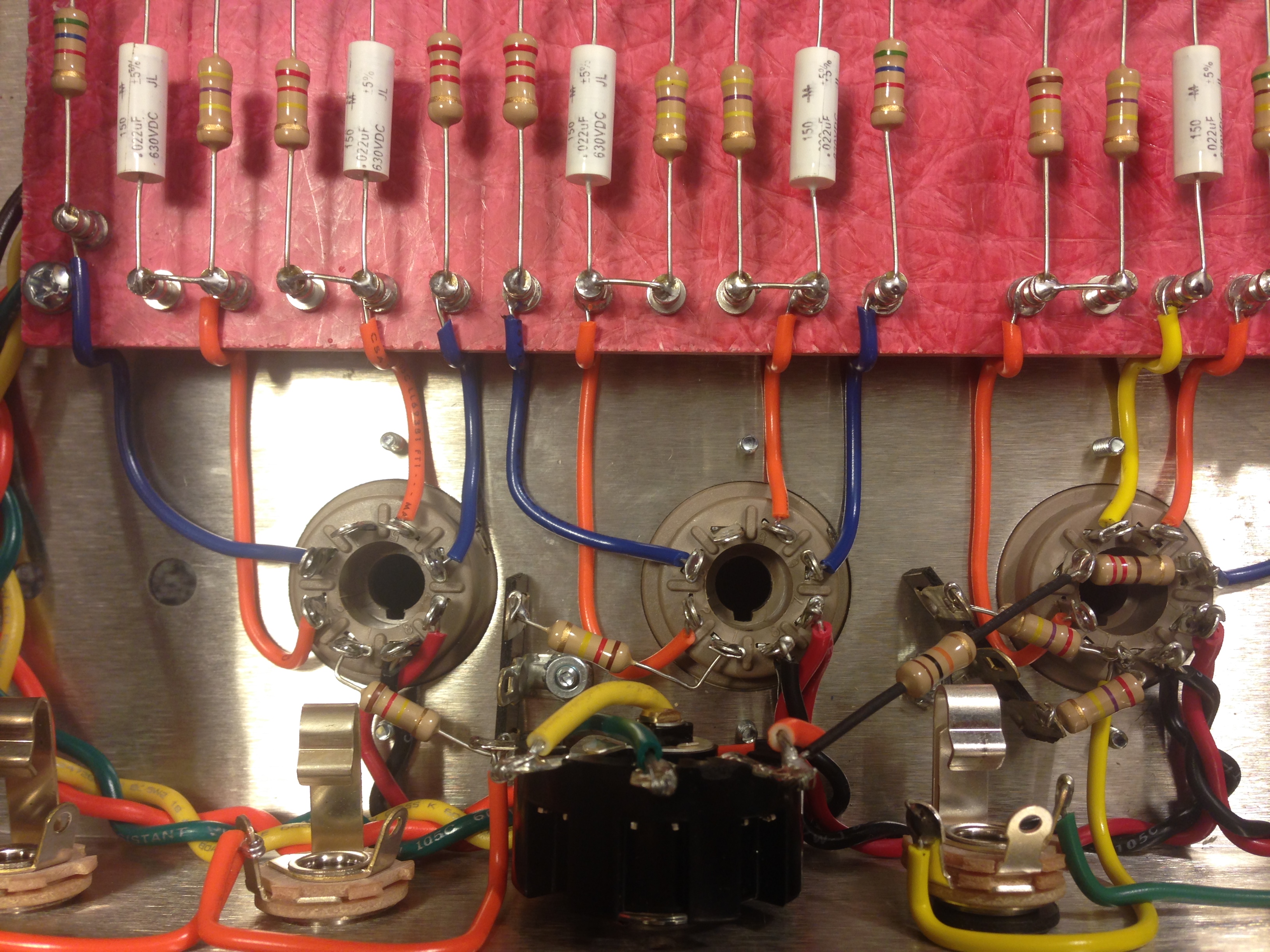

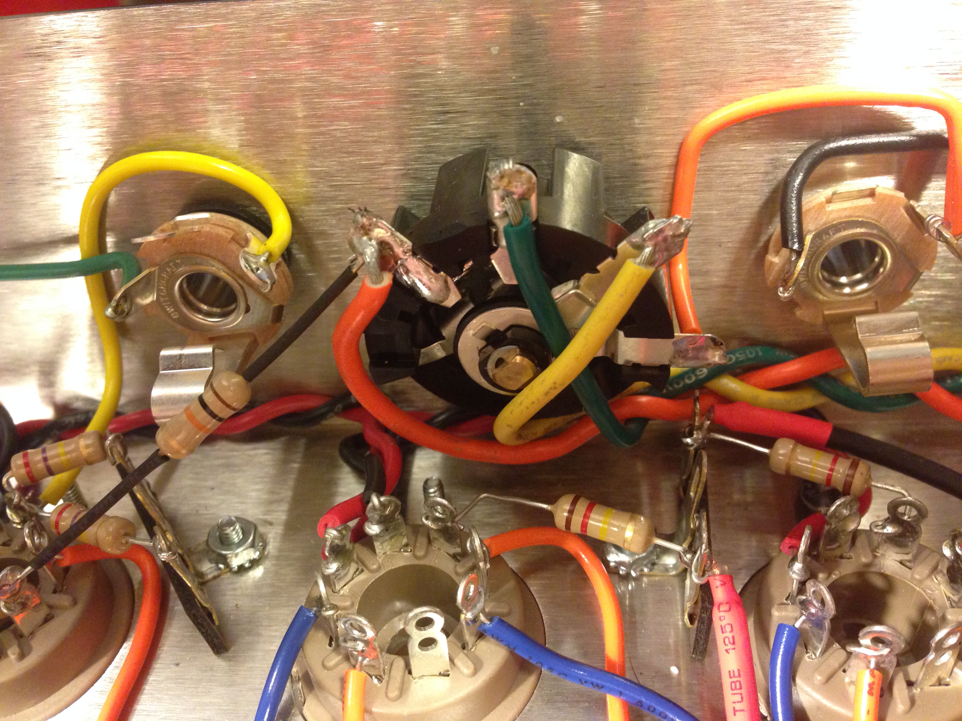

PostPosted: Sat Apr 25, 2015 9:44 am
Day 6 More Tube Socket Wiring. OT Leads Twisted and Connected to Sockets. Impedance Switch Wired.

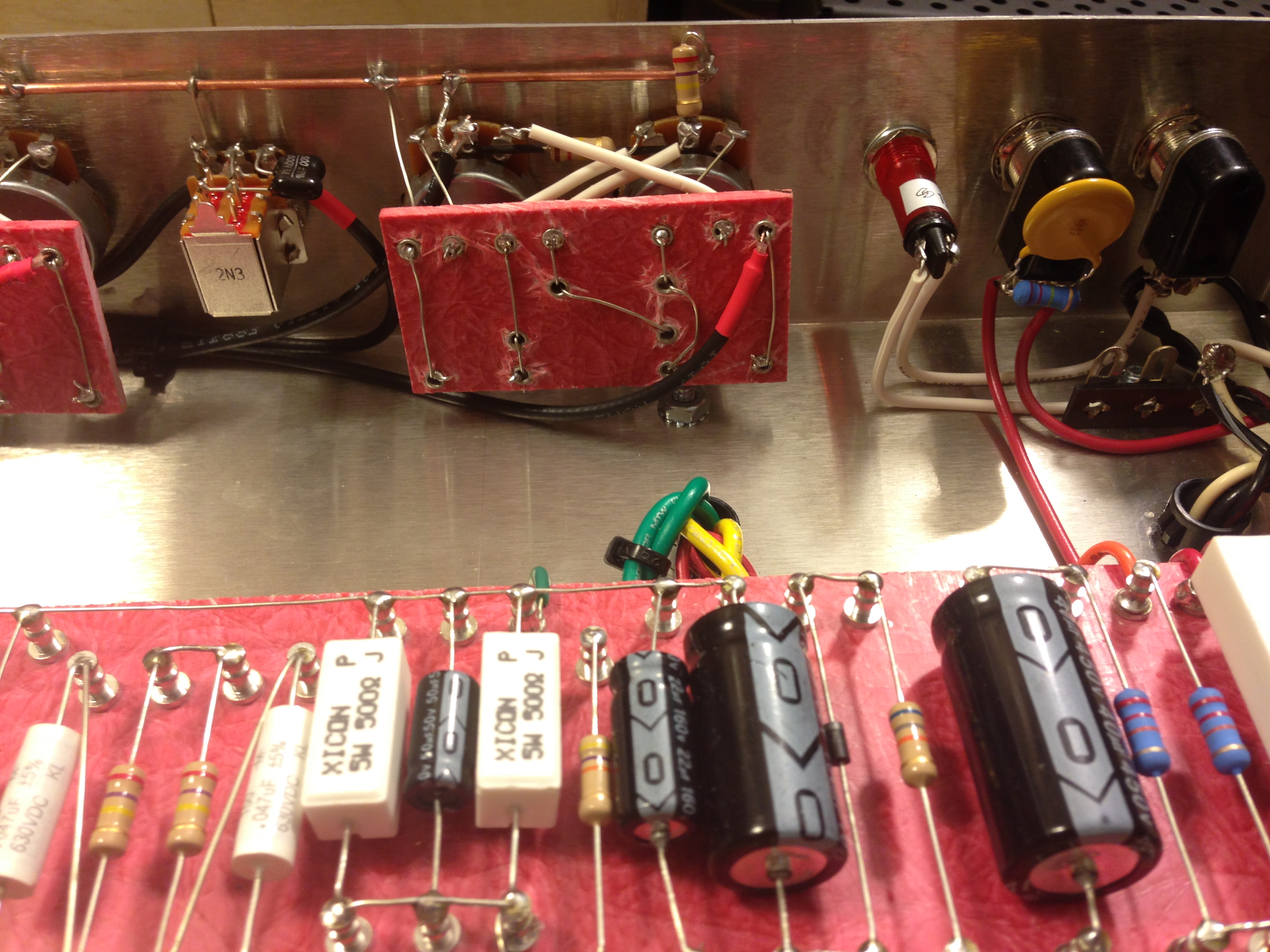

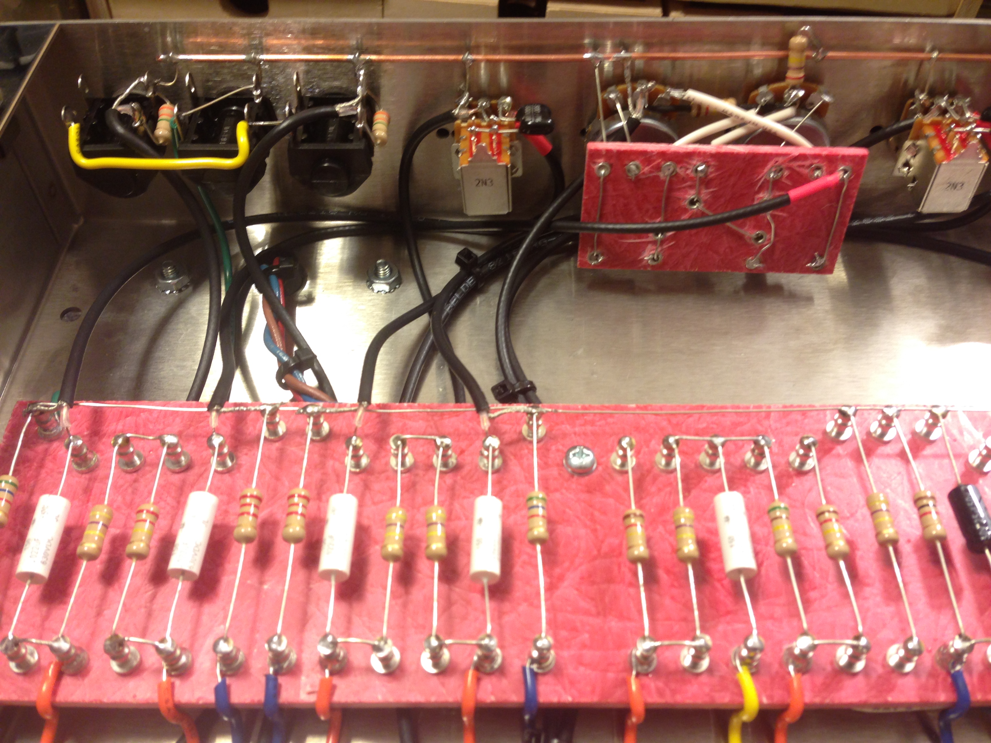

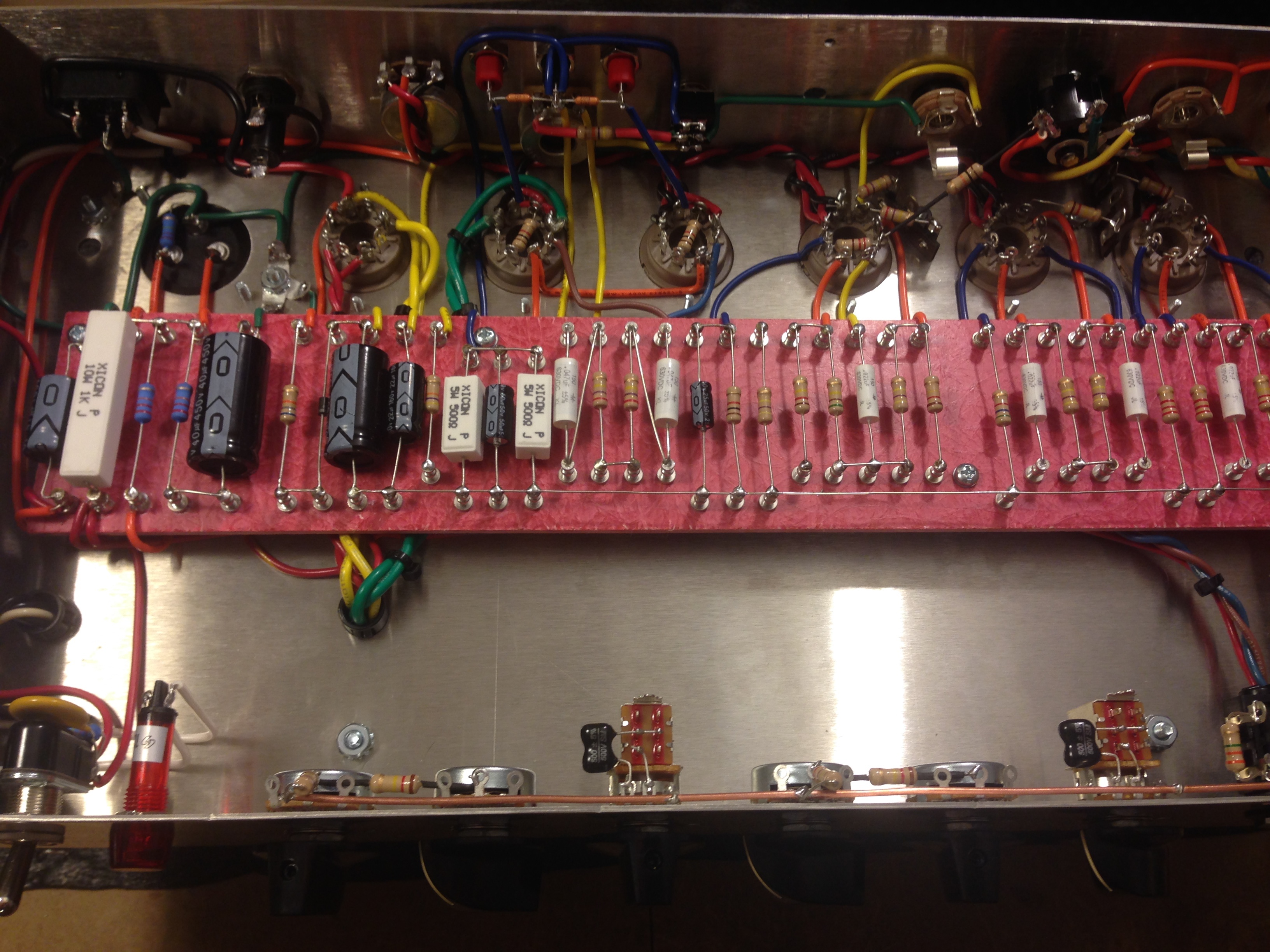

PostPosted: Sat Apr 25, 2015 9:53 am
Day 7 Tone Boards Installed. Input Jacks Built & Installed. Controls Connected with Coaxial / Shielded Cable.

PostPosted: Sat Apr 25, 2015 9:59 am
Start Up Day. Tweaked Bias Tail Resistor to 22K 1W to get proper range for both 6L6 & KT88/6550
Ran 6L6 in Cathode Bias mode and Fixed Biased Mode at 43 mA
Ran 6550 Cathode Bias mode and Fixed Biased Mode at 48 mA
