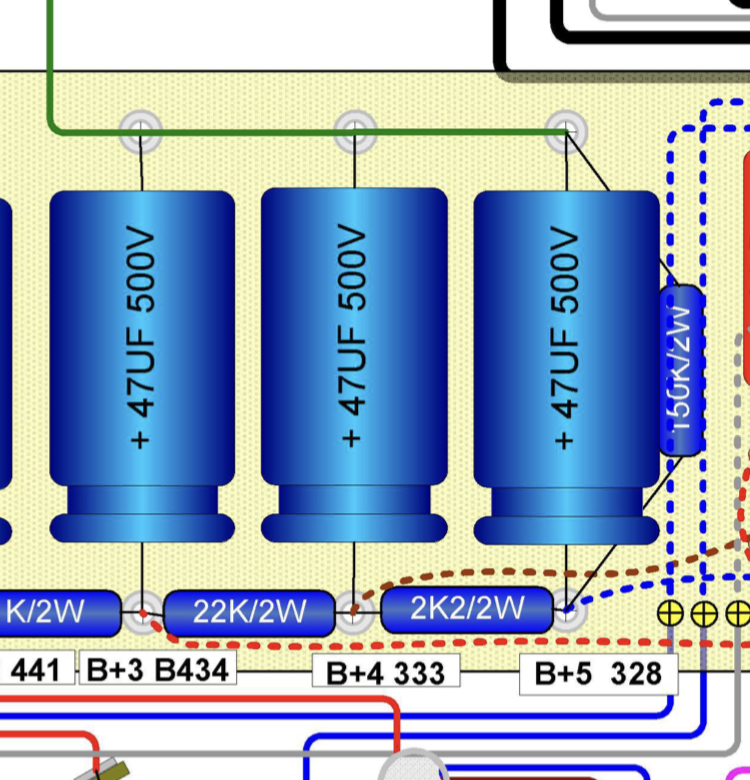

PostPosted: Wed Feb 17, 2021 12:13 am
Check the values of the resistors in the last two power supply nodes. Maa as jexsurecthey are wrll soldered in place.

19.9 and 2.0 left to right
I was so hoping you had found the problem. I just soldered them again, and the readings are the same.
