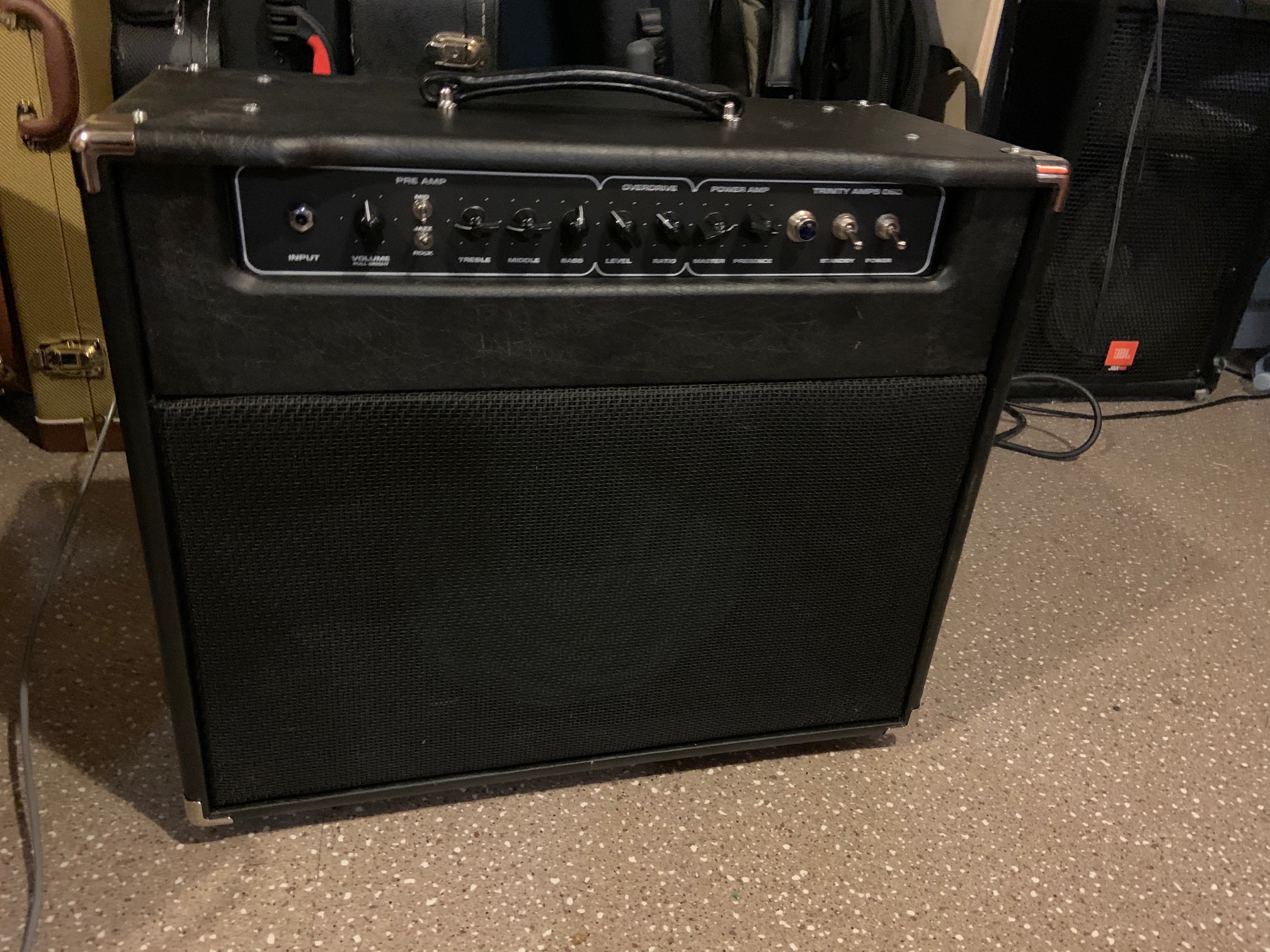

Well got it working after finding an issue with the layout that Stephen helped me work though. Still some low voltages but right now it just wants a guitar plugged into it. And just like the build there is so much more to learn about its operation. With every nob and switch playing off of each other creating a new cornucopia of tone. May need to tweak it a bit but best to work in and get to know my new girl friend:) hope my TC15 isn't jealous:)
But the OSD seems to be happy in its new home driving a 12" Eminence Cannabis Rex I had laying around.
