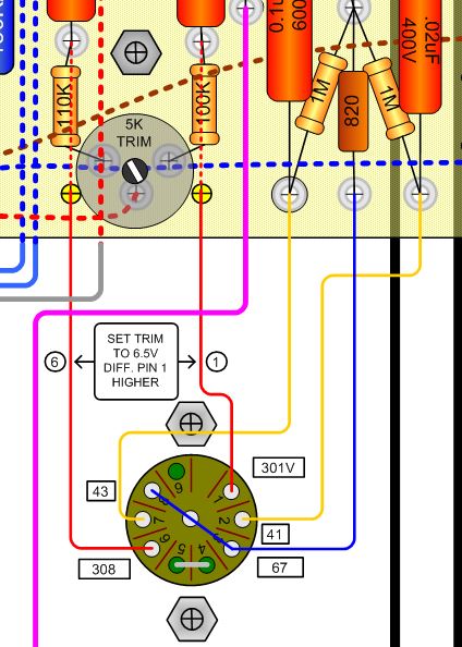

In the manual, we recommend setting the trim pot to the center position, but also talk about adjusting for maximum bloom. Here is a method for attainingthat.
Use an insulated adjustment tool and be very careful of high voltages.
The objective it to set the trimmer for a approximate 6.5 - 7 volt difference Pin 1 with the higher plate voltage.
Set the amp clean (no boost , no mid boost, no overdrive, no bright) with all the appropriate controls at noon.
Use a neutral sounding guitar on both pickups with it's volume(s) and tone(s) on 10. Without finger vibrato lay these single notes on the 3rd,4th,5th frets of the B string - a D, E flat E.
Let each ring out before playing the next one. In an ideal world they should all bloom equally. If the E blooms but not the D move the trimmer to make the input side lower by a half a volt.
Fine tune to taste by ear. Most of the time the 6.5V is good.
Another way is to set the trimmer at halfway as in manual, set up the controls as above, and then move it Clockwise / Anti-Clockwise looking from the rear, in small increments while strumming a chord with some nice harmonic content. See if there's a position that makes the chord and then notes ring longer/better. It's all pretty subjective.
