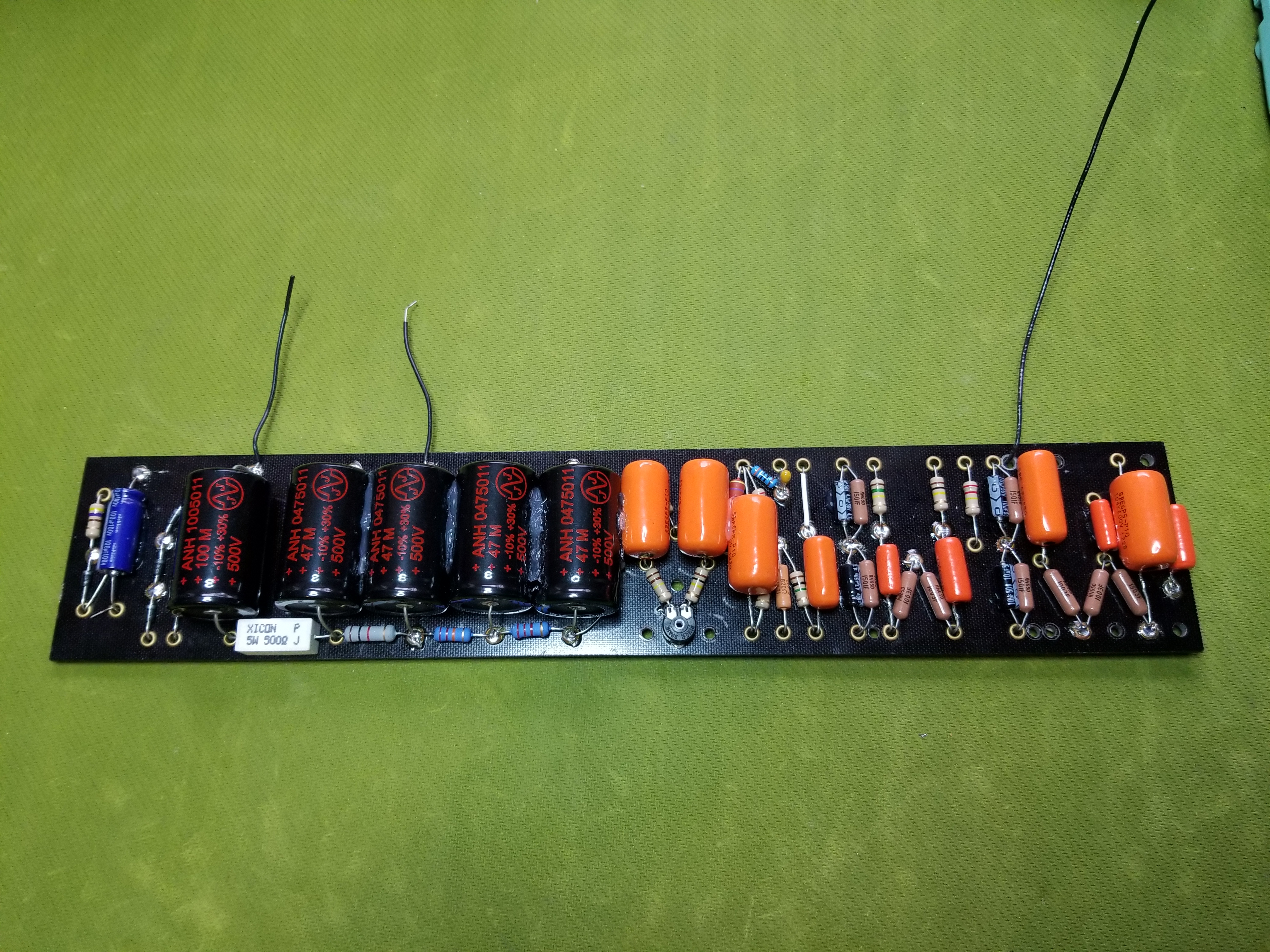

Here's more of the relays, main board, and chassis.
I haven't attached the leads to the board yet. The stuff you see on the capacitors is a silicon sealant that acts as a shock absorber since this chassis is eventually going to go into a combo cabinet. I don't want the speaker vibrations to cause too much stress to the solder joints or cause the power supply caps to rattle.
Today my goal is to wire up the PT and test the relays.
