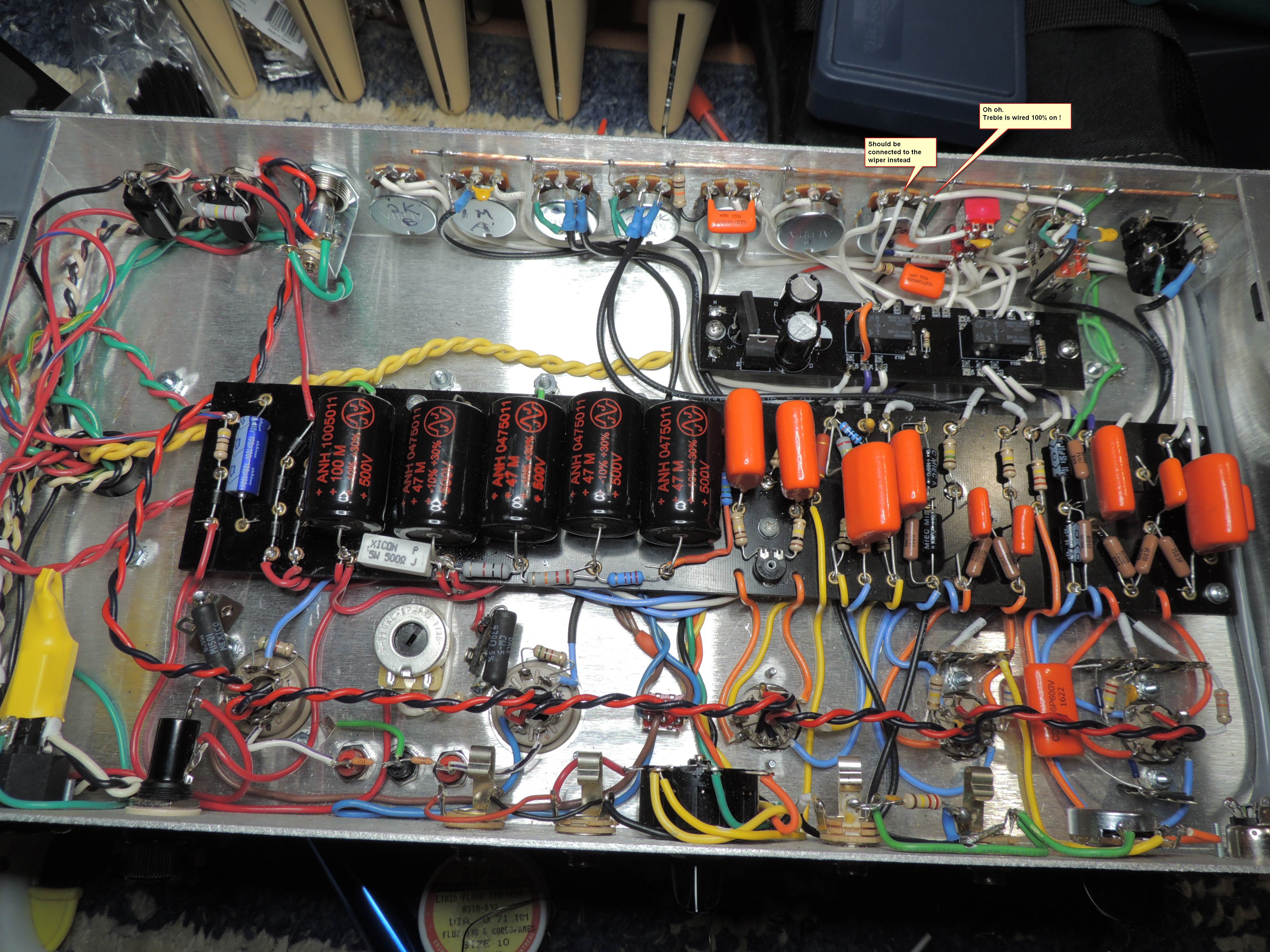

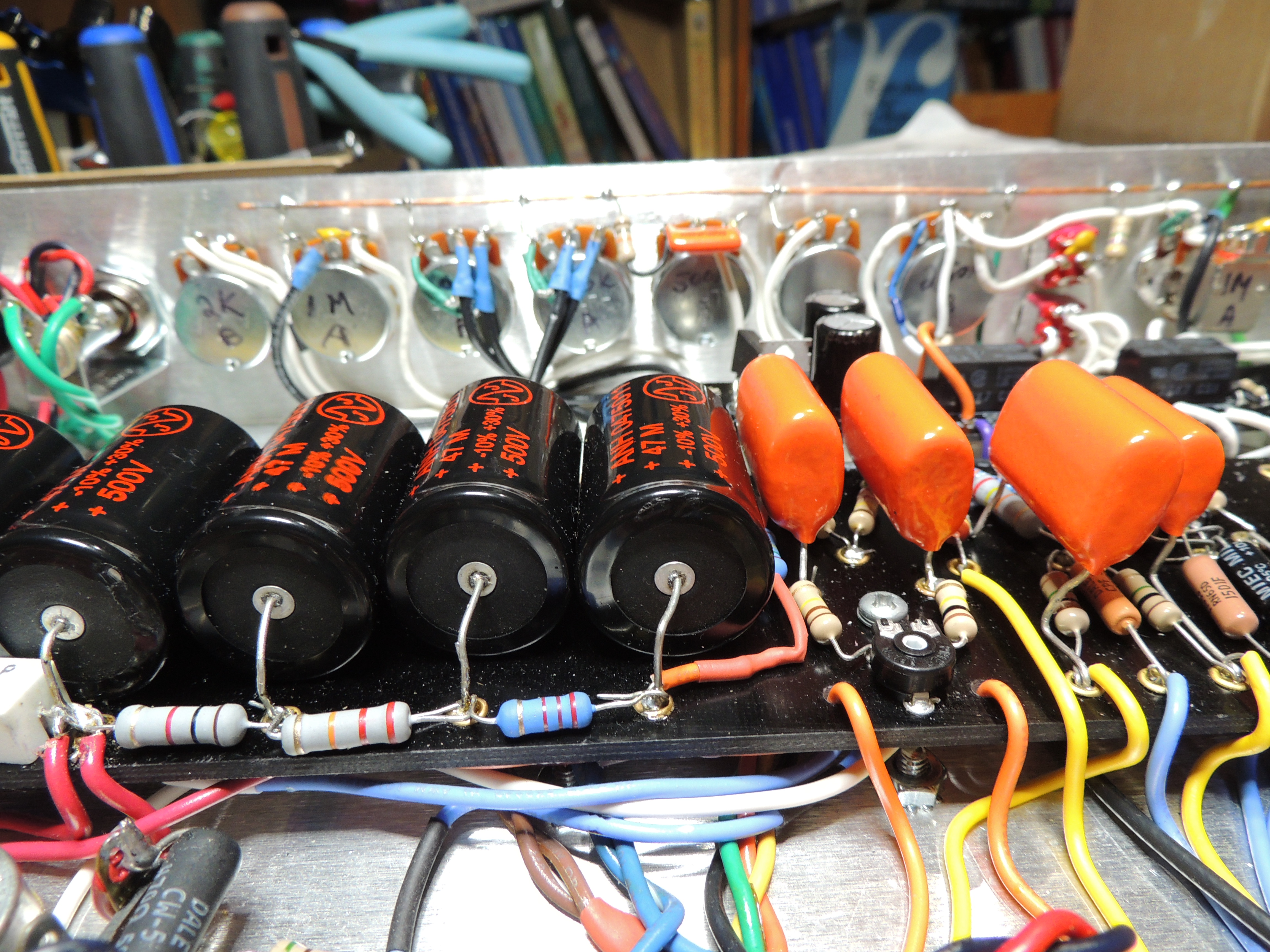

I checked resistance among all of the leads & wires at B+1. And I did the same for B+2 through B+5. Most are at 0.0 ohms, with only 1 or 2 at .1 ohms.
I even re-heated the eyelets and ensured good contact among leads at B+3 through B+5. No changes in voltages.
And attached are some photos.

They are low and it would be ideal if you could increase them. Can you confirm that you used the 120V connections and not 110 by accident. That would make a 10% difference.
I would like to know what the AC voltages are, no tubes installed (i.e. no load) .
Presumably when you back off on the bias, the DC voltages rise.
I just built an OSD and voltages were bang on so yours should be as well.
All that said, if you like it, it is good!

Looking at some of the solder joints at the eyelets (especially where there are multiple wires and components connected at an eyelet), it appears some component leads are wrapped around other leads and some eyelets are not completely filled, i.e the power resistors and 47uF capacitors. Also wiring leads (it's okay to leave SOME bare wire exposed) have the insulation very close to the eyelets. Consider reflowing and possibly adding solder to the joints AND having all component and wire leads inserted and soldered into the eyelets. I had problems :bugeye: with my (first) Tweed build due to unfilled eyelets and lugs. Had to remove leads, use the solder sucker, and resolder. One bad connection can lead to lots of problems. Best of luck and hoping you get your voltage issues resolved.

I removed the wires & leads from B+1 through B+5. Used the solder sucker. Then re-installed the wires & leads and re-soldered those 5 eyelets. (photo of the improved results attached).
I also re-flowed the solder in the eyelets with the 6 diodes on the left hand side. And re-soldered the red lead connecting the joined diode pair to the standby switch.
The voltages at B+1 through B+5 remained unchanged.
