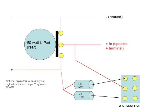

As far as switching in capacitors I sure would like to try that. Where does it go? From the input (+) terminal to the output (-) terminal? I've also heard of smaller values such as 2.2uF. Adding a switch for 16ohm would also greatly increase versitillity.

From 18 Watt site: One guy used switched non-polarized electrolytic caps in this configuration. You could dispense with the capacitor switch and just wire a 4.7uf cap straight from + to +Speaker. The "hotplate" inside the Univalve, BiValve is frequency compensated by a 2,2uF cap from input to wiper.
You could adapt it to yours.

Hey, thanks for the diagram. I remember seeing that before and I didn't really *get* it. But I do now. :oops:
