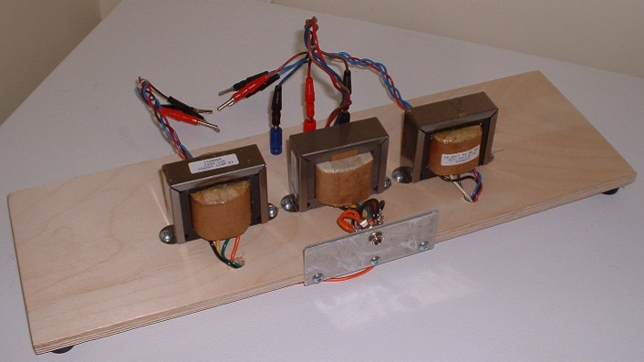

Here's a picture of the jig we made with the transformers mounted and ready to test. The amp is hooked up to the jig by way of 3 wires coming out from the inside. Then we plug in whichever transformer we want to listen to.
This give us the advantage of being able to A-B-C every easilty and make valid comparisons.

That's a cool way to compare. I'm glad to see some additional transformers.

Yeah, with the "Jig", it was really easy to detect even subtle differences. It only takes about 10 seconds to switch and the tubes don't even have time to cool off!
We are now trying to figure out the best way to get more player feedback on the sound quality.

Here are the comments on the Transformer testing we have done to date. This time we had Lawrence and Martin who has 35 years of Strats and Marshalls. Martin also makes a wicked JTM45.
It was a pleasure for me to listen to both of them play and in the end we had a clear, unanimous winner!
Method:
We used the transformer jig and with four (4) transformers to listen to.
Stephen changed the transformers while Martin and Lawrence played and we all listened - closely.
This was a blind test, only Stephen knew which one was plugged in at any given time and he recorded the results / comments. (see below) Amp controls were not changed once testing started.
Some results were recorded. Hope to post them if they come out OK.
It took a long time to settle in on the two best and then we focused on only them. It took some really serious picking and listening to get there but when we did it was - Wow - what a clear difference!!
All transformers sounded good, this was about picking the 'crème de la crème'!
Used:
> Guitars - Fender Stratocaster with rosewood neck; Historic Les Paul
> Speakers - Marshall 4 x12 cab loaded with 2 X Celestion Greenbacks and 2 x Tone Tubbies
> Amp - Trinity sIII with bridged inputs Power
> Transformer s2
> Pedals - none
> Trinity Amps transformer jig with 3 custom Heyboers and our standard s2
Conclusion (written independently by Martin Newall):
Of the 4 output trannies that were switched in and out of the jig there was one that stood head and shoulders above the rest. The resulting tone from this amp was without doubt THE quintessential early Marshall cranked tone to die for but with an added sweet, compressed, focused and beautiful complexity to the sound that will nail Stevie Ray, Mark Knopfler, Angus Young, Dave Gilmour, Vince Gill and beyond. (It's just a matter of guitar choice and where you set the vol pot...it's all there to explore!!)
Increasing pick pressure on the strings will accentuate the natural compression of the amp while still maintaining outstanding tone with no added fuzzies or buzzy artifacts riding on the signal. Rolling back on the vol pot will bring out the bell like qualities of the EL84 output tubes.
EDIT NOTE - the one that stood out was the Radio Spares Clone custom.
