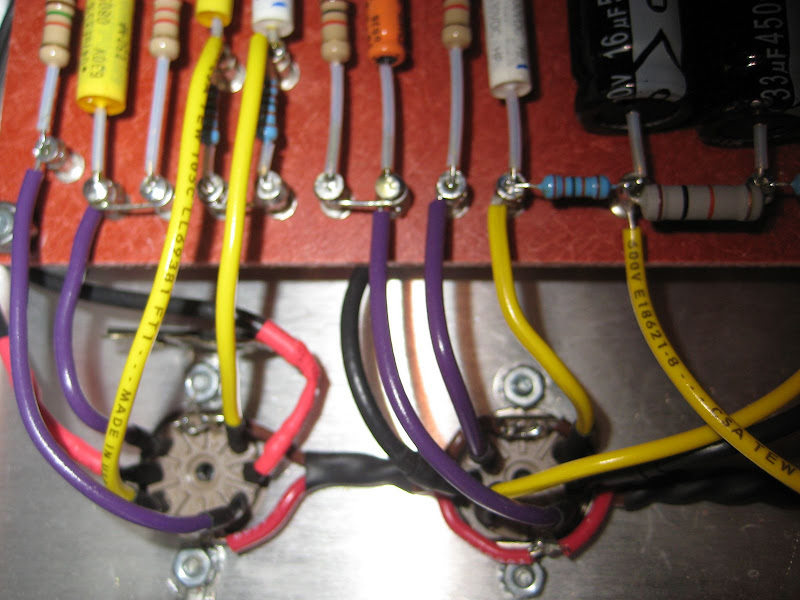

Try to keep grid wires as short as possible and grid stoppers as close to the tube as you can.

PostPosted: Mon Jan 25, 2016 8:49 pm
1. No, the B+ is low impedance filtered DC. You should be fine but as always try to keep your lead dress neat.
2. Yes the preamp (signal) wires can pick up the 60Hz signals emanating from heaters. Normally you want the signal wires to lie flat along the chassis. In your case you probably want to take the wires straight from the turret to the connection points, keep the wires as short as possible. It won't look as pretty as standard lead dress but it will keep the signal wires away from the heaters.
This pic shows the direct connections. http://lh6.ggpht.com/_EJpKfY8EgW8/S4ShF ... G_0224.JPG Notice how the wires fly straight to the tube.
If you do get 60Hz hum injected into your signal wires it will be easy to diagnose. The hum will be constand "low" hum that doesnt change regardless of where the controls are set.
