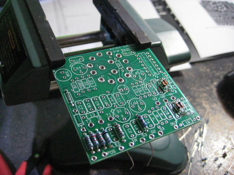

Getting started

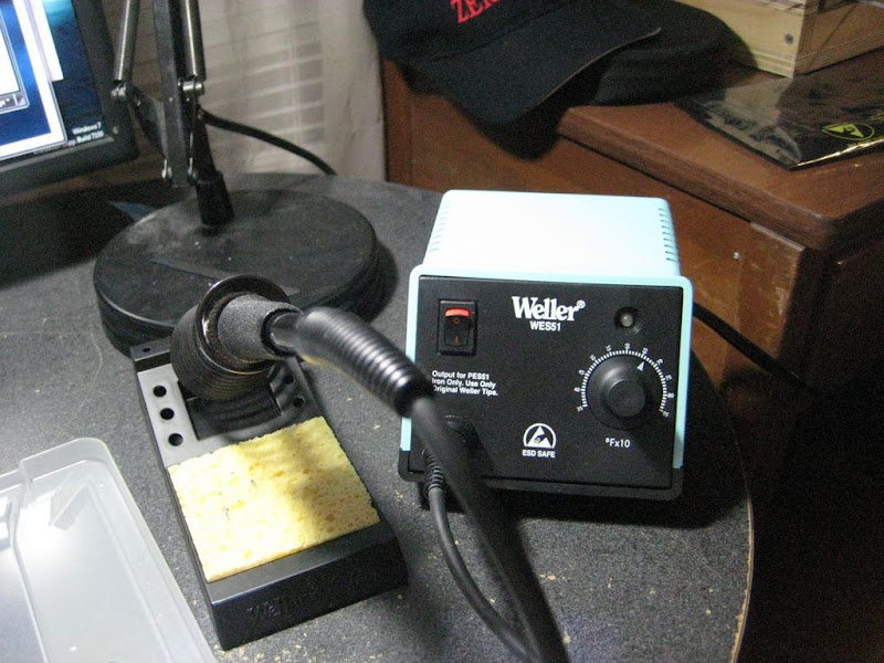

God gift to soldering. If your still making do with a Radio Shack stick, throw it in the trash and invest a bit. Your solder joints will thanks you

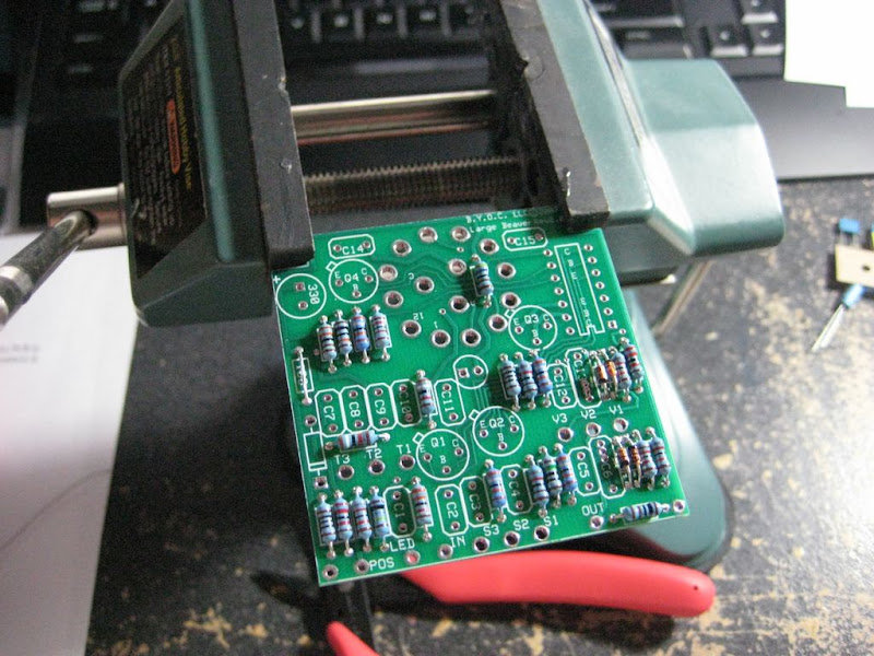

Resistors all finished! Moving on to the caps . . .

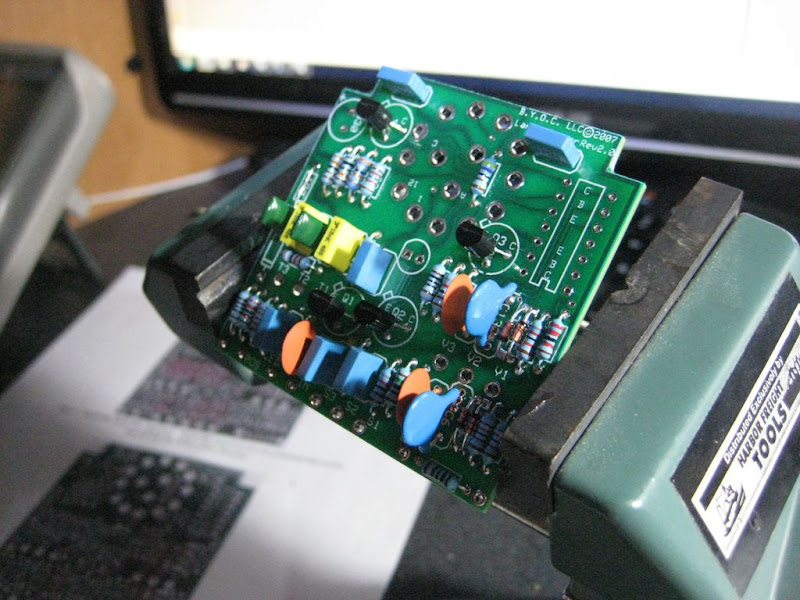

Almost done with the board

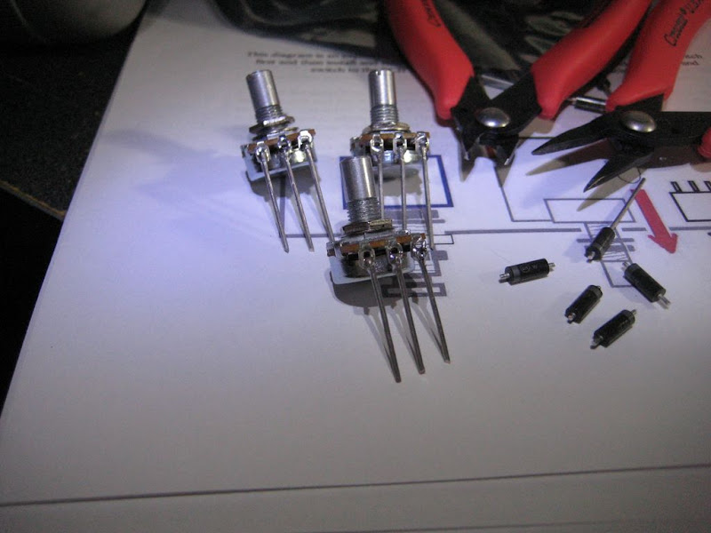

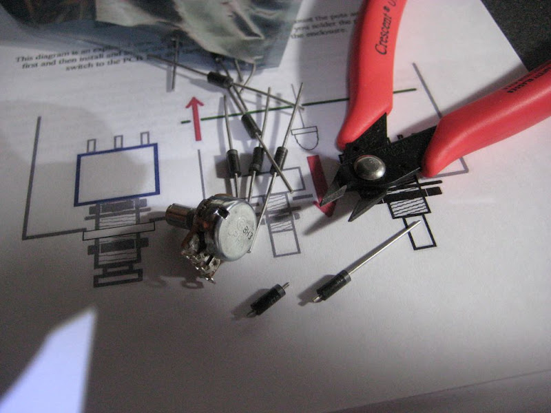

Many 5 watt Zeners gave there lives to this project. We will never forget them . . . .
Their sacrifice was not in vain . . .viola - PC mount pots with STRONG mount points

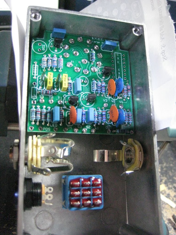

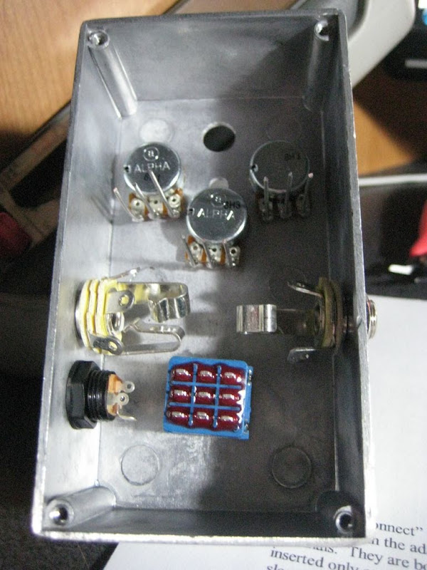

Getting the enclosure ready

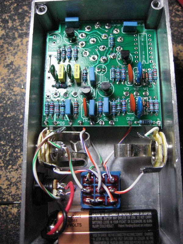

Board's in . . .
I used silver plated teflon that I have from wiring amps. Gotta love running the solder bead right up to the insulator with no melting. She's ready to rock now
