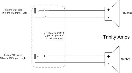

Both speakers are the same impedence 16 ohms a piece. If anyone has any advice on a switch, i.e. where to find one, or how to wire it, it would be greatly appriciated. :lol:

PostPosted: Sun Nov 09, 2008 11:19 am
This works. You can also do it with switched jacks in an elegant way but this works and is easy to understand.
