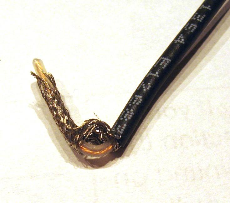

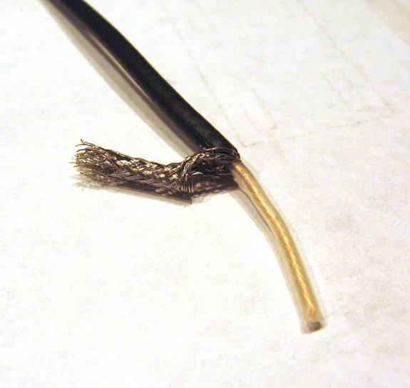

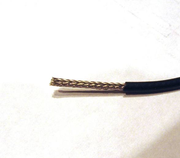

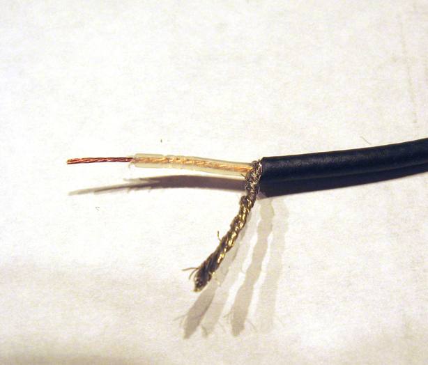

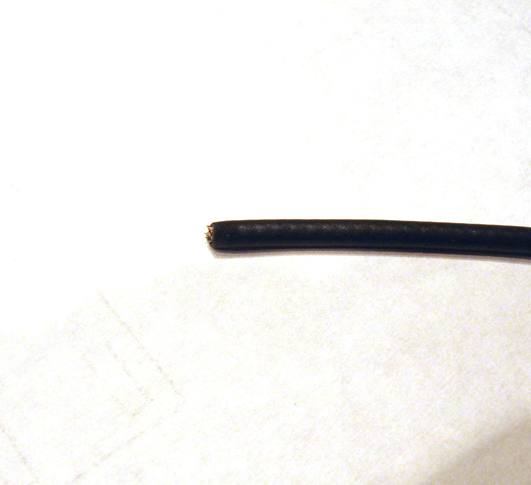

While it seems pretty natural to me, preparing co-ax cable can be a challenge. I hope this helps.
Plain Co-Ax cable
Strip about 3/4" outside insulator off on end and 1/2" off other end
Push metal braided sheath towards one end so it bulges out
Use a large needle or small jewller's screwdriver to poke a hole
through the bulging sheath and 'fish' enough so you can get pliers to grip the inside conductor
Use needle nose pliers to grip and pull the inside conductor through the hole you just made
Twist the braid into one strand and strip 1/4" off the inside conductor.

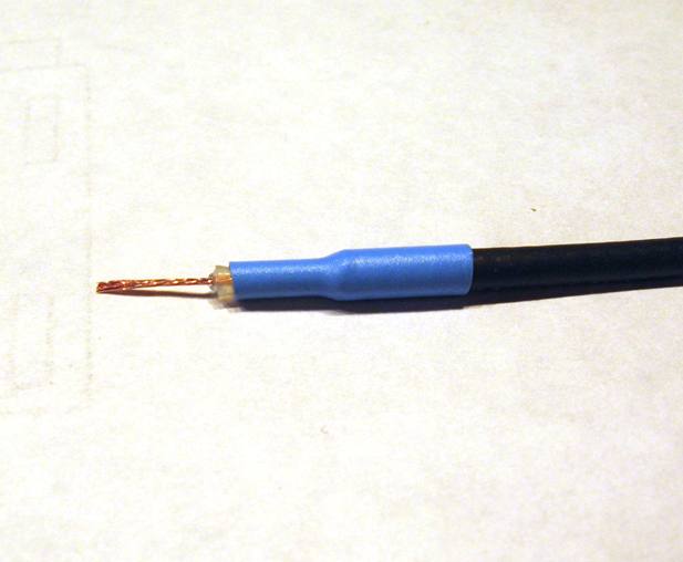

After you've prepared the oposite end, apply 1/2" of shrink tubing over the end of the cable.
My asumption was that the operation in all the original pics was to create a shield "wire" for the purpose of soldering it. This is what I assumed was in the first picture above. If that's the case, is the second picture supposed to be of the opposite side of the coax cable, showing how the braid is protected by the heat shrink? Or, is it the intent to show how you can REALLY move the heat shrink back if you follow all of the original operation pics and then snip off the braid before covering it with heat shrink?
I suppose it comes down to what you mean by "prepared" for the other end.
PostPosted: Thu Aug 11, 2011 7:05 pm
Posts: 126
The shield should only be connected to ground at one end of the cable.....typically at the jack or pot. The shrink tubing covers the exposed shield wires at the opposite end to prevent anything from contacting them & shorting to ground.
