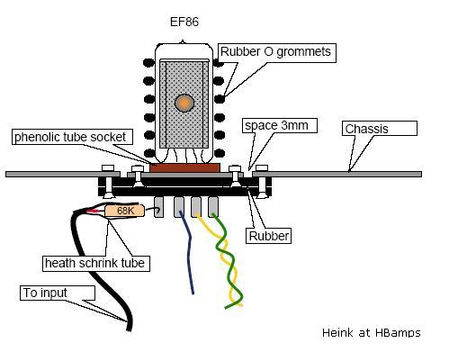

I just ran across this at 18watt.com. It was drawn by Heink at HBamps.
http://www.18watt.com/files/ef86_quiet.pdf
I'm pretty sure that you have to be logged in over there to view it.
LeeMo
PostPosted: Wed Dec 26, 2007 7:27 pm
Thanks LeeMo, that is very close to my previous posting about suspending the socket & holder on a neoprene square to provide isolation from the chassis, proving there is nothing new!
