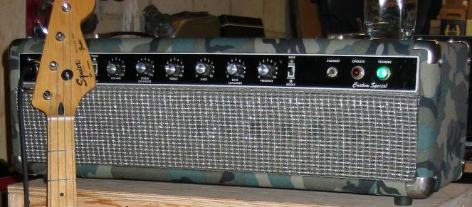

Here's mine:
You can see now why I'm calling it the "camo amp." Needless to say, this was not the original covering! I'll be recovering it eventually, in more respectable black tolex or similar.

History: the previous owner claims, and Coco has verified, that this very amp can be traced back (via serial number) to it's original purchase by JOHN LENNON (!!) during his stop in Toronto on his solo tour in 1970/71.

How does it sound?? AWESOME.
The camo amp and the new cab together are loud enough to be heard over Lbet and jhpatton both playing Trinity Amps' finest hardware turned up to 11. What did they have there Coco, a Trinity IIIs with 2x12, and a Trinity Lightning/Bomb pair?
Volume aside, the tone is SWEET! With the knobs cranked, there's lots of saturation and growl - I don't know if it's tube tone or speaker-motor saturation or both, but it's sweet. This rig howls. The cab seems to be able to take whatever the Traynor can put out.
Bass extension? Waaay better than my old combo! Playing an arpeggio down from mid- to low-E, only the last note or two are noticeably quieter - barely noticeable, that is. A little more finger stiffness brings those notes right up to level with the rest.
