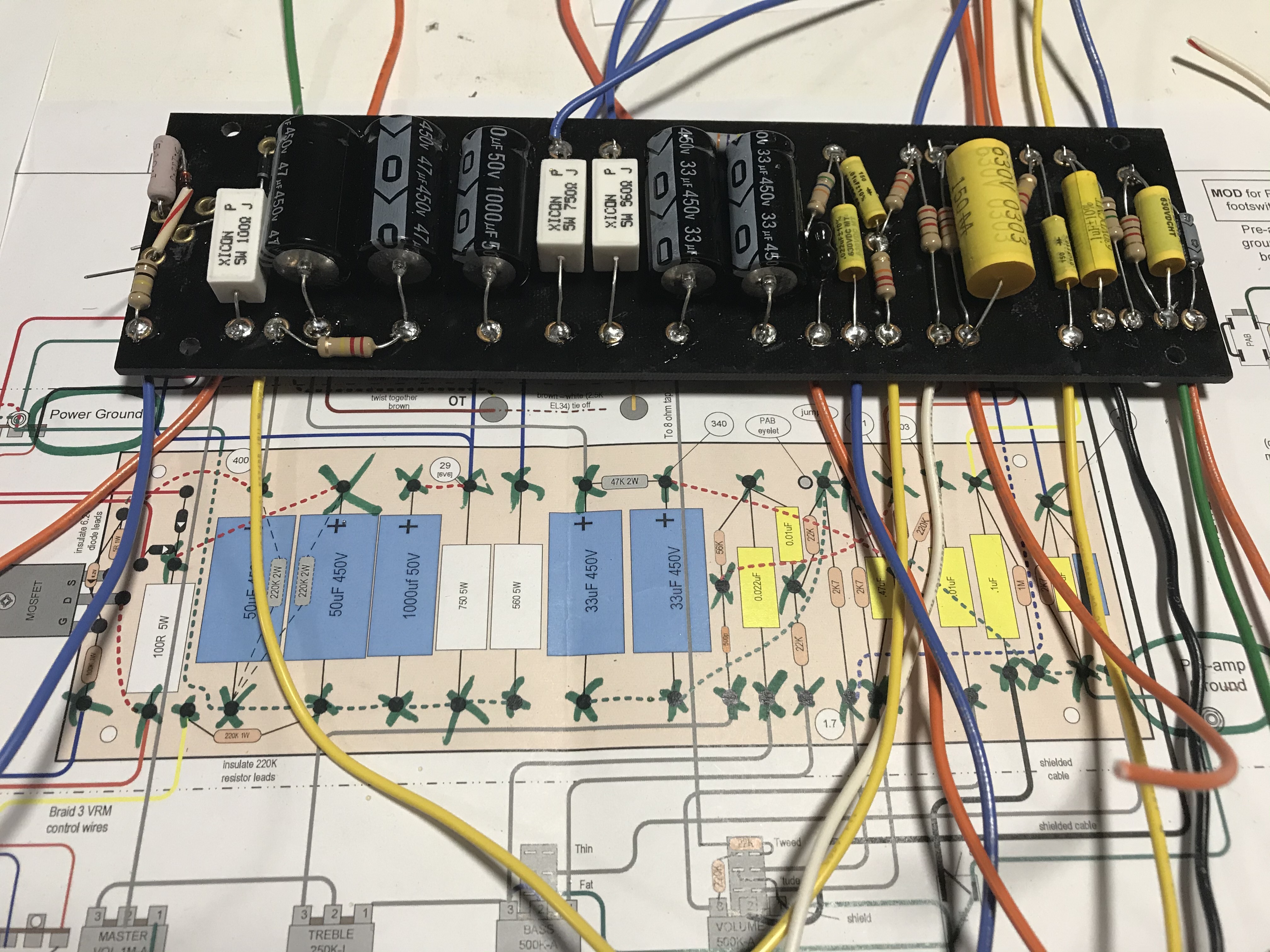

Finished the eyelet board this weekend.
File comment: Eyelet jumpers on the back
File comment: Top of Eyelet board with leads
File comment: Eyelet back, decided to put a couple resistors back there because they didn't fit so well on the top.
File comment: Mosfet side of the eyelet board
File comment: Right side of the eyelet board
File comment: Used 1/8" hardboard as a standoff for the ceramic resistors
