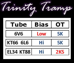

Tramp!! Plus, you can pull the Bass control knob out for Fat (used to be called Tweed) or in for Thin (formerly 'Tude)), built in VRM, Volume and Gain and if you make the some of the mods listed in Tone Tweaking you have a large choice of tubes. I like the EL 34. See attached file. I think Cheops created it.
