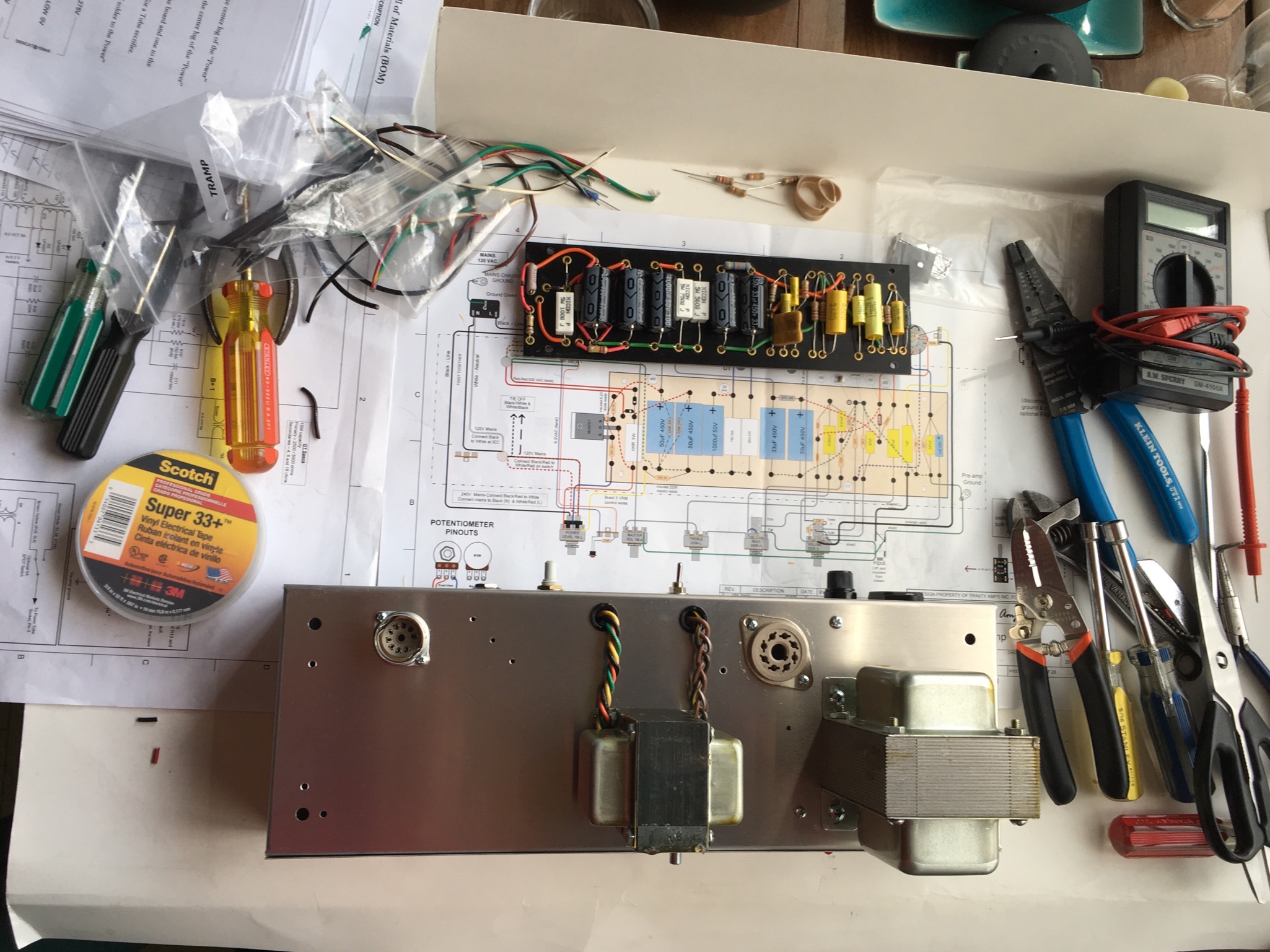

I took my time building this amp. As it was my first amp build. I used this as a model for studying amp design and operation. I had some preliminary study from Dave Hunter's "Guitar Amp Handbook". Plus years of internet and youtube research. As I assembled the Tramp I studied everything i was working on at the time, and if i didn't feel i fully understood it, i'd stop and hop on the web to figure it out. I decided to watch quite a few of Uncle Doug's youtube series on tube amps and that really helped clarify some of the mysteries of the vacuum tube for me.
I do have one question on the Tramp design i haven't figured out. Does the negative feedback in "tweed" mode only affect the preamp gain structure? Or does it clean up the power section as well? I'm trying to find the best setting for the least preamp distortion while heavily overdriving the power tube. I figure i'll get good results with the PAB as it is boosting post 12ax7. However I'm wondering if having the gain lower in tude mode vs gain higher in tweed would provide clean front end, dirty back end. Hence the question of where the negative feedback is functioning.
Anyways, The amp works! It also has virtually no noise floor. I did use a lot of shielded cable for the signal where possible (as i had a roll of it lying around), but with no comparison, i don't know how much noise i prevented.

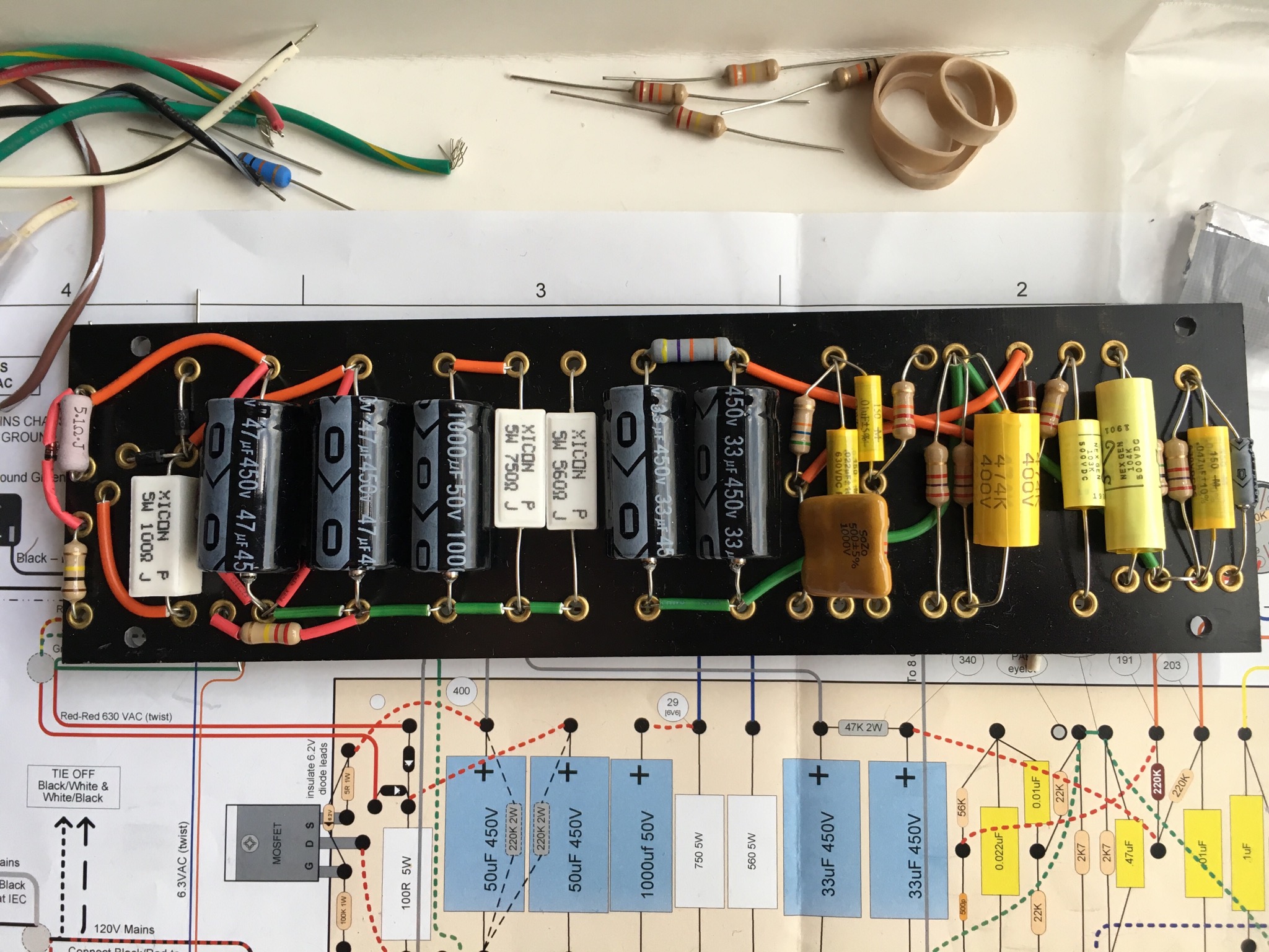

As you might notice. I decided to add just a little mojo that is probably near inaudible but it felt good to customize it a little changing the first 2 input coupling caps to Sozo nextgen mustard (same values). I also used their somewhat new Silver Mica cap for the the treble tone cap. Its pretty darn big rated at 1000v but it fit.
