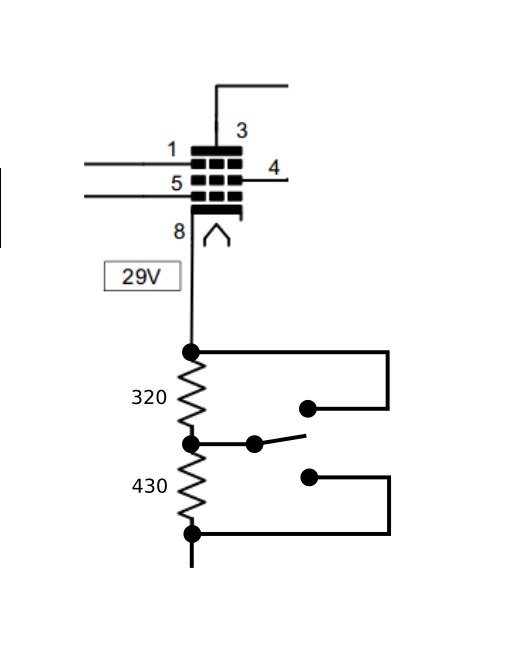

Regarding the cathode bias resistor value, I don't have any insights into how the different tubes will respond to the different resistor values. OTOH, I wonder if we could have all options at once... bear with me through the speculation below:
- In stock configuration, with S4 closed, the bias resistance looks to be 560 Ohms paralleled with 750 Ohms, which comes out to about 320 Ohms (note that 330 Ohms is a standard power resistor value).
- In modified configuration, with S4 closed, the bias resistance looks to be 1000 Ohms paralleled with 750 Ohms, which comes out to about 430 Ohms.
- In either configuration, with S4 open, the bias resistance is 750 Ohms.
By coincidence 330 and 430 sum to about 750. Seems like we could have all three bias options if we replaced the bias resistors with 330 Ohms and 430 Ohms, and wired them in series. Then we could swap S4 for an "on-off-on" type switch, connect its middle terminal to the junction between the 330 and 430 Ohm resistors, and connect its other two terminals at either end of the series combination. When S4 was in the center (off) position, we'd have the full 760 Ohm bias resistance. When switched up or down, it would effectively jumper out either the 330 Ohm resistor or the 430 Ohm resistor, leaving the bias at 430 Ohms or 330 Ohms. I'll try to attach a picture illustrating what I'm imagining.
File comment: Image illustrating the bias idea
It feels a little irresponsible speculating about this, given how green I am, and considering that I haven't tested anything. Please don't take my word for anything. Perhaps someone with more expertise will chime in...

Your bias switch idea would work, too. It's a good way to get the three resistor values. The voltage and current at the cathode are low, so you wouldn't need a huge switch.

Lighthouse, I like your bias switch idea! I was thinking about a switch but one that you parallel either a 560 or 1k resistor with the 750 ohm resistor. End result would be the same but yours can be done with one switch and the existing eyelets on the board. Thanks!
