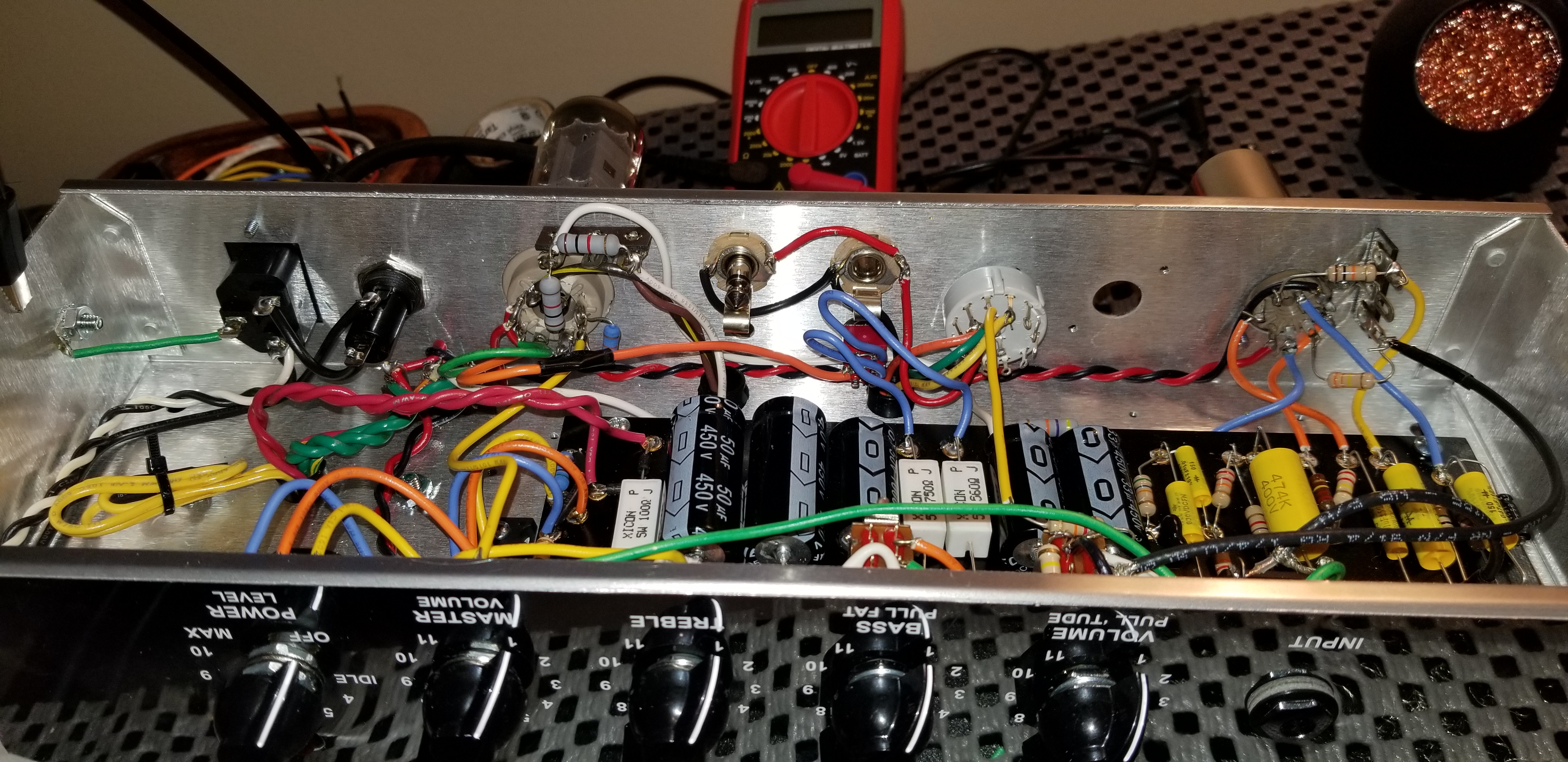

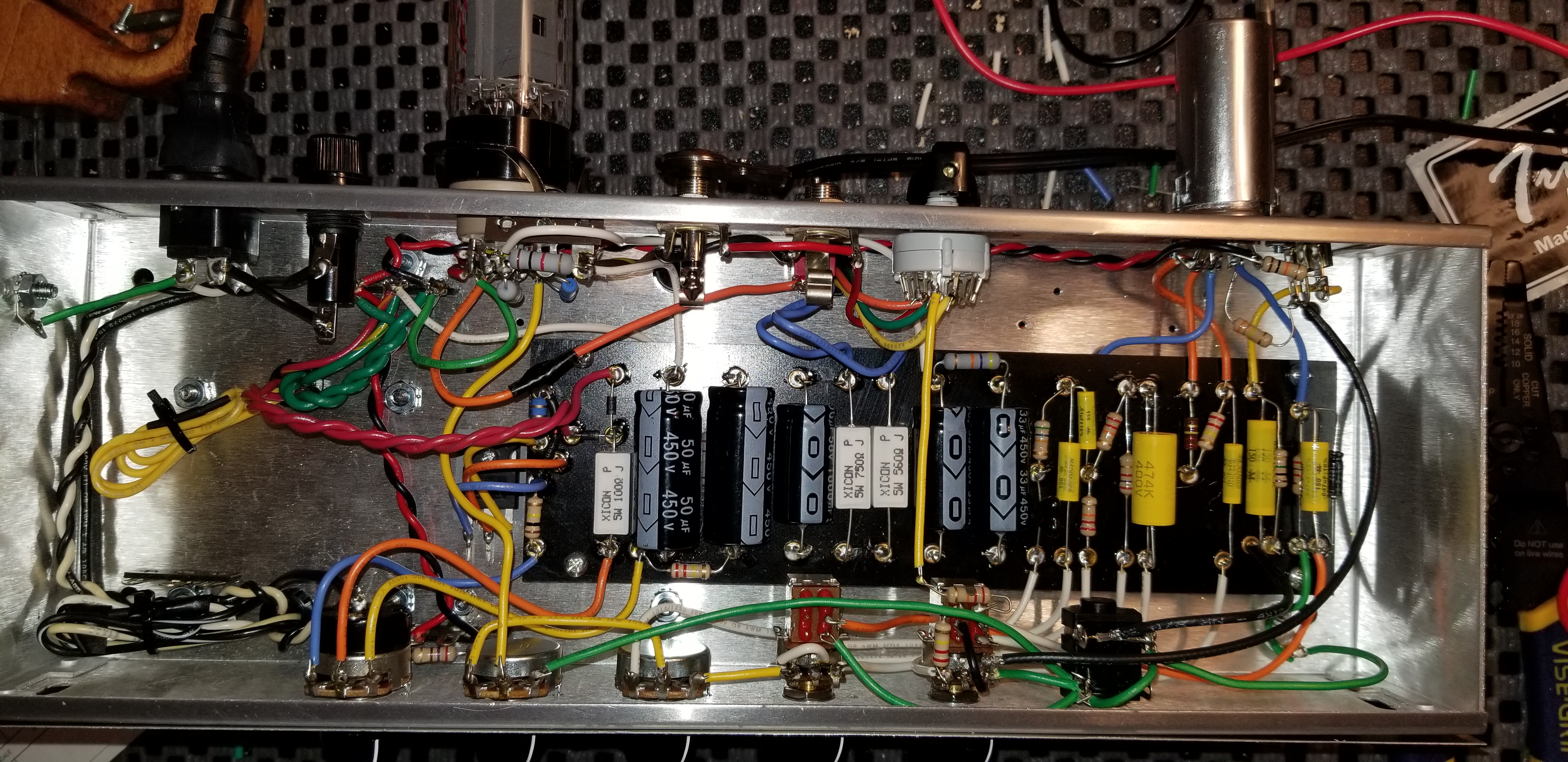

Well I checked everything out and as far as I can tell the connections are solid. I'm not sure how to check if the MOSFET has been grounded to drain (sorry, I'm very new to amp building)? I went ahead and attached the rest of the voltage readings and a few pictures of the amp. I can definitely get some closer images if necessary. Thanks again for the help.

Yes, I see now in your picture you had the wires reversed on pins 2 and 3 on the Power Level pot. That wouldn't cause any harm because of the 220k resistor running from pin 1 on the pot to ground. But as you experienced, as far as the Mosfet was concerned it would be like the pot was up full all the time.
It's easy to miss things like that when checking the wiring, no matter how many times you do it. A second set of eyes is definitely helpful.
