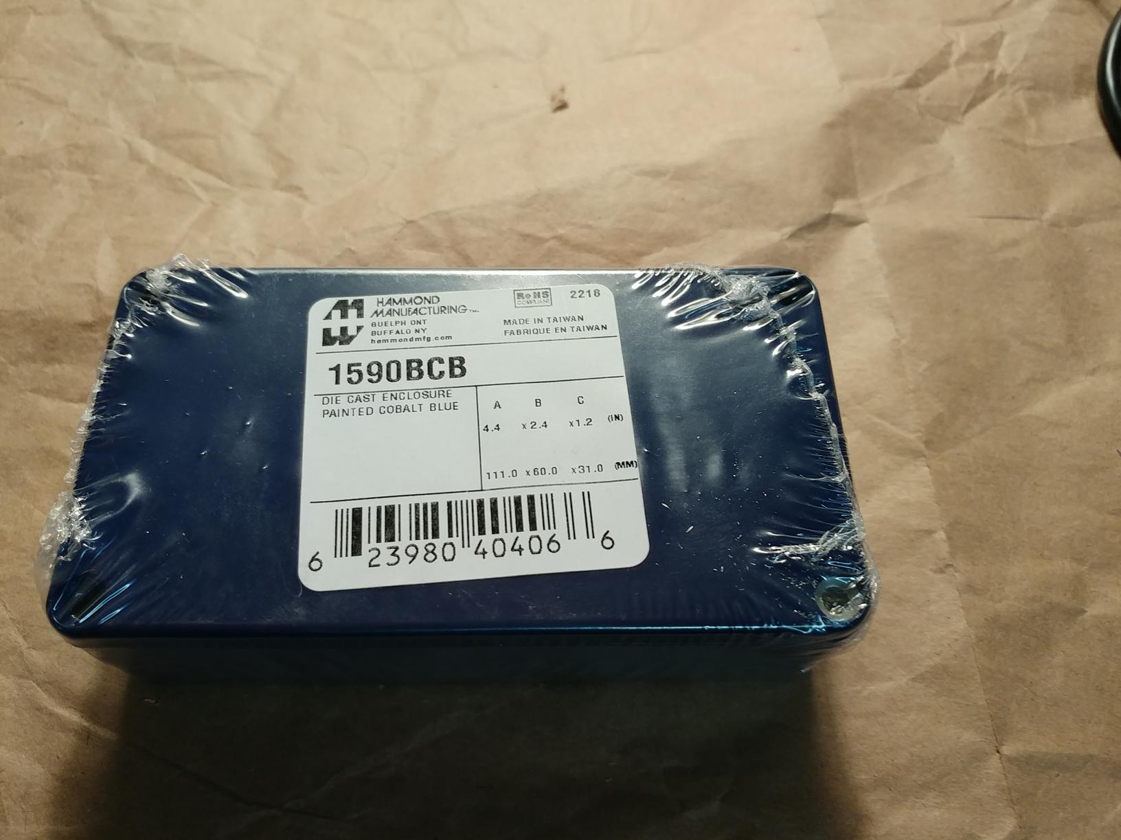

where all of the shields and the scope ground are tied to an aluminum case. I had this project box on hand. It's aluminum, and about the right size, so I used it.
File comment: 4.4" x 2.4" x 1.2" project box
I put the hole for the switch and the holes for wires on opposite ends of the box, so I can work the switch without getting too close to the capacitor and oscilloscope probes.
