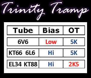

Draw an imaginary line from toggle of switch thru the switch to the terminals. For 6V6 operation the line should point to empty, unused terminals. For 6L6 the imaginary line should go thru the terminals that are wired to the 560R (or 1K) resistor. So, yes you are correct. I found this file somewhere on the forum and saved it, and am going to put it somewhere on my bad girl.
