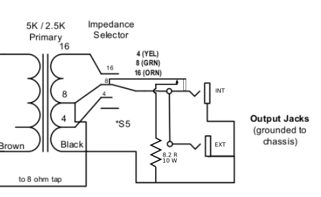

Starting small, my first modification is a safety resistor to prevent damage if I forget to plug the speaker in. Here's what I did:
File comment: This requires a power resistor and a shunt-tip output jack.
The idea is that if the speaker is unplugged, the shunt tip in the output jack connects a resistor in its place. The resistor is downstream of the impedance selector switch, so it's only a good impedance match when you're on the 8 Ohm setting. I decided that putting it upstream of the switch wasn't worth the extra complexity. For completeness, here's what I think the "upstream" version of the circuit would look like:

Please ignore the fact that I drew a trace right through the middle of the impedance selector switch on this second schematic.
The 8.2 Ohm, 10W power resistor came from mouser.com. I had the replacement output jack lying around the shop, so I'm not sure where I got it.
