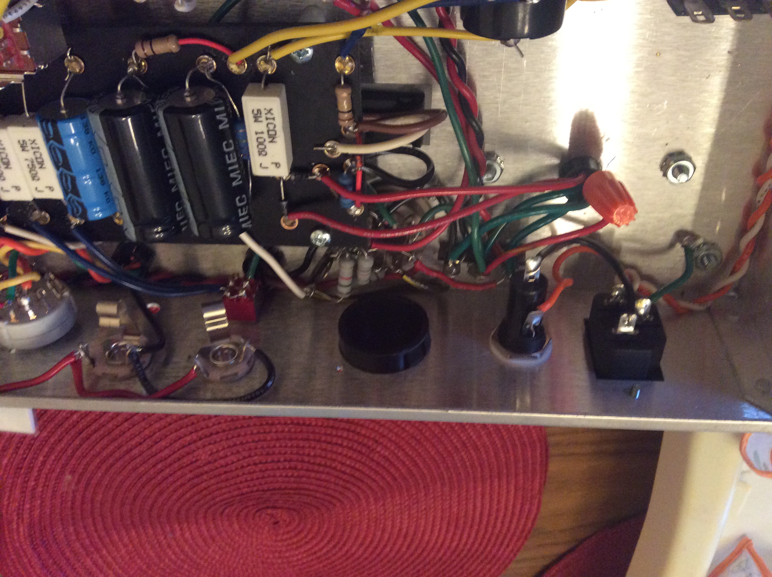

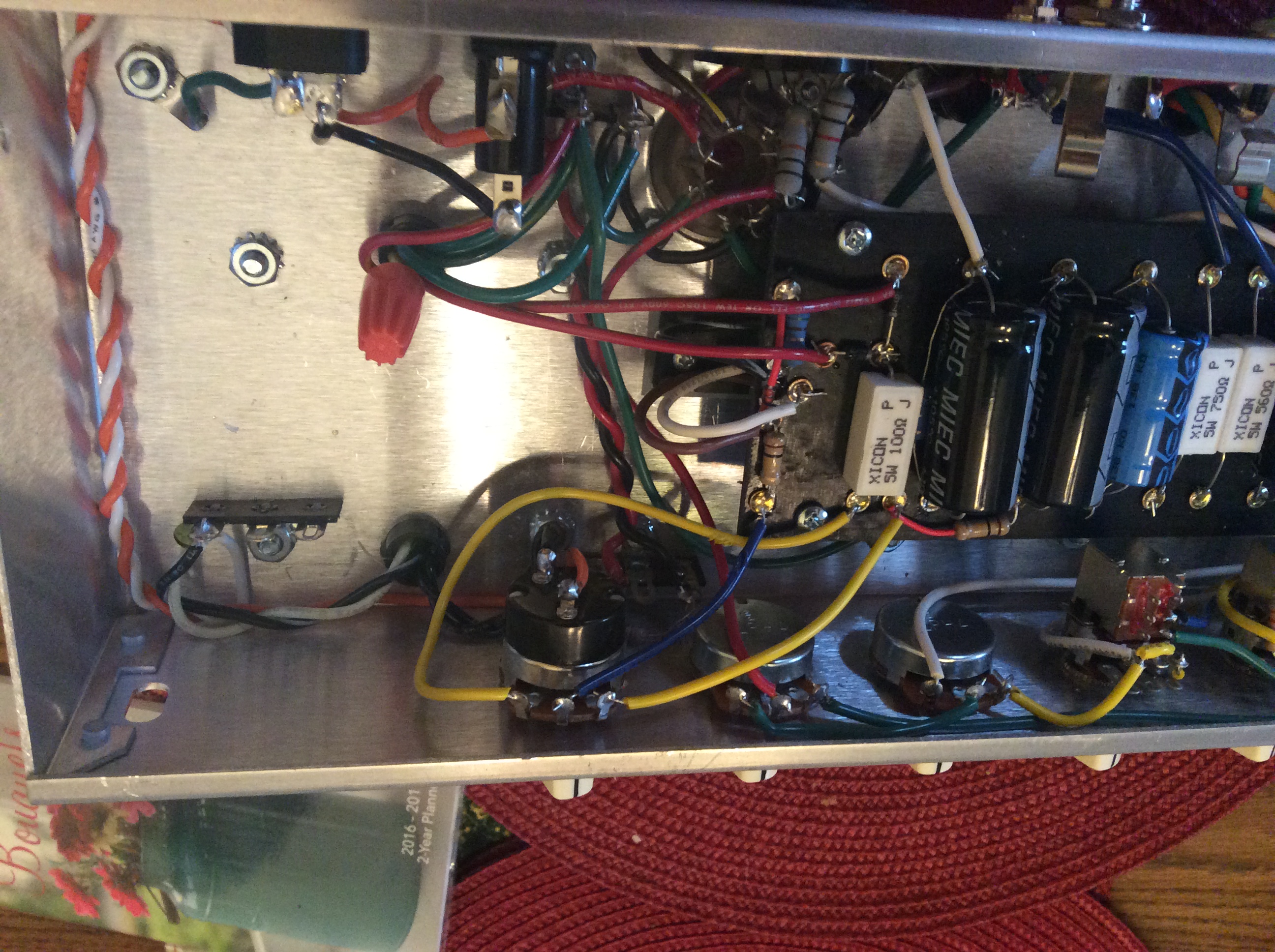

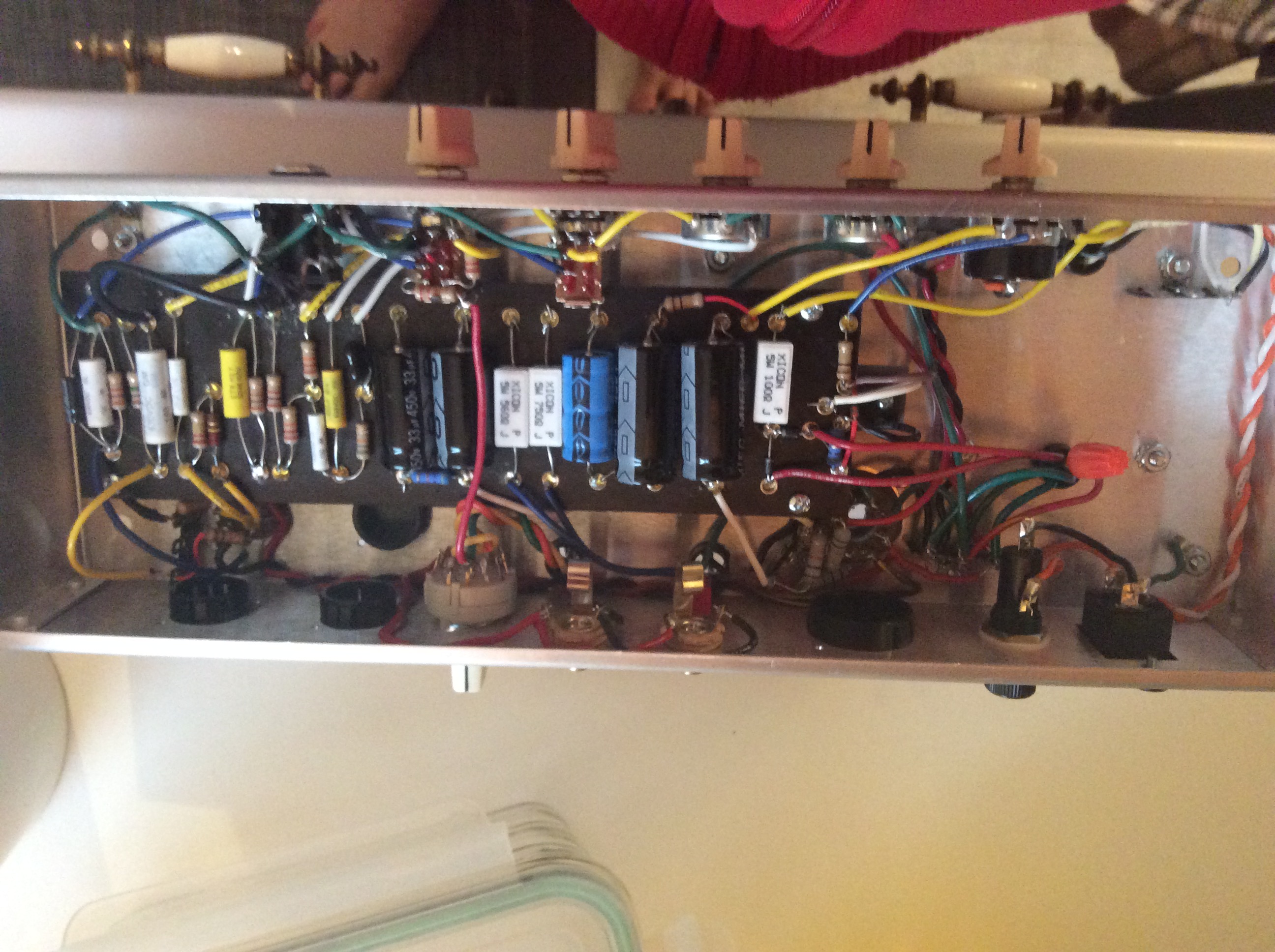

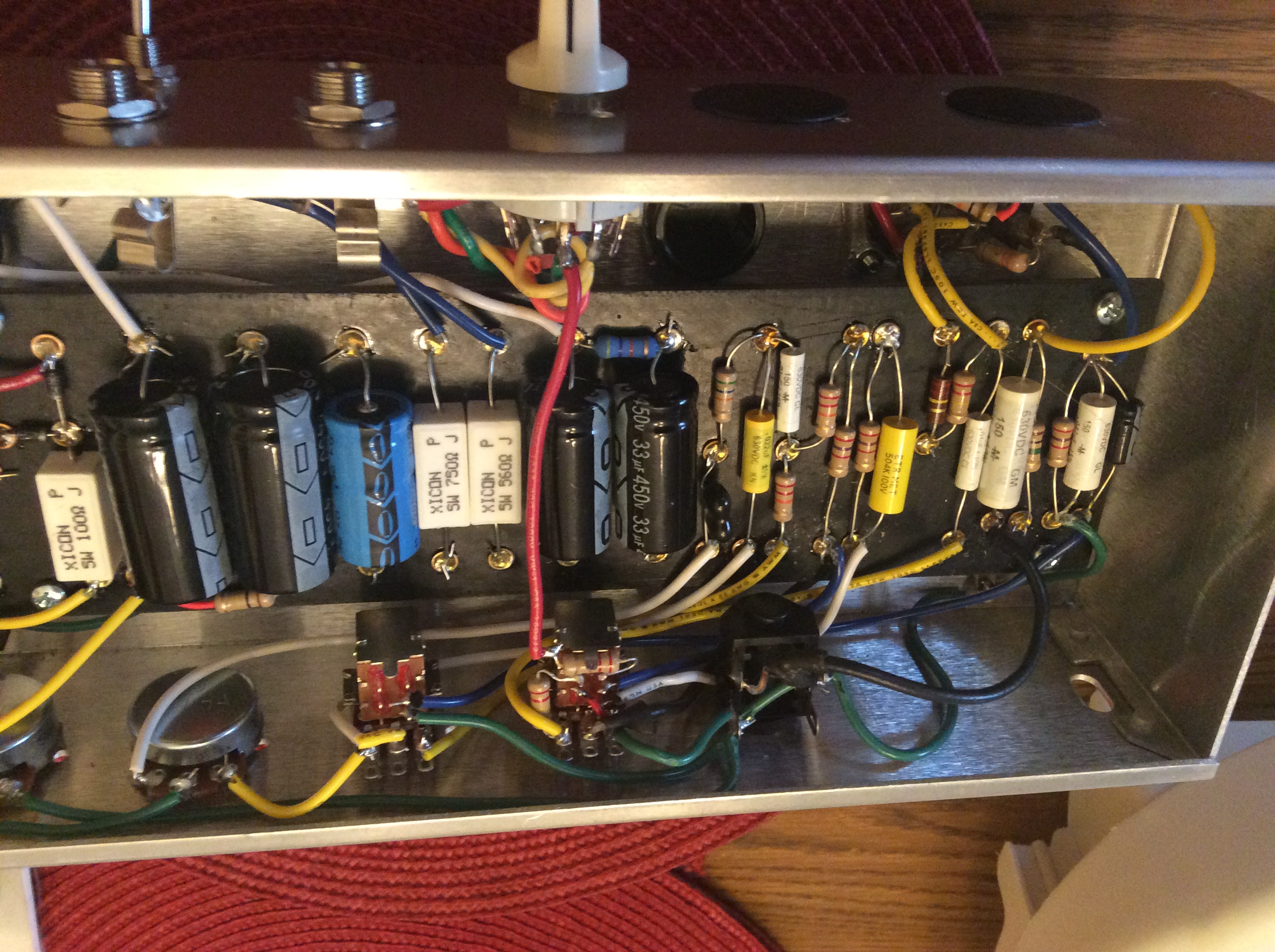

Hey guys I am new to the forum and amp building as well with only a trifly under my belt so far. Build seemed to go well and the readings looked good but I have no sound. Went through it a couple of times and redid my volume and input and all the shielded cable, gave pins 5 and 6 of the output and 1 and 6 of the preamps a light tap when everything is on and there is a pop coming out of the speaker then but no sound from the guitar, any suggestions?
Here are my readings and a few pics:
Rectifier Pins: 649 VAC
Cap 2: 439 to 442 VDC
Cap1: 44 to 437 VDC (moving VRM from low to high)
Power tube heaters: 6.95 VAC
Pre Amp heaters: 6.96 VAC

Check you preamp and power amp board grounds. You have no current through the power tube so no womder its not making any noise. What are the pin voltages on the cathode pins of the preamp tube? These would normally be around 1VDC range.

Your 6V6 is very under biased at 20v. should be closer to 29. did you get the bias resistors in correctly and switched correctly?

Reflow ypur power amp grpund at the board and chassis.
