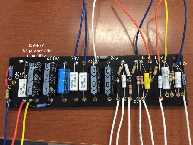

I’m not getting 340v @ r10 & c6. First off, I get 400v on the left side of the resistor coming from the OT & power tube. On the right side of the resistor, my voltage starts around 270v then drops continuously to 24v. I only get 6.5v @ pins 1 & 6 on the preamp tube. I get 1.7v @ pin 3, but 0 @ pin 8.
I've attached a pic of the turret board with voltages to clarify what I’m taking about.
Voltages with 6v6 & vrm @ 400v:
@ fuse - 123.9vac
heater wires to ground (pin 2 & 7 power tube, pin 5 & 9 preamp) - all are 4.1v ac
diodes - 377v & 380v
vrm power cap:
@ idle - 87v
@ 5 - 158v
@ max - 467v
While checking the voltages I tapped the pins on the power & preamp tubes & heard pops from the speaker, but with the odd preamp voltages I never plugged a guitar in.

Looks like way to much of a voltage drop across the 47k resistor between the two 33uf filter caps. The colour codes on the resistor looks right. Check to see where the jumpers under the board are correct from that point.
And do you have any pictures of the full build with board installed

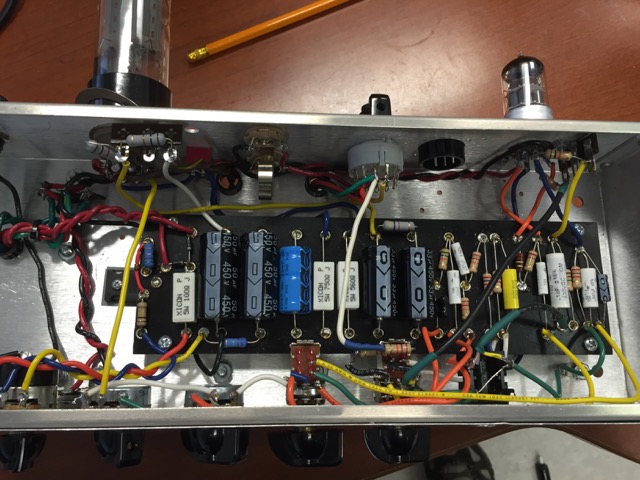

Here's some pics & a video demo.

I don't see the little jumper that is supposed to run between the grounded ends of R7 and R8 on the board (the two 2K7 resistors right beside each other). Maybe you put it on the bottom side of the board, but if it's missing C6 and C7 won't have grounds and none of the preamp power supply will work right.
Also, do a continuity check with your ohm meter to make sure that everything that is supposed to be grounded actually is.

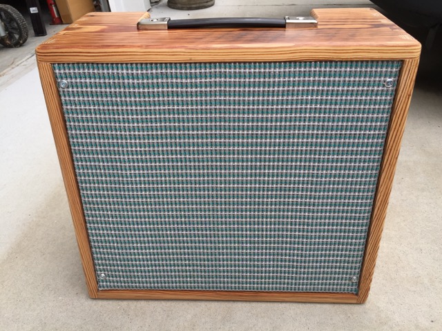

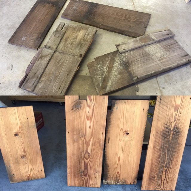

So I took some time off, & built a cabinet. I got some “scrap wood” from my aunt (100 year old heart pine to woodworkers) & threw this together.

That cabinet looks really good. Great to give that 100-year-old pine a new life in a neat project.

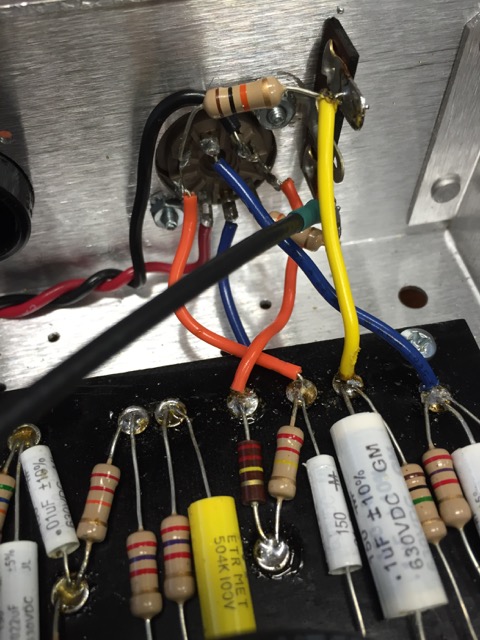

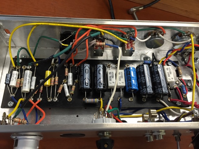

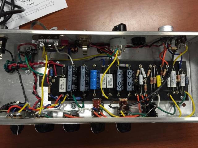

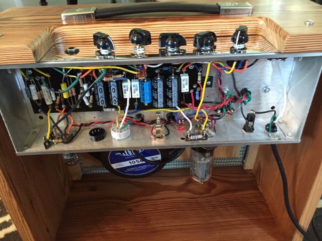

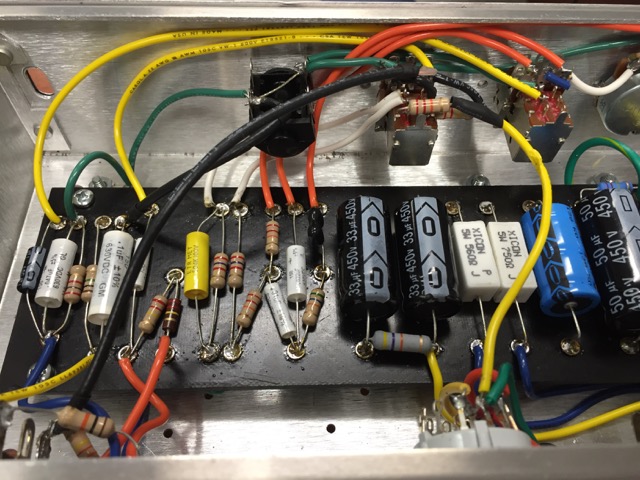

Everything sounds great, voltages are good, but I've got that squeal problem with the vrm & master volume maxed, & the volume above 8. I've read this is a lead dress issue & I've included pics, to maybe get some feedback on what to move or change.

Thanks for compliments about the cabinet mitch, I'm totally stoked with it! Oh, & thanks for the plans Stephen, they made it very easy!

Glad the amp is almost fixed. Try moving wires around with a chopstick or a similar wooden stick while the amp is squealing to see if you can reduce the squeal. Do you get the squeal in both settings of the Tweed/'Tude switch?

It's just in the 'tude mode. Sounds fine with everything maxed in the tweed mode.
I'll try some chop sticks & see what happens.
