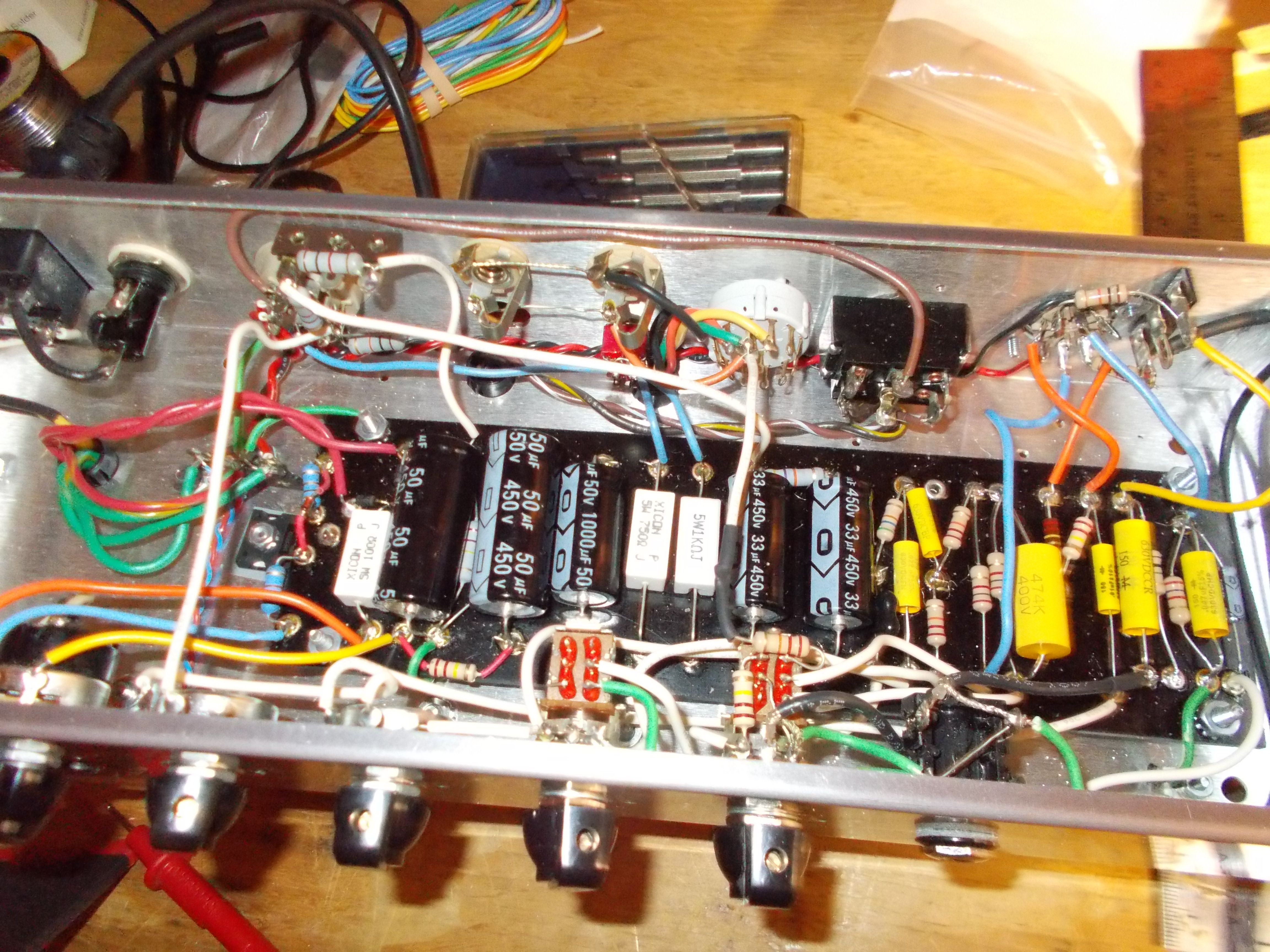

Here are pictures of the Tramp Head Amp I am building. I would be interested to hear from anyone who would take a look and check for mistakes or errors in assembly. Thank you in advance!

Any and all comments welcome!
PostPosted: Wed Oct 21, 2020 2:38 pm
Hi Dan. Welcome to the fourm!
Looks good so far!
PostPosted: Wed Oct 21, 2020 11:56 pm
Looks good. The 220K metal oxide you used for the plate resistor will work but wasn't there a 220K carbon film?

Yep... There was a 220K carbon film resistor. However, I just did not know the difference between that and a MO resistor, at the time. I do now! :-) It has been a good learning experience.
Thank you for pointing that out.

Dan, did you insulate the bias switch. If not keep an eye on it. Some people have reported an arcing issue running the amp at high power. That said, I've built two and though I don't play, people that do love it!

Hi Hank! No, I did not insulate the bias switch. At one time, I DID hear a little popping when the gain was high and the amp was breaking up nicely. However, the popping stopped when the gain was down and the signal clean. I tried to replicate that to track the problem down, and it went away. Maybe the popping was the arcing you mentioned. How do I insulate the bias switch?

Dan, Check page2 of Tramp forum, read the fourth post from bottom ("OT Impedance Switch Arcing"). Arcing usually appears on the lugs of the switch, also the impedance switch on the OSD, too. I used the bigger switch in the spare hole on rear panel, but the liquid insulation seems to work also. Edit: There are other threads about the same issue in Tramp forum. I'm attaching a pic of how I did it. It's the big switch between output impedance switch and preamp socket. I see you got the head chassis, my builds were w/ combo chassis. ** My bad, bias switch NOT the problem, it's the output Xfmr impedance (load) switch that's the problem, put that in to run all 5 tubes and changed the 560 ohm cement resistor to a 1K per Coco's info on running EL34 and KT88's :bugeye: If you didn't put in the "load" switch, ignore my :chatter: ramblings!
