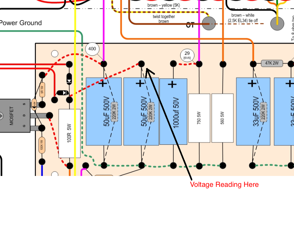

It's actually not the B+ voltage I'm referring to (correct me if I'm wrong)...the other filter cap connected directly to the rectifier diodes. I've attached a picture to illustrate the location.

What are your voltages measured where on the layout says 400 I.e. B+. ?
In my previous post I included my B+ (measured at the 400 on the layout). They look to be alright.
