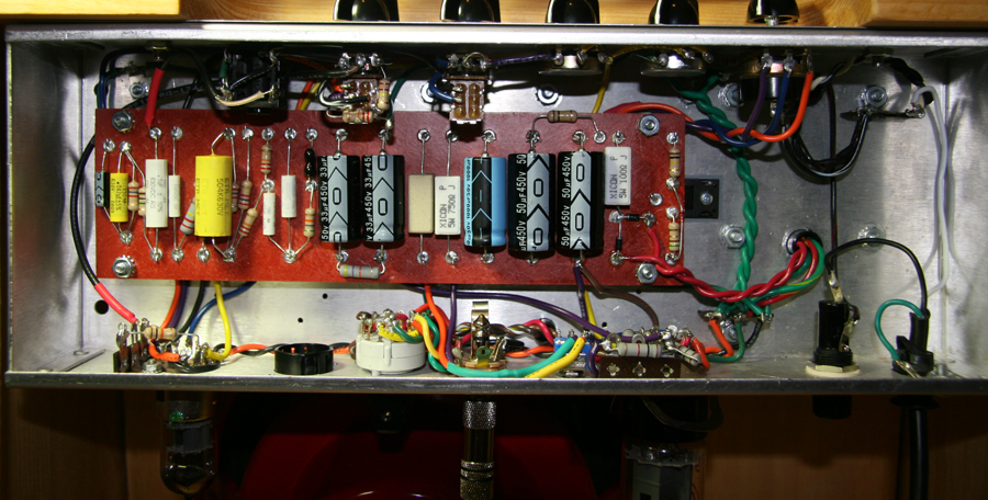

I started my Tramp build a year ago only to be temporarily relocated and had leave it behind. I regularly read this forum while I was gone and looked forward to the day I would be able to finish the build. Well I'm back home and finished the amp (the cosmetic cabinet finishing is next). Unfortunately everything checked out fine with no tubes/load but after putting the tubes in most of readings were 30 VDC low (line voltage is through a step down transformer as I am in Hong Kong and is 110 VAC. There is no noise at all and the amp seems too quiet and stays clean when dimed out. The VRM seems to be working but with it at 100% (everything else at minimum the voltage is 373 the rest in order are 26.38, 310, 171.5, 169.3, 1.57, 1.5. Because time had passed, I downloaded the latest revision of the drawings to finish the amp. I thought it may have been an issue with the caps being reversed but they appear OK. Can anyone lead me in the right direction. I have triple checked everything and looked for cold solder joints.

Looking at the picture of your amp wiring, I did not see if the 22 K resistor of the volume pot is connected to the 8 ohm tap of the impedance switch.
Usually this connection is easy to see because it crosses over the component board. Maybe you routed it under the board?
I don't know what effect this connection would have if missing.

I returned from holiday and found a 220/117 VAC transformer (I could not find a 220/120 but I though this would be close enough). There was a slight improvement in volume but still too clean when dimed. In the process I noticed that the volume pot and the tude/tweed were having no effect. While checking everything again I noticed a discrepancy between the posted schematic and the layout I used - the schematic shows pin 1 of the preamp tube connected to C2; on the layout currently posted pin 6 is connected to C2. After going back to the original layout sent with the kit (which I did not use), it does match the schematic. Am I seeing things correctly and if so, which is correct? Any help would be appreciated.
 Post subject: Re: Low Voltages
PostPosted: Fri Jul 15, 2011 9:49 am
Can't really see by your pic but try swapping the wires on pins 1 and 6.
The layout in the Resource section is currently wrong. It needs those two pins switched.

Thanks Kurtlives - I swapped the leads on pins 1 and 6. Everything now appears to be working. After checking the dc voltages against the layout, with a line voltage of 116, I got 392.4, 28.16, 325.3, 168.6, 181.5, 1.7.2 and 1.7. Although there is some deviation at R4 and R9, it is still less than 5%. Considering the line voltage difference of more than 3%, is it safe to assume that these readings are ok? In addition, with everything dimed out, there is now noticeable hiss but it seems less than my other amps, with the possible exception of the AC4TV. I assume this is normal for a Tramp? I want to thank everyone for your kind assistance. It is early in the morning here in Hong Kong but I can not wait to give the Tramp a ride and wake up the neighbors.
