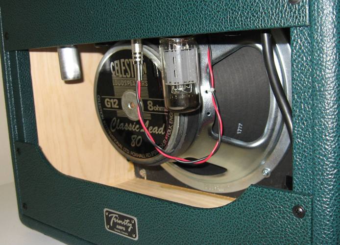

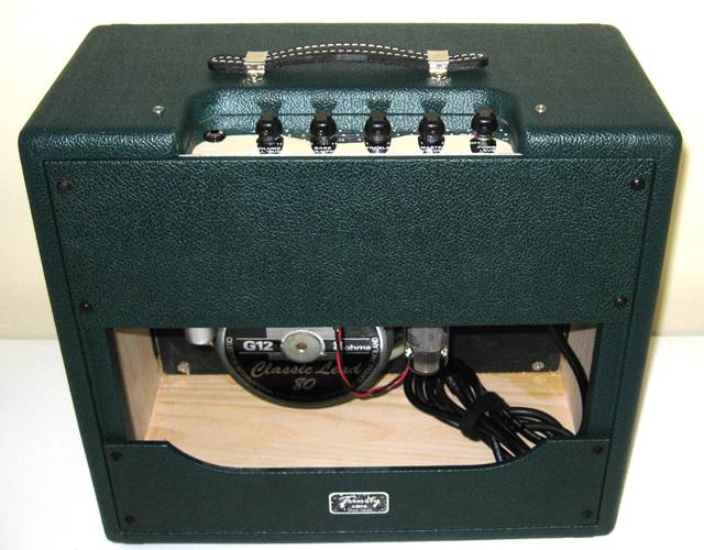

PostPosted: Fri Mar 09, 2018 12:15 pm
I checked and it was a Celestion Classic Lead 80. This is with a 6L6 as well. Some installations needed a right angle plug as I recall.
