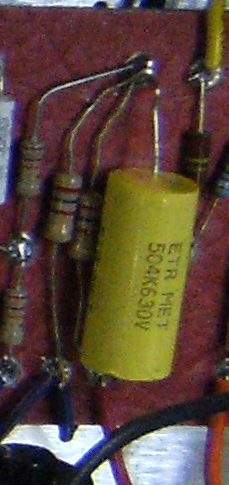

This is the one piece that I'm less-than-proud of in terms of my work.
I tried to keep all the leads nice and straight, but messed up the leads on the these resistors by trying to tweak and tune them too many times.
I know. It's silly, but I was doing pretty good up until that point.
This is also the "Monster" joint where many pieces come together in one eyelet. I wrapped some of the connections around the capacitor lead that was in place and it worked out well. Try and get the wrapas tight as possible for a good solid connection.

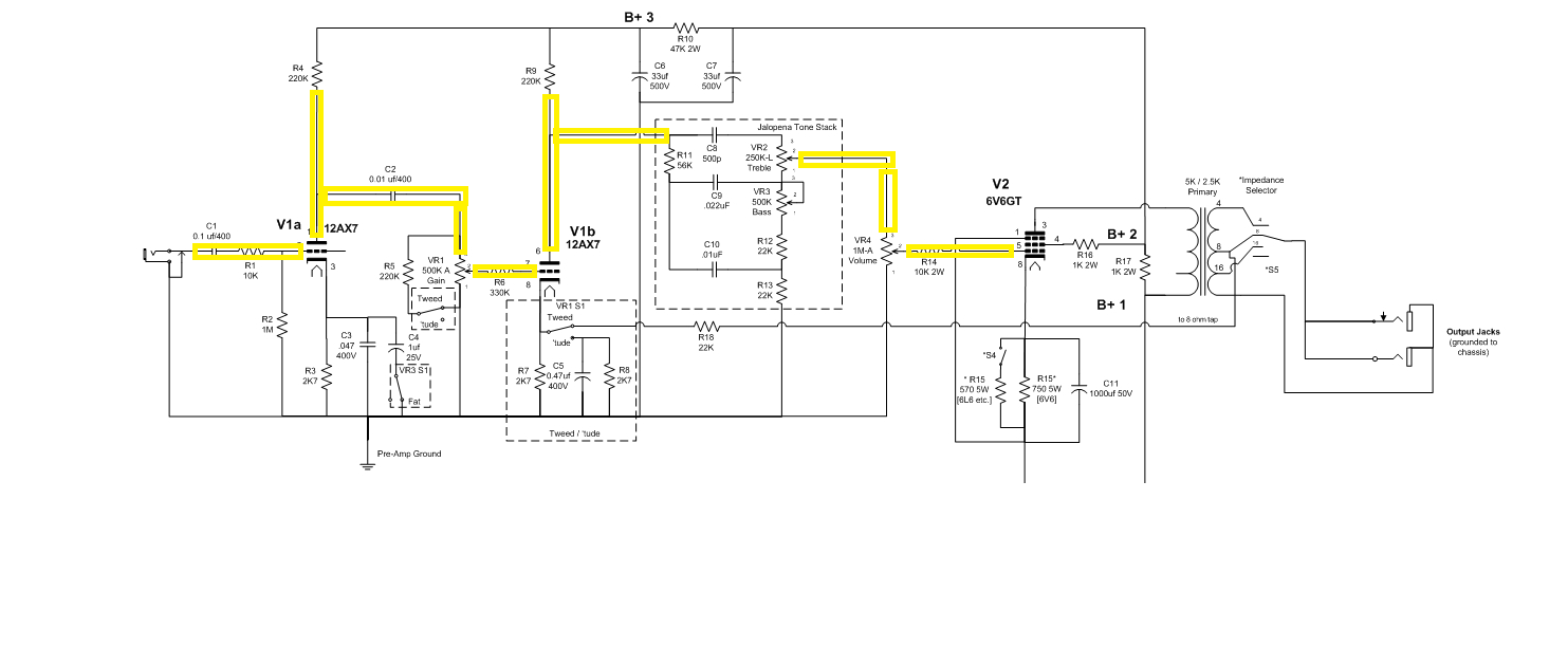

PostPosted: Sun Mar 06, 2011 10:31 pm
Nice! Sounds like your there, just about!
This may not be totally helpful now but here are all the areas you should have signal
Your voltages can be +/- 10% of what is listed on the layout/schematic so don't worry too much about that kinda stuff.

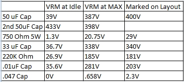

The voltage at the top of the 750 ohm, 5W resistor is about 1.3V at idle and goes up to about 20.5V at max.
PostPosted: Mon Mar 07, 2011 9:16 pm
Posts: 67
I did some more checking. Nothing jumps out at me.
I re-soldered a couple of connections - but no change.
I measured these voltages at the pints indicated by the layout.
(I tried to relate them to the schematic and didn't get passed B+)
I have some monster-sized pics uploading to photobucket right now.
I'll post a link when they're up.
edit: here's the link
http://s135.photobucket.com/albums/q138 ... 11/AmpFix/
I have more, but I'm done for the night.
