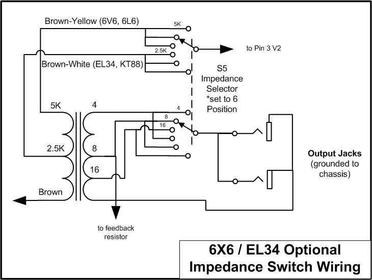

All that aside here is how you wire your rotary switch to use any tube!
The rotary switch is normally 3 positions. I show here how to set it up for six positions, so make sure you set the switch for 6 positions first.
The positions are as follows
1. 4R @ 5K (furthest CCW)
2. 8R @ 5K
3. 16R @ 5K
4. 4R @ 2.5K
5. 8R @ 2.5K
6. 16R @ 2.5K (furthest CW)
So say you have an 8R cab and want to run a 6L6. Set your bias switch for 6L6 and the impedance selector at position 2.
Now you want to run your 8R cab with a EL34. Set the bias switch for a 6L6 but set the impedance selector at position 5 now.
Now if you want to go stock and run a 6V6 with your 8R cab. Set the bias switch for 6V6 and the impedance selector at position 2.
Very simple! You can even try running tubes at different impedances just to see what it sounds like too. You'll get some variation in tones.
Here's how you wire your rotary switch.
(note set the switch for six positions first!!!)
I have a little hand drawn schem of the switching, it's a bit messy but if anyone would like to see it I can redraw and post.

Good details. I have a schematic I will post.
PostPosted: Fri May 20, 2011 11:46 am
Posts: 264
Location: Thompson, Mb
Simple effective and about to become part of my Tramp head and eventually will find its way into the Combo.

There appears to be an error in the Tramp switch schematic. The schematic shows both EL34 & 6L6 using the 2.5K switch setting. Shouldn't the 6L6 (and 6V6) use the 5K switch settings (Positions 1, 2, & 3) and the EL34 use the 2.5K switch settings (Positions 4, 5, & 6)?
Experience has it correct in the text explanation for the 3 different tubes but the schematic seems to contradict the text for the 6L6. Am I reading things right or does the switch schematic need to be changed?
Thanks - Tom

Yes, thanks. A typo. Correcteded schematic posted.

I am doing my build now. I understand the 6 position rotary switch and how it is wired, but I have one question about the toggle switch that normally selects the 6v6 or 6L6. In your photo (above) you only show the (yellow) wire going from bridging the top of the toggle 6v6/6L6 switch over to pin 8 on the tube; you do not show the other two wires going to this 6V6/6L6 toggle from the 750 5w and 560 5w resisters. Before I do something wrong, I have to ask:
Are these other two wires going from the 750 and 560 resisters to the toggle wired just the same as in the normal Tramp schematic?
PostPosted: Sat Nov 17, 2012 1:13 am
Yes they are wired the same
When I took that photo the amp was not done and those two wires were not in place yet.
