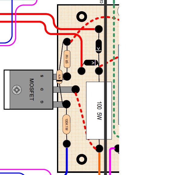

zener. Hard to tell negative end.??does it go between mosfet resisters? Hard to see in pic's.
 Post subject: Re: zener
PostPosted: Fri Mar 04, 2011 4:53 pm
Check the layout. There is a band at the cathode of the zener, it points 'towards' the MOSFET.

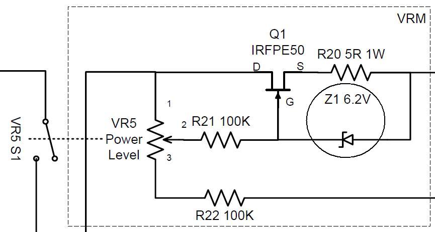

Or to explain a little further, the cathode (stripe end) is the one shown on the schematic as a crooked bar. HTH
PostPosted: Fri Mar 04, 2011 5:35 pm
..which would be this...
