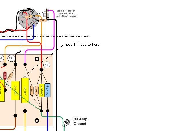

Notice: Some layouts had 1M Grid Stopper (R1) resistor connected to the DC Blocking cap, C1, on the control side. It should be connected to C1 on the Tubes side. The layout and schematics have been updated and posted.
Symptoms:
Some owners have had behavior being described as an intermittent lack of performance. This is [probably] due to this mis-arrangement.
If you turned off the amp when it wasn't behaving, and it worked a day or so later, this could also be a symptom.
In some cases, the amp may not work on start-up even though all else is fine.
Solution:
The easy solution if you built your amp this way, is to clip the 1M off at C1, run a wire from the other side of C1 to the 1M. Or just replace the 1M (email for new part a 1M, 1/2W carbon film/metal film will work fine.).
Explanation:
One purpose of the 1M Grid Stopper is to prevent the grid from 'floating' electrically as it will be referenced to ground. With the capacitor ahead of it, this grounding not as effective and can cause the grid to float causing the issue.

Stephen and I have reviewed previous revisions of the schematics and layouts and it's something of a mystery how that 1M resistor got moved from the correct position where it used to be, to the wrong position shown on the recent revision of the layout. The correction shown here simply puts the resistor where it was before.

Hi Stephen,
This little change has made a significant improvement for the better with how the VRM operates. Before, it was fine at full tilt, however when backed off the volume dropped considerably and the tone was unpleasantly fuzzy.
Now it's superb and works the way it should. Thanks again.

Checked tonight & I had to move this as well. I hadn't really noticed a big problem (I also hadn't played it much, only a little testing) but it does seem better now. :)
I did a jumper wire - too close to clip it, but I de-soldered it from the board & had just enough to make a nice loop on the end of it.

Well, I didn't have any sputtering but it seemed to get a bit louder after the fix. (In my wholly unscientific opinion! :D ) The VRM was behaving a little better as well - to be honest I hadn't done a lot of subjective testing, only basic functionality, and the amp was working pretty good to begin with.

I had not been having any issues with the amp but I decided to change the resistor location as rcommended. If I noticed any differences they were fairly subtle. When the volume was in "tude" and around 10 (where I like it) the sound was less "pinched" if that makes sense. Perhaps it had a little less grind and sounded more open. With respect to the VRM it seemed to work fine before although I have to admit I was only using it in the 9-11 range. I find that backing it off just slightly puts a nice little "brown" edge to the overdrive. I also dimed it for the first time. With the combination of tubes and speaker that I have chosen it flat out roars. I can easily gig with it.

Mine also got a bit louder after the change. VRM functionality was also improved at lower settings. I would say the VRM almost became more consistent/repeatable.
